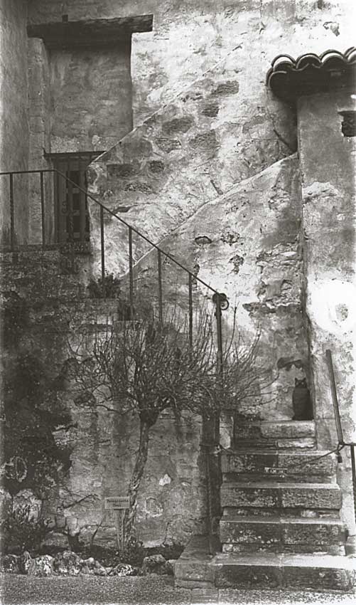

This is a carbon transfer print. I poured the glop onto Yupo and transferred the image to fixed out 8x10 RC paper.
Carmel CA
Canon EOS-1
Tri-X, D-76

I love this Dan. Great feel with the intersecting lines and the roughcast construction.
Classic composition of the stairs, like to see the print got to be real good.This is a digi neg for 35mm neg,Dan ?
Thanks for the comments. I really appreciate them.
As is often the case, the print is better than the scan. It has more snap to it than I am seeing on my screen. The print also has a bit of the 3D depth that Carbon Transfer prints can exhibit.
Mike, I made a negative enlargement from 35mm to 8x10 x-ray duplicating film. One stop shopping - negative to negative.
Dan
Thats great ,Iv,e been thinking of trying that,have so many 120 negs,thanks for explaining.
Looks great, love the texture and tone of the walls. Paul
