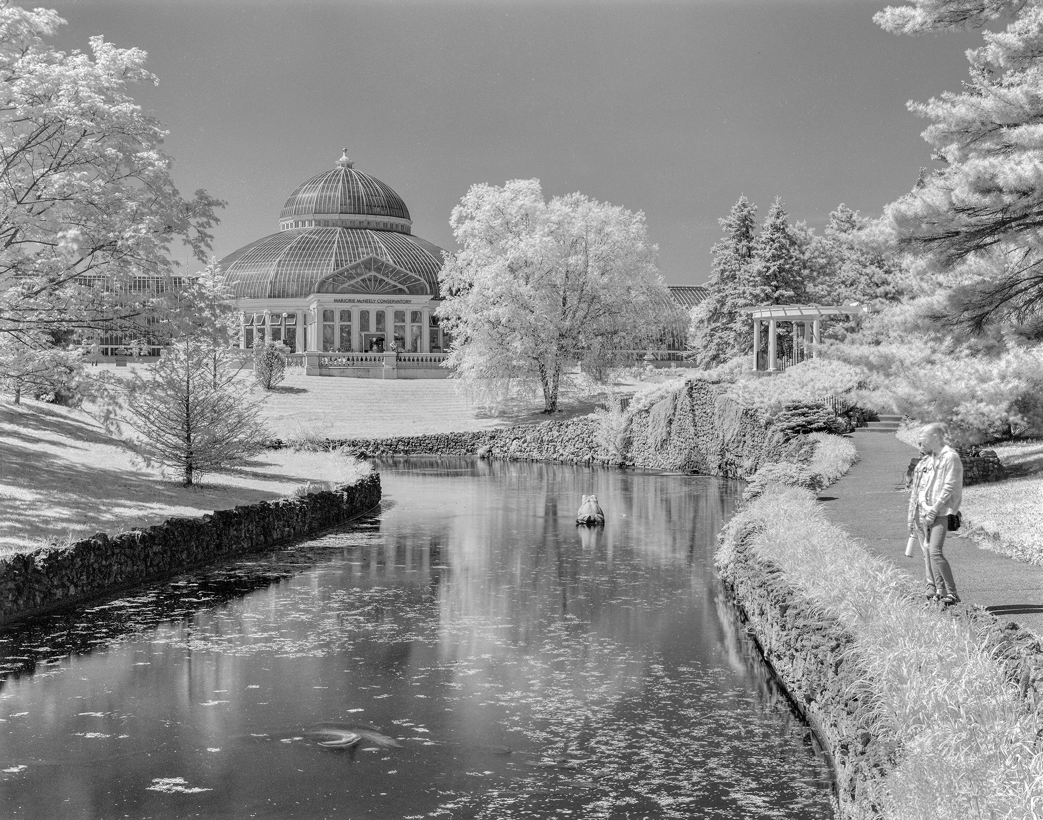

Como Park Conservatory with 4x5 Rollei Infrared film. The large lump in the reflecting pool is a concrete frog facing the building. The boomerang-shaped blur in the center foreground is a duck.
St. Paul, Minnesota, USA
4x5 Calumet with 180mm Symmar lens
4 seconds at f/22
Rollei Infrared in Kodak D-76
Kodak Wratten 88A infrared filter
Scanned and cleaned up in Photoshop

Nice! I am trying to fine-down my infrared process, to get images like this. It was obliging of the people, on the right to hold still, for four seconds. :smile:
Thanks. I'm still fine-tuning the exposure as well. 3 stops down from ISO 3 is about right for the 88A filter. I more stop of exposure blocks up the highlights.
Do you do a reciprocity adjustment in exposure?
I've only done sunlight exposures and have hit on 4 sec at f/22 so I don't know if it's reciprocity-adjusted of not. I just did a 30 sec and 1 minute bracket on a cloudy day, so I'll find out if my metered exposure needs adjustment.
