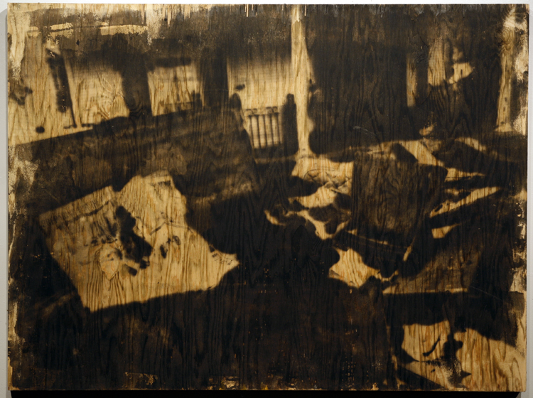

I posted this elsewhere but i think it fits the experimental gallery a it better. Please let me know what you think.
36"x 46" Liquid Emulsion On Plywood
Maco Black Magic
The image is intended to be abstract but is of the front of a flooded and gutted house in New Orleans a year after Hurricane Katrina.
tech-pan/ d-76
coated plywood/ dektol
Great effect. Did you apply the emulsion on dry unfinished plywood or was it sealed/varnished first?

dry unfinished plywood so the emulsion could be absorbed by the wood... I actually never sealed or varnished it and it looks fine. the key was to build the frame first
Wonderful inspiration.... going to by a hole plate of plywood 240x122 cm .... have it cut in smaller pieces .... use my foma liquid emulsion .... thanks...
ANd the picture is just inspiring
Hi Friends, I am very glad to hear that many of you are inspired to try this process. Feel free to contact me via my website if you have technical questions. I must say that this is a labor intensive and difficult process, but extremely fun! Good Luck. I look forward to seeing the results.
