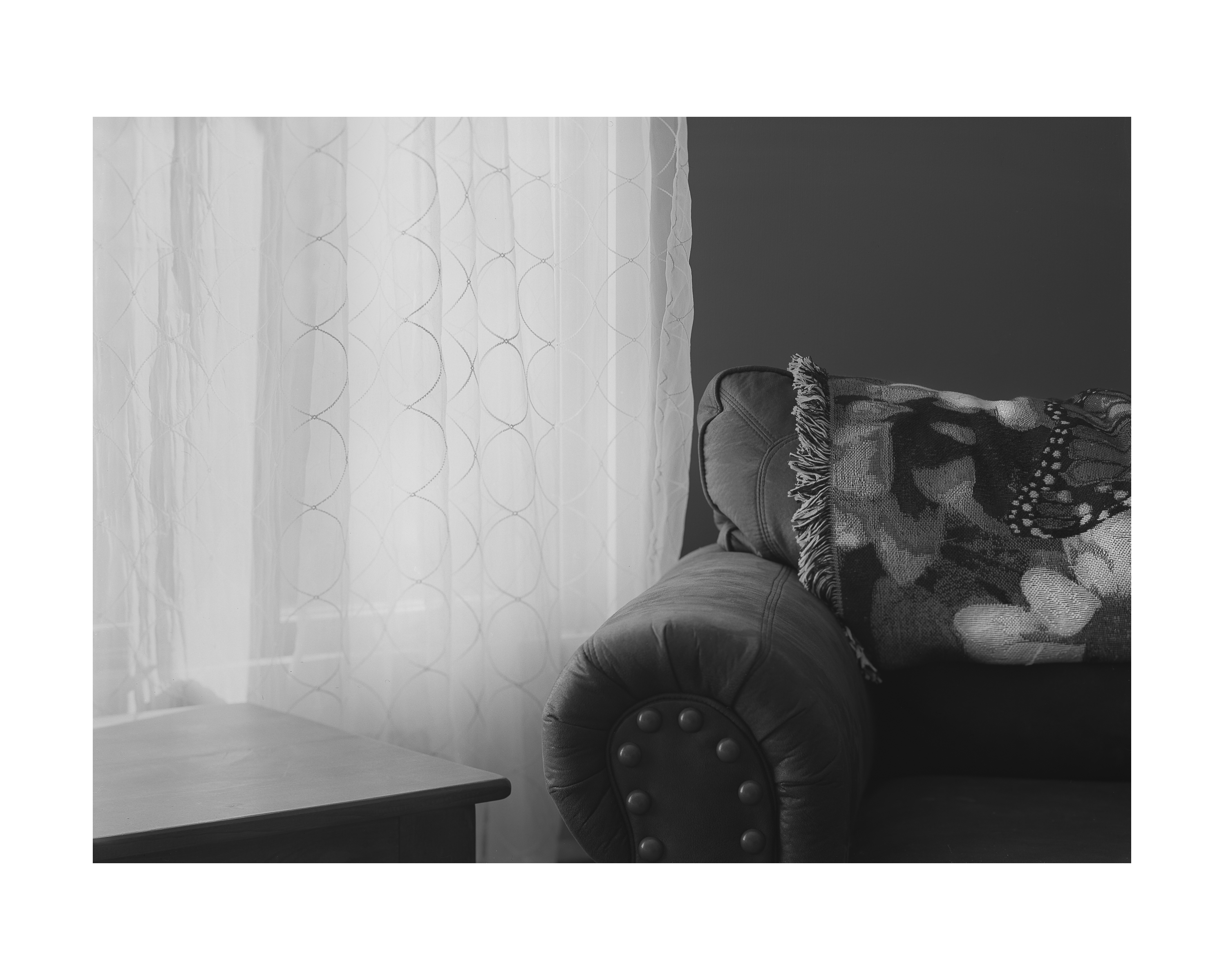

This is a test photo following a family of curves I generated after stepping into the arena of mixing my own developer. I chose to mix the BTTB formula for trying to tame high contrast scenes such as this in my living room. I think it's not bad.
KB Canham 4x5 with a Schneider 210mm APO Symmar lens
5 sec at f/11
TMX @ EI32 developed for 4.5 min each bath, but different agitation schemes; Barry Thornton Two Bath, using 7g of sodium metaborate in bath B.
negative scan for now
Epson V700; contrast and sharpening in LrC
