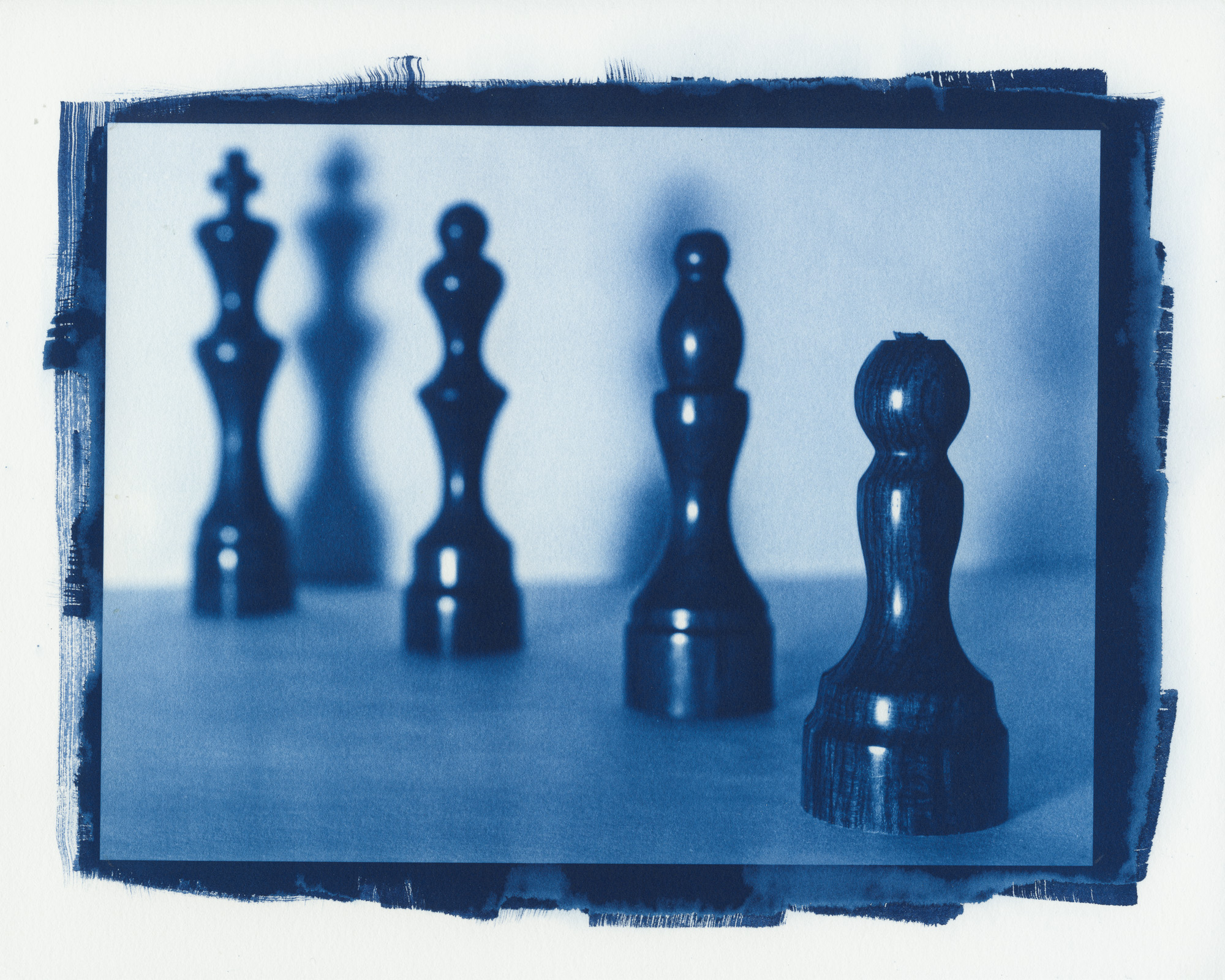

Once I started working in terms of actual concentrations, and did a proper film base test strip, things fell mostly into place a lot quicker than I expected. This print isn't perfect, but it's definitely the best I've gotten. Dmax is good, shadow separation is about 99% as good as my kallitypes from the same negative. For the first time, I had highlight staining from pigment washing off during the first clearing/rinsing bath (visible along the top and right edges). This suggests I may not be getting the sensitizer into the paper fibers as effectively as I want to. Makes sense; Mike Ware's recommended 0.1% to 0.5% Tween 20 content is less than I was using for any of my earlier tests (which had no highlight staining).
Interestingly, this is a 10.5 minute exposure. The same negative gives an ideal kallitype in 4 minutes of exposure. Documentation for new cyanotype says in an "average UV exposure unit," exposures should be between 2 and 4 minutes. I guess that's kind of a meaningless metric, other than mine appears to put out less light than Mike Ware considers "average" :D My test strips gave noticeable increases in dmax with every extra minute of exposure up until I hit about 10-12 minutes.
So a bit of fine-tuning to do on Tween 20 concentration, and perhaps ever so slight changes in citric acid concentration. But I'm quite happy with how this came out, and ready to do some more printing! FWIW, the magic numbers for me so far are 0.032ml of total liquid per square inch of image area, with ~0.5% Tween 20 concentration (achieved by adding drops of 20% Tween 20 to the sensitizer immediately prior to application), ~2% citric acid concentration (achieved by adding drops of 10% citric acid to the sensitizer immediately prior to application), and the balance actual sensitizer, and I suppose also distilled water from the non-sensitizer solutions being mixed in. I calculate the ml amounts exactly, and then convert to whole number "drops" assuming 1 drop = 0.05ml. I also never let the Tween 20 fall to zero drops, even if smaller print sizes suggest something like 0.27 drops. It seems critical for my success with this process to have enough Tween, and the effects of too much Tween (within reason) don't seem to be anything noticeable.
For this print, that ended up being 23 drops of sensitizer, 6 drops of 10% citric acid, and 1 drop of 20% Tween 20. I expect doubling the Tween would probably prevent highlight staining.
That is a nice print. This is not how I would have approached it (that's why I don't have a print to share....🙂) but I am glad it all worked out in the end. Tween can be a two-edged sword - too much of it and the sensitizer goes too far down the paper and you lose the Dmax as a result.
:Niranjan.
Yeah, I’m guessing there’s a sweet spot in there somewhere, but honestly even when I have clearly not added quite enough, I’m pretty happy with this dmax. So I will probably just creep up on the right amount to stop the highlight staining and call it good there.
