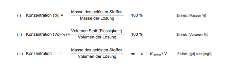

Ron, the problem here is that the definitions/designations are utmost confusing....
see here:
We thus got 3 different kinds of concentrations.
Then there is the term "Mass-Concentration". Guess to what equation the average person would relate that term term to? Likely equation (i).
However it is equation (iii) ...
To make it even worse: I just got a german textbook in hand "Calculations in Chemistry". It got 9 pages on concntrations alone, but does not even contain equation (i) ! But lists only (ii) and (iii).
