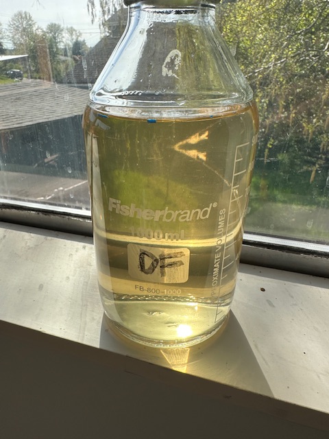

I pulled the can with the most rust on it and mixed it up today. Some discolored crystals, no clumps.
Here’s a pic of the resulting “soup.”
My only exposed rolls right now are Tmax and 1 roll of fomapan 100.
I may try the fomapan in the Acu-1 unless someone thinks that’s a bad idea.

It's been 49 years since I last used that, but I don't recall it being that color, although what I'm seeing isn't outrightly bad.But remember, it was a speed "pushing" developer. Plus X to 320, Trix X to 1200 as I recall and so on. But since they don't make those 2 films like they did then, then it's anybody's guess. Don't use it on those 2 and they will be ruined. You'll have to expose another roll to do that. Try Fomapan 100 at 160 and 200 and 250 and see what you get. As for developing times, check the massive developer chart, but I doubt it's in there. So all you CAN do is treat it like it's Plus X. But remember, Kodak rated their films honestly, with fill speed developers Like D-76, DK-50, DK-60a and the like. I think Foma fudges high on their speed ratings.

I had previously dug up some developing info for the stuff.
I'm guessing this is a "clear" solution if the crystals are brand new. I may go and expose a roll specifically for it. My main goal was to have some more data if I decide to throw it at the classifieds section.
