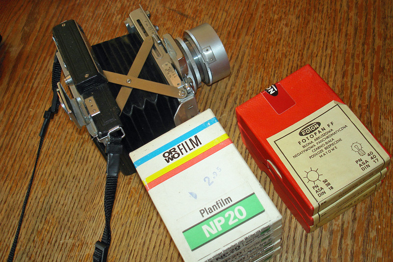

I have hundreds of sheets of 6x9cm Orwo NP22 and some NP15, and I'm going to try ADOX Borax MQ with that stuff.
But since it's very old film, I wonder if I should use Microphen? The guy in Bulgaria suggested Microphen.
I also have 75 sheets of 6x9cm Fotopan FF ISO 50 (from Poland) new in the box. That will be interesting to use.

I took another look in my freezer, and it is all Orwo NP20, and a few boxes of NP15.
I have Orwo NP20 in 6.5x9cm and 9x12cm.
NP22 is the newer version of NP20, correct?
I never buy faster films that are outdated. I misspoke on the NP27. Don't have any.
It is very difficult to buy any sheet films at all that will fit my Plaubel Makinas, and Makiflexes.
I figure this Orwo film is OK but you never know with old film. I got it fairly cheaply and I'm willing to take the chance.
The only other 6.5x9cm films I have found, are Ilford FP4+ (from UK) and Foma 200 (from Bulgaria). These are of course excellent films. But it is also good to also have the Orwo NP20 and NP15. :smile:
Have you ever used Fotopan FF (from Poland)?
I have seventy five sheets in 6.5x9cm (ISO 50)

Yes, NP-22 replaced NP-20 in 35 and 120 formats. Change from 80asa to 125asa. I have to check my contact sheets for when switch happen. Mid 80's?? Not sure for plan/cut film. My biggest regret for ORWO is "discovering" NP-15 to late. Shot at 12asa in 120 and processed in HC110/H. I was using it mainly for studio still lifes etc. Thing of beauty!
Beside some paper never had chance to try Polish Foton material. Eastern European photo material factories also collaborated and repackaged each other products. I remember some very nice SSSR fiber graded paper made with Bulgarian-FOHAR (iirc) emulsion. It had ton of silver in it.
Most likely main use of 6x9 cut film was for ID pictures in the studios. Everybody else used roll film.
