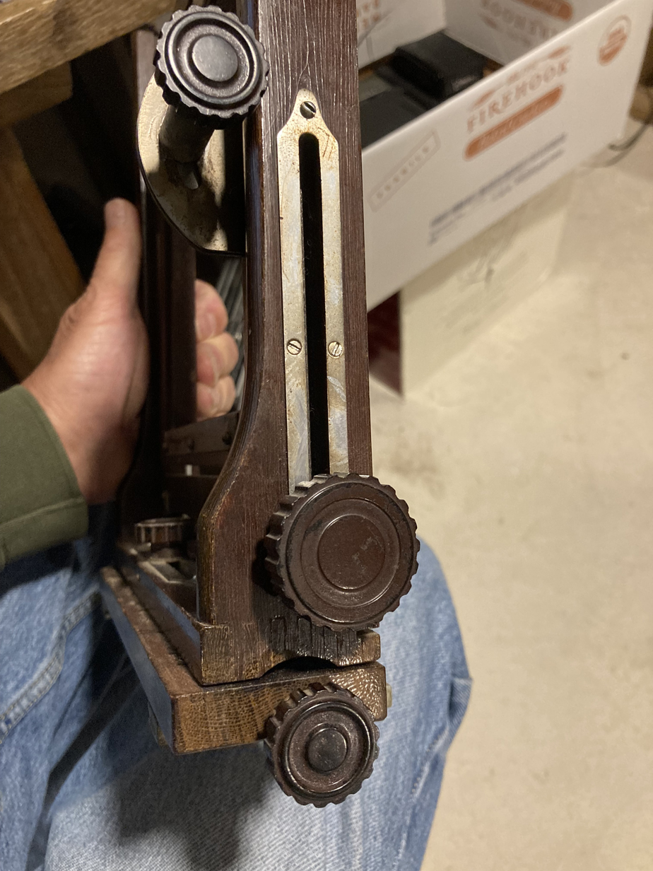

Ian...do you still have your commercial model? I picked up one but the front standard looks like it was from a different camera or at least the wood finish is different.

Yes I still have my Commercial View, it's sat on a tripod about 10ft from me. Lt me see some photos. I have two other 10x8 Agfa Ansco cameras both Universal Views, but none are quite identical.

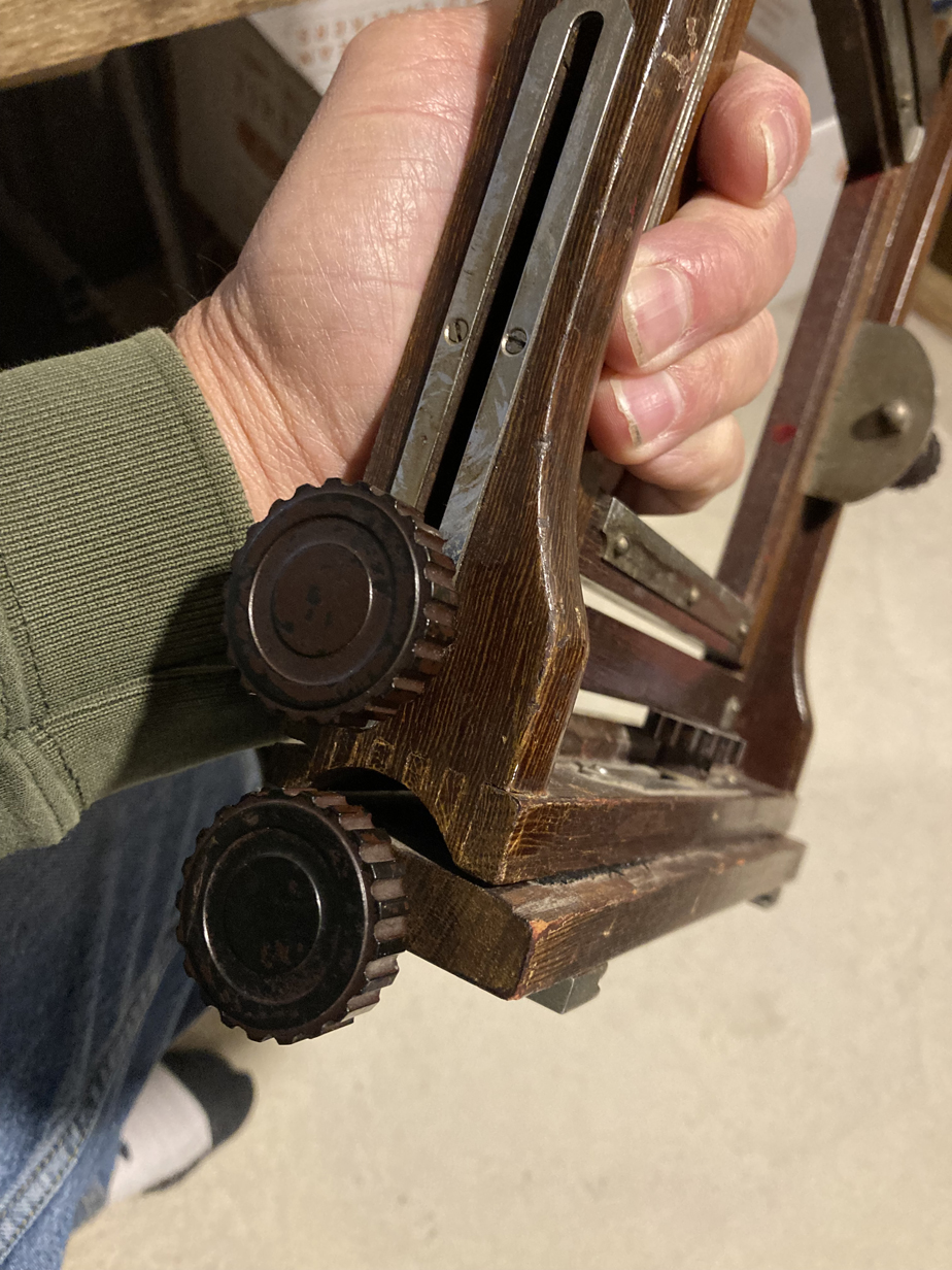

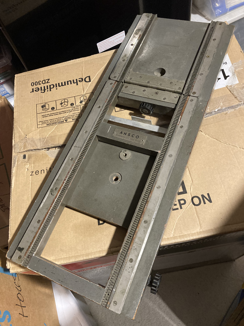

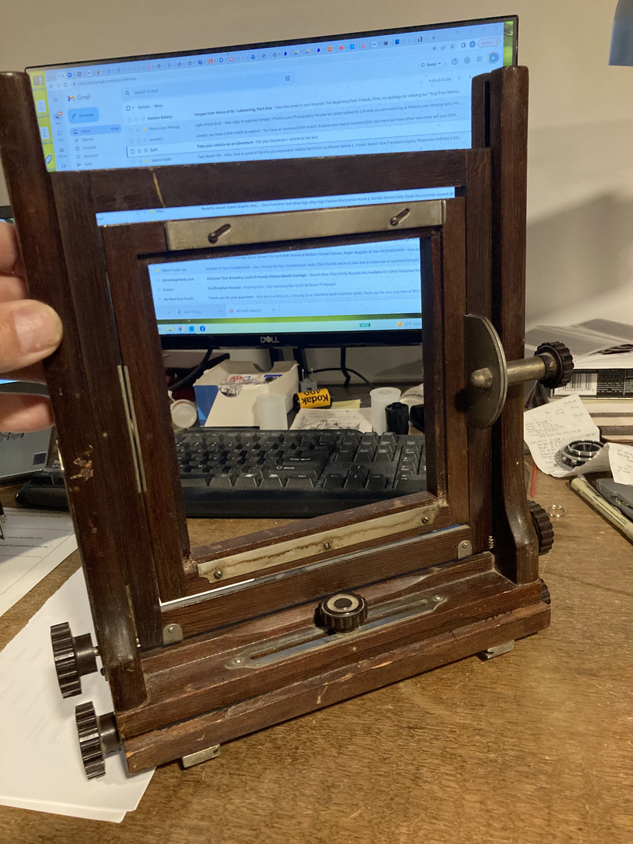

Ok, herre are some photos of the main components. You can see the difference in wood finishes but the front standard works perfectly...it does move back and forth the way the com
mercial unit works.

Looks like someone stripped off the grey paint and re-finished it. It's not an Agfa Ansco front standard, it's the later Ansco type made after the US government took over the company, they were only sold in grey paint finish, and had Bakelite thumb wheels etc. Changes were made to the cameras when camera production stopped in the Agfa Ansco, Bingham, factory which was turned over to making military optical equipment, until after WWII.
There's a couple of slight variations of the front standard of these late Ansco cameras. yours is the earlier version. The Canadian photographer used one, and it was refinished in white paint. Richard Taylor a member here has restored on and refinished it white with blue bellows, see here. Then here's his other one, note the uprights of the front standard have lost their more elegant shape.
