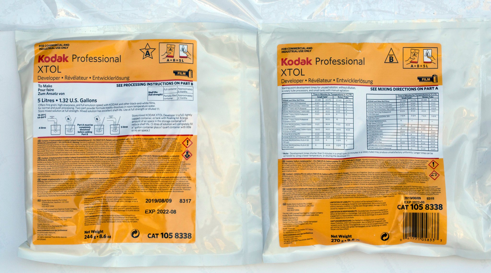

The announcement seems to state a specific day/month/year. Do we take it that the problem only exists with any A+B packets produced on that day and no other day?
Has Kodak now added a specific day/month/year of manufacture to ts packets and if so where is this found? I have older packets which still have the name Kodak Professional XTOL as written on the packets in the link but not all in block capitals as in the announcement A bit confusing to state the name in block capitals but then show packets with what I assume to be the existing real font with only XTOL in block capitals
Thanks
pentaxuser
Oren Grad
Feb 17, 2005
1,619
The company has not posted anything about any other batch. It's up to you to decide whether to assume that other batches are OK until proven faulty, or faulty until proven OK.
Apparently so. Follow the link to the Twitter post and click on the picture to enlarge it - the information is shown very clearly toward the bottom of the front of the packet.
pentaxuser
May 9, 2005
20,246
Daventry, No
Thanks Oren. I have been able to find it now. Let's hope that my inference is correct - that's its one day's production and not that the problem is one of it being that here are some bad packets with that date and it may extend to other as yet unknown dates

I received a package this week from B&H. It's from the suspect batch. I stockpiled XTOL when Tetenal got in trouble. The new stuff is still made in Germany, by who?
Here's Kodak's picture, not mine.
mshchem
Nov 26, 2007
15,653
Iowa City, Iowa USA
My pouch of the part A feels like as someone on the rangefinder forum states "like cookie dough" . The part B bag has free flowing powder the A bag has mushed up clumps. I held it up to light, it doesn't look like any XTOL I've ever seen. It's made some place in Germany.
I wonder if ........ no never mind.
It may be an attempt to minimize the dust, which is obnoxious on the old Tetenal product.
This sucks.

For what it's worth, I bought a package of XTOL from Adorama 3 weeks ago and mixed it up into stock solution, and it's been fine. I threw away the packaging, but I'm 99% sure it's the 'new' stuff. Adorama's product description said it was, and Adorama was out-of-stock on XTOL for 2-3+ months while the manufacturing changeover was happening, so it seems impossible that I could have somehow ended up with a package of the old stuff.
I've developed 6 or 7 rolls of 120 film in it over the past 3 weeks — Tri-X, TMAX 400, and HP5+ — at a 1+1 dilution and all developed normally, i.e. as I expected based on using XTOL for a couple of years. Again, I don't have the packaging anymore, so I don't know if it was the same batch that's noted in Kodak's tweet. I still have about 3 liters of stock solution left; as of a week ago it was working at full strength.
Also FWIW, during the period that XTOL was unavailable, I bought a package of the Eco Pro LegacyPro Ascorbic Acid developer and used it with 3-4 rolls of film over about a month. It worked just fine, and exactly like XTOL as far as I can tell (I didn't do any meticulous tests of it; just developed some film and got the results I expected.)

I think Kodak Alaris is doing the best they can trying to get ahead of this. This isn't a Eastman Kodak problem like occurred with the 120 backing paper. New supplier, new mixing equipment, something probably malfunctioned and didn't add correct quantities. I have one bag of the new stuff, I want to help KA resolve this.

I have long been a supporter of Xtol from the beginning way back in 1996 and I've been through all the mess with the two different types of Xtol Sudden Death and this early report of "cookie dough" texture to Part A is consistent with the original packaging failure. To recap, the original formulation was in two foil lined packages with Part A in a smaller (much smaller) package and the Part B much larger, in both soon to be discontinued 1 liter size and the 5 liter size. The edge seal of the smaller Part A package wasn't up to shielding from moisture, and being based in Hawaii with only boat shipments of chemicals by Kodak (pre-digital reorganization) made this issue quite apparent. The face to face conversation with the area Kodak representative revealed that they also had the same issue with another product, Kodak Sepia Toner in the smaller size, from the boat travel. I can recall standing in the shop (Larry's Super Save on Young Street for those of you who remember) with the rep and opening up a sealed box of 1 liter Xtol and all of the Part A's in the box were as hard as candy, not a free powder. He took all of the store's stock back. Within a few months Kodak had changed the packaging dropping the 1 liter size and then both Part A and B of the 5 liter size were adjusted to be nearly the same volume of powder. I was explained to me from the rep that the Part A volume was increased by splitting up the total volume of Sodium Sulfite in to equal amounts into the Part A and Part B, as well as the improvements in the packaging. Xtol was stable in this form except for the iron sensitivity (Fenton reaction).
Xtol was the combined effort led by two highly educated and trained top Kodak research scientists using the full capacity of the greatest photo-chemistry research laboratory ever with the resources and budget of Kodak at its most profitable with the expressed goal of not only eliminating Hydroquinone from the developer due to soon to be increasing environmental regulations but to improve the capacity and extend the useful life of Xtol in a replenished lab system. When the Xtol project was initiated Kodak was under a huge pressure internally and externally to improve their environmental impact. Commercial black and white labs which were an industry standard used either D-76 or Microdol-X as a replenished system, and Kodak recommendations were to dump the full amount from the tanks after 6-12 months. Xtol changed that, offering better image quality with a single solution (no more separate Replenisher formulas of a developer) and if monitored properly, an extended life span of the replenished batch. A really great product but by the time it made it to market ( it took over 10 years to formulate and test) the market conditions had changed and Kodak cut corners on the packaging (sound familiar?).
I knew of photographers in my area who tried Xtol when it first came out, had the failure of the 1 liter size and never ever used it again, sticking with D-76 or others which totally negated all the effort put in to Xtol. I guess the current executives of what we could call now "Kodak" are too young to recall the errors made. These new reports of yet another manufacturer for "Kodak" chemicals having the same packaging issues do nothing to help the already tarnished reputation of Xtol, despite what I still feel is a superior and wonderful developer.
I will seek out a couple of the new packages of Xtol from a few sources and test and will be quite vocal about any issues on this forum and to Kodak and I hope others will as well.
