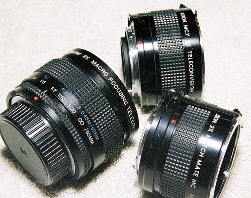

The Vivitar "macro-focusing" teleconverter, is a high quality 7 element one. As is the Kiron MC-7 model.
