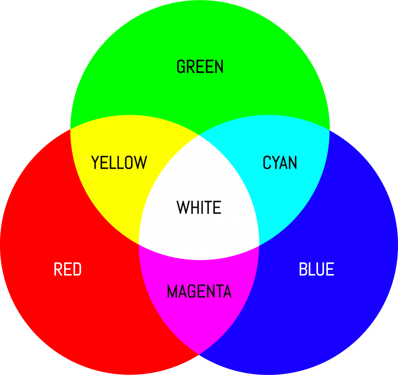

Hello,
I am still quite new to darkroom color printing and with a lot of trial and error, I manage to get a "for me" good enough print. As I am reading up on the color printing theory I do have some questions which I like to ask you (all my film friends are b/w printers). Let's say my print is way too blue then I would add more blue to compensate.
a/ Now blue doesn't exist on my durst color head so we need to add a mixture of cyan and magenta to get less blue in the print, right?.
b/ Looking at the color wheel, can the same be accomplish by substracting yellow ?
c/ If so is there a general ratio between yellow and magenta/cyan? Say substracting 10Y = 5M/5C??
d/ Any good color printing book to get myself for Christmas?

There are two most different approaches to using light filter (be it optical filters or dyes in printng):
-) additive colour forming
White light of three sources is filtererd to form either
blue
gree
red
light.
These part then are added partially or in their whole to form any hue of light or white light
-) substractive colour forming
white light of one source is reduced
partially or in its whole
by
magenta
cyan
yellow
filters,
To yield any hue or black.
Thus in one case light of different sources is added. In the other case light of one source is reduced.
AgX
Apr 5, 2007
29,972
Germany
In analog colour photography today nearly always the subtractive approach is used.
Yep, you're doing good.
Regarding your question about equivalency, here's an older post where I worked through a couple examples. It's sort of tedious, but if you want to resolve things in your head it may help. Essentially, though, if you need something like a 10cc filter change, everything stays at a 10cc change.
https://www.photrio.com/forum/threads/filters-colour-absorption-question.52345/#post-765206
Ps, in light of what AgX has said, let me point out that I'm making an assumption that you are using a "subtractive" system, where you have a single light source, into which you insert color filters.

The problem in this thread is that the OP inquires about subtracting colour values.
However the graphic he posted depicts additive colour forming. Thus my post #2 of generic nature.

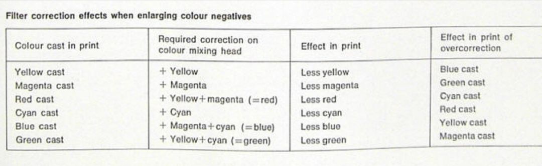

@perkeleellinen tx for the info. I have been given this;
@lantau thank you ..... seems to be corresponding with my image above
@AgX I was just in general wondering if substracting yellow would do the same as adding Magenta+Cyan (as these 2 make blue).

That's very useful - for Cibachrome printing. It's only moderately useful for RA4 printing, as you'd typically not touch the cyan dial when doing so. For RA4, it would be something like:
Yellow cast --> Add yellow
Magenta cast --> Add magenta
Red cast --> Add yellow + magenta
Cyan cast --> Subtract yellow + magenta
Blue cast --> Subtract yellow
Green cast --> Subtract magenta
I'd also refrain (at least at first) from adding/subtracting two colors at the same time (M + Y). It's generally better to develop an intuition/feeling of what a single filter adjustment does. Likewise, I'd recommend (again, at least initially) to not adjust exposure time and filtration at the same time - for the same reason.
When making adjustments for an initial test strip, don't hesitate to make big adjustments - like 10, 15 or even 20 cc. It's generally faster to overshoot your corrections and then work your way to the middle than to inch your way to a correct print. It's also 'safer' in my experience; if you make incremental adjustments (e.g. 4-5 cc at a time), there's a much bigger chance that you'll end up thinking "this looks pretty much OK, let's go with this" while in reality the print might have benefited from some further adjustment. By having more extreme end points at hand you have a broader and more solid foundation to base your choices on.

I use Yellow and Magenta. I first use Magenta and get the exposure correct with that filter. The I repeat that and work on Yellow. That gives what is call split filtering and sometime I find that using Magenta alone will be "good enough" or "great".
GetAttachmentThumbnail
This is from Ilford Multigrade Papers

Oh but that's is what I use for b/w multigrade paper printing .......... that's not the same for color printing?!
Those table are for black & white only.

Very very few people have serious RGB additive enlargers like I do, so this whole thread can realistically be simplified down to CMY subtractive methodology, and apparently in this case to color negative enlarging for sake of RA4 printing on ordinary chromogenic papers. But now this thread has gotten potentially confusing by bringing up all kinds of irrelevant information concerning VC black and white papers, discontinued Cibachrome, etc. He asked about COLOR PRINTING. And undoubtedly being a color NEGATIVE process in mind, the rules are quite simple :
To make a print more yellow, LOWER the yellow setting on the colorhead; for more cyan, lower C on the dial; for more magenta, lower the M setting.
Directly across the color wheel, in artists terms : For more blue, lower both M and C equally; for more red, lower Y and M equally; for more green, lower Y and C equally.
Or to increase anything, rather than lowering it, just do the opposite. After a little practice, this all gets intuitive.
