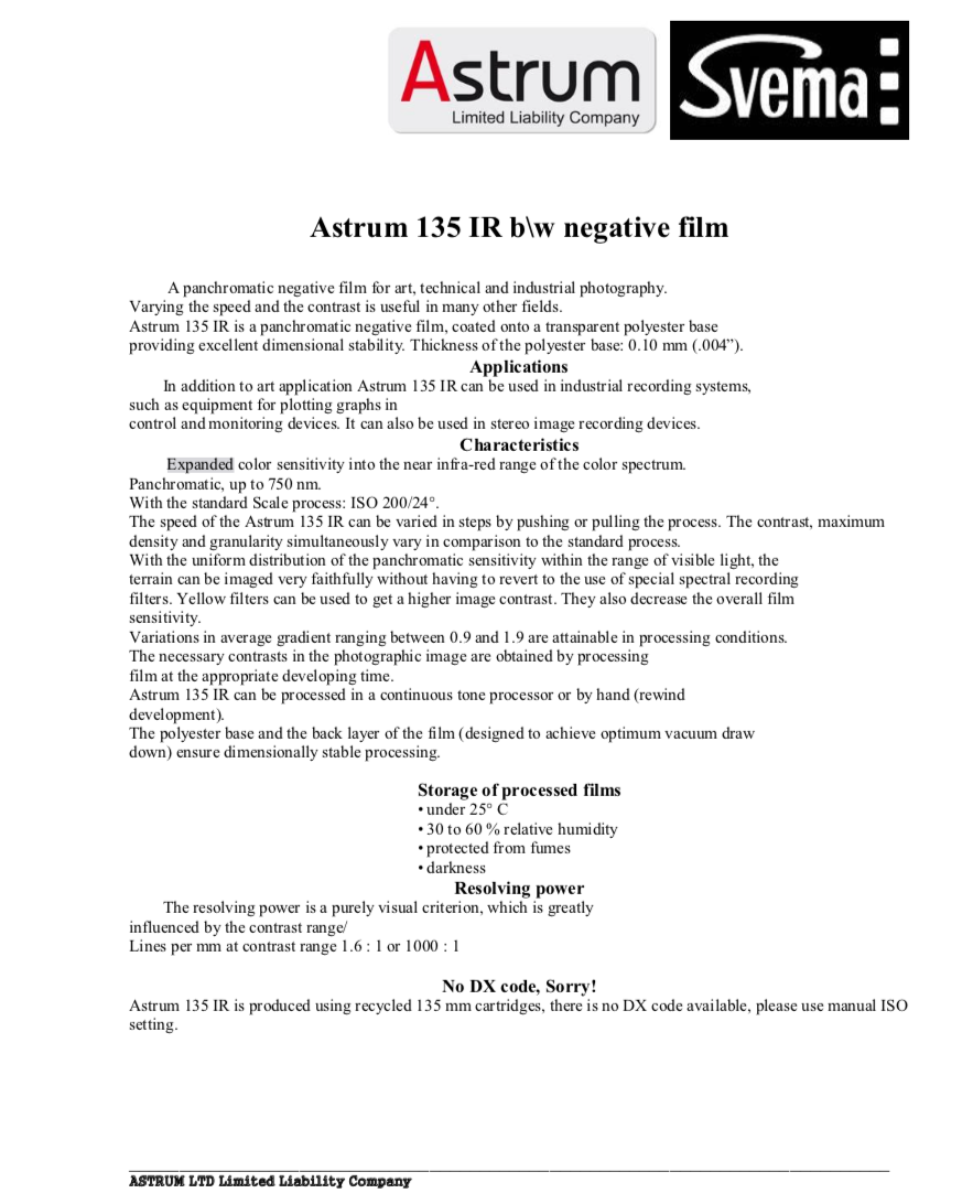

Are any of those aerial films, IR sensitive?
Astrum does have an Infrared film in 35mm format, but I believe you have to ask for it (it doesn't appear on the current price list). I have a spec sheet for this film if you are interested.
I'm interested! Can you post it here? Thank you, Paul.
