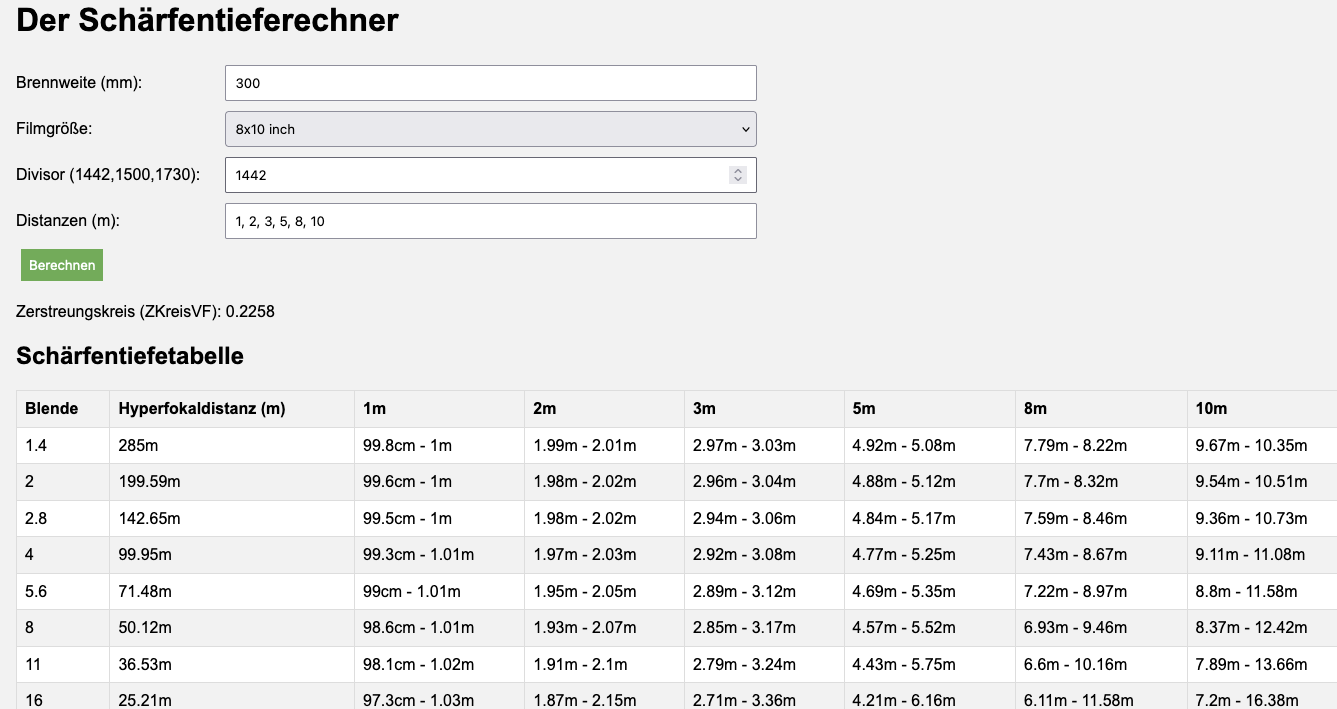

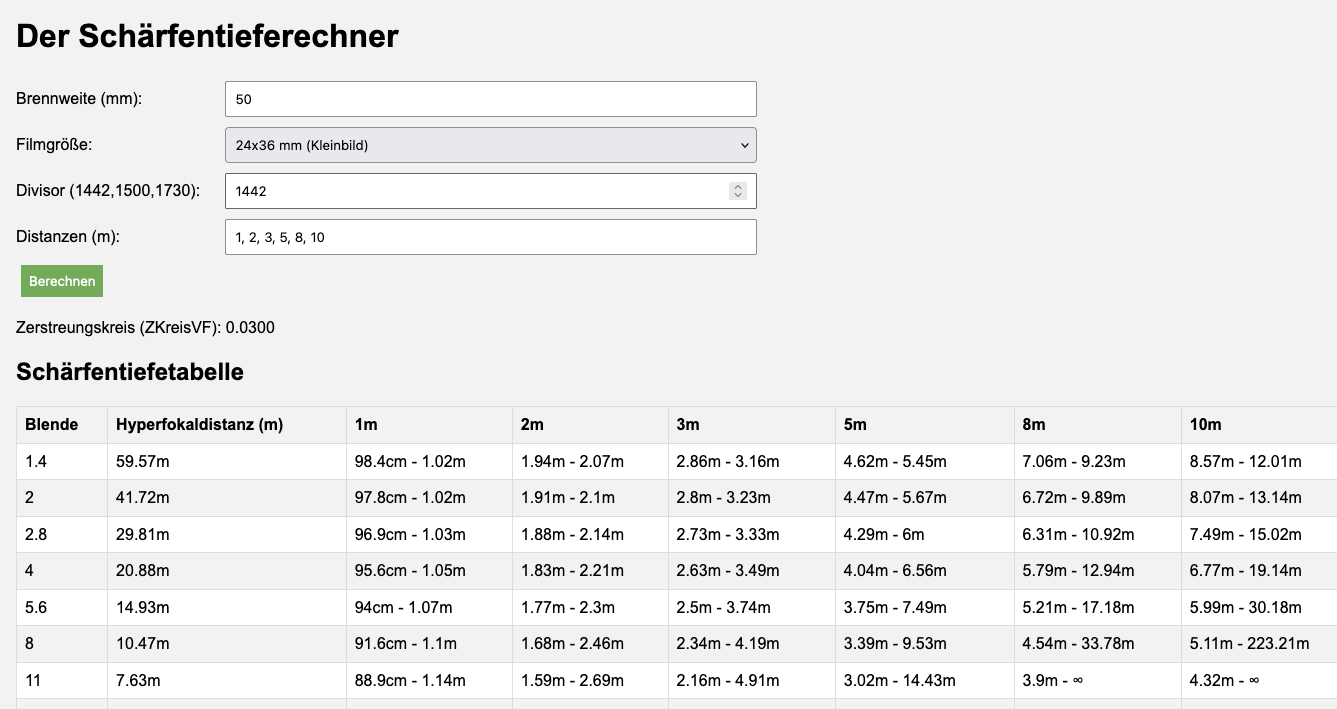

Do you like these DOF Tables on old Film Cameras, here is a website to compute them:
https://dof.tiiny.site/
