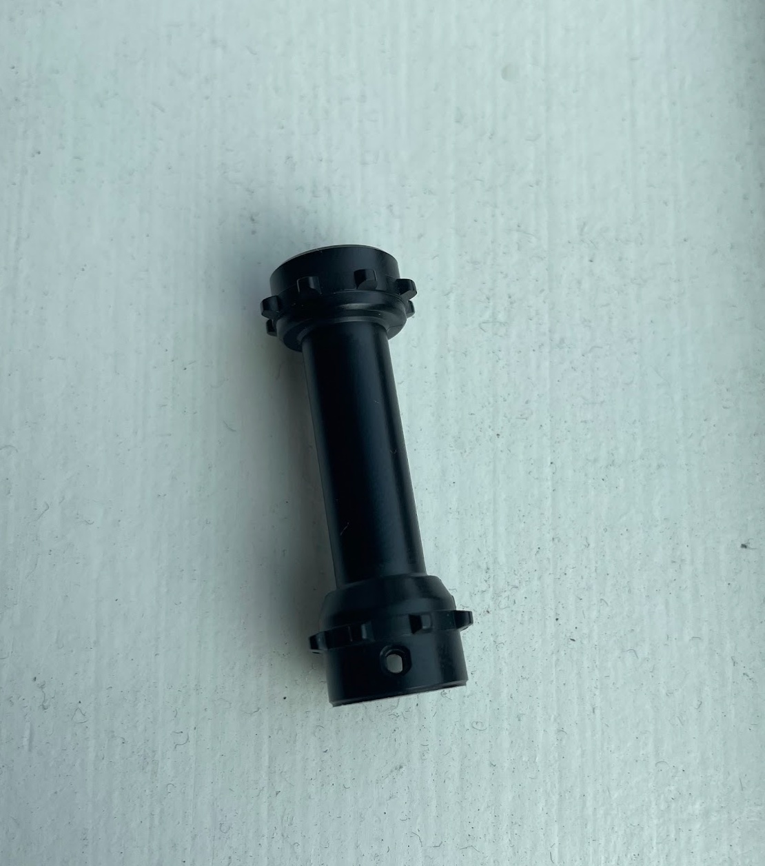

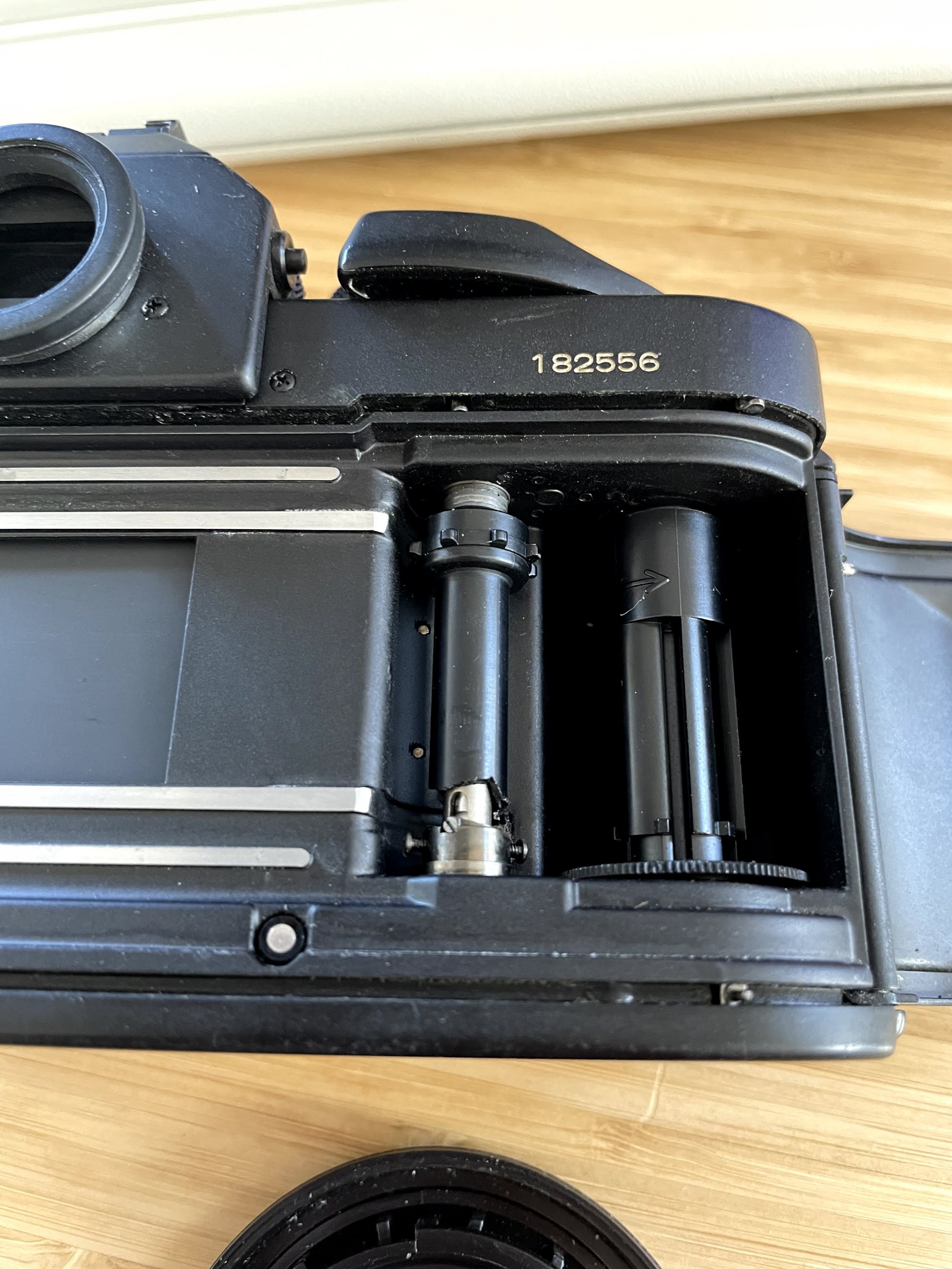

Hi All,
I recently purchased a Canon new F1 from ebay. I took a bit of gamble since the photo was not clear but the price was good. I got the US navy edition which is a pleasant surprise. The camera is in good working condition after a bit cleaning. The only major problem is that the SPROCKET (in plastic is broken). I found a replacement one online and purchased the parts. Anyone had experience or guidance on replacing it? I have done several Nikon F repair in the past. I wonder how troublesome would be this replacement. I thought Canon F-1 is built like a tank, why the plastic parts here :smile:?

Now I wonder how that happened. The fracture seems to be where the axle drives the plastic tube with the sprockets.
Well, I am sure Simon Galley now would raise his hand saying "I know it".

Looks like only one or two teeth are missing and it may still work. Have you tried loading a roll of film?
AgX
Apr 5, 2007
29,990
Germany
The shaft is broken with seemingly all or most of one sprocket wheel missing.
Basically a camera can transport correctly the film with one sprocket wheel. The question though is whether in this case the axle will still drive the plastic shaft.
As the OP ordered new parts I assume not.

Looks like someone really strong tried to rewind a roll of Estar based film without releasing the clutch.
One of the not often referred to advantages of acetate based films.
Rather transporting beyond its end.
That was my hint at Simon Galley referring to.
But PET based films are spread at the consumer market for over 15years. I learned of no report of such damage in that period.
What PET based films armed forces could have used in a new-F1?

Hi All,
This requires a full stripdown. I repair cameas but i don't dare dissasembling my beloved New F-1s. They are far more complex to strip down than most other cameras. The service manual is the longest 35mm SLR service manual i've read!!
Now, the camera should be able to transport film just fine as it is.

Thumbs down to Canon on using plastic here, Nikon F has all these parts in metal and I haven't seen any F with a broken SPROCKET
This part broke probably because some hard object impacted it. If this was a metal part, it would have bent the axle and you would have a non working camera and a very hard repair.
Being a plastic part, it just chips off and doesn't do further damage. And the camera can keep working.

Yes, this is the new-F1, exactly like the one here https://www.cameraquest.com/cf1mil.htm.
I have tried with a dummy roll of film and it will not function smoothly give the bottom gear is completely broken with two screws exposed that caught on the film. I have returned to the ebay seller.
You are spot-on, the sprocket connects to the axle via the two bottom screws and the bottom is completely broken. Now the sprocket and the axle are disconnected and will not move together.

It is built like a tank. Internally it has parts of really high quality materials like mirror-polished gears and high-tech construction techniques like laser welding for added reliablity. Why do you assume "plastic" was a bad choice? It reduces weight, and this part doesn't require a lot of strength.
I agree with you. Looking at the replacement part that I got, it is fairly well made and kind strong. It must have been taken a lot of force to break in the first place.
