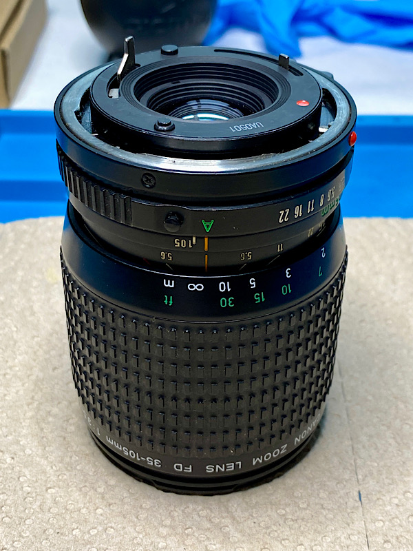

Today I tested the functionality of this nFD 35-105/3.5~4.5 and also looked at the lenses with the LED lamp.
With Canon nFD lenses, the aperture is closed when they are removed from the camera, and the aperture blades remain locked.
This makes testing the lenses with the LED lamp only possible to a limited extent.
The aperture blades also cannot be checked for possible oil contamination, as they have to be moved to do this.

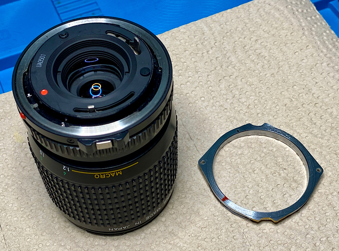

With a self-made „aperture key“ from the bayonet ring of a discontinued Canon T90 (or another Canon with FD bayonet), the aperture can be opened and closed to the preselected value using the aperture lever.
The lens now behaves as if it were attached to the camera, see
Now the nFD lens can be checked without any restrictions.
In this case I only had to clean the rear lens.
A slight lens separation further in will most likely not affect the image, nor will some small damage to the coating of the front lens.
An „aperture key“ can also be made from the rear lens cap of an nFD lens:

Pretty neat. I use a Fotodiox M43-FD lens adapter to do the same thing, but yours is smaller and easier to bring along if you're shopping.
Chris
kl122002
Apr 17, 2022
385
Hong Kong
Analog
I use an extension tube ( not tele converter) instead. It is super cheap in ebay even it is originally made by Canon.
Sometimes the camera stores' junk or bargain box might have it.
tokam
Nov 7, 2008
586
Sydney, Aust
There also use to be reversal ring sets which allow lenses to be mounted in reverse for macro / closeup photography. One ring for the front of the lens which had an FD bayonet mount to match with the camera body and another ring to go on the bayonet end of the lens to simulate mounting the lens and thus unlocking the aperture which had to be set manually for each picture.
Somewhere I have the instructions detailing which pin on the nFD mount to depress which allows the nFD ring to rotate and simulate the lens being mounted to a body.
These days I just use a short extension tube as mentioned by @kl122002 above.
