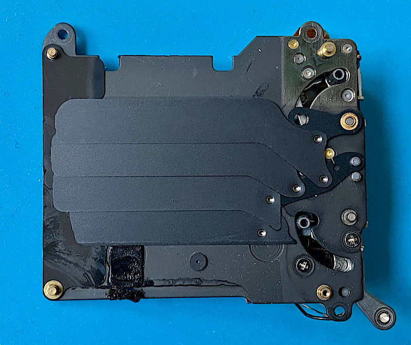

Is it the sticky damper that is causing the problem?
I found some information online that the HELP/EEE problem was associated with stuck shutter blades.
There is a foam damper in the lower part of the shutter, which turns into a sticky mass over the decades and contaminates the shutter blades. This contamination is visible.
If they are very dirty, the blades are blocked and the T90 responds with the two error messages mentioned.
Cleaning the shutter curtains and removing the remains of the damper will remedy the problem:

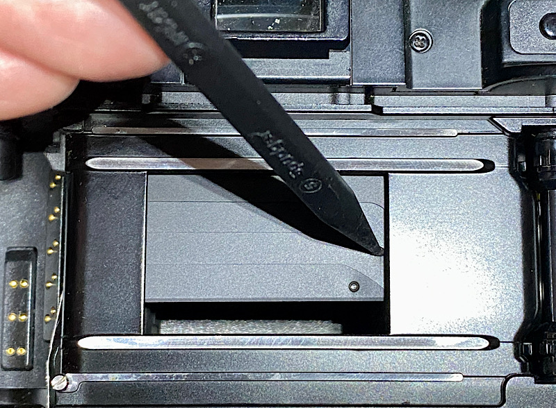

Anyway, I only have two options anyway:
  1. Remove the smaller damper part at the front with the probe, clean the area with Zippo lighter fluid on a strip of blotting paper and then flood the shutter with Zippo to loosen any stickiness.
  2. If that doesn't work, there's still an expedition to the shutter, which is a separate project.

Of course, the damper that I'm removing has a function and it would be better if it stayed in place.
But since this thing has now rotted into a sticky mass in practically all T90s, it has to come out, otherwise the shutter could become blocked.
The only way to fit a replacement is to remove and dismantle the shutter. But then you also have to remove the larger part of the damper, as it decomposes in the same way. I think it's a fantasy to replace it adequately.

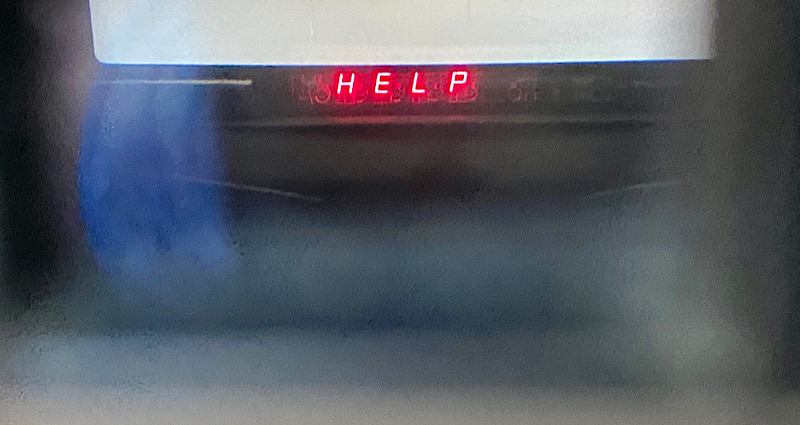

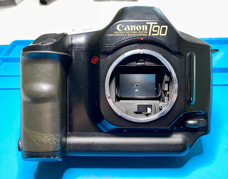

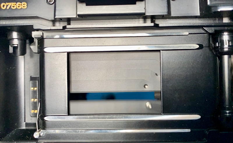

Examination of a T90 with a flashing arrow and „EEE“ in the display
The candidate in used and good external condition.

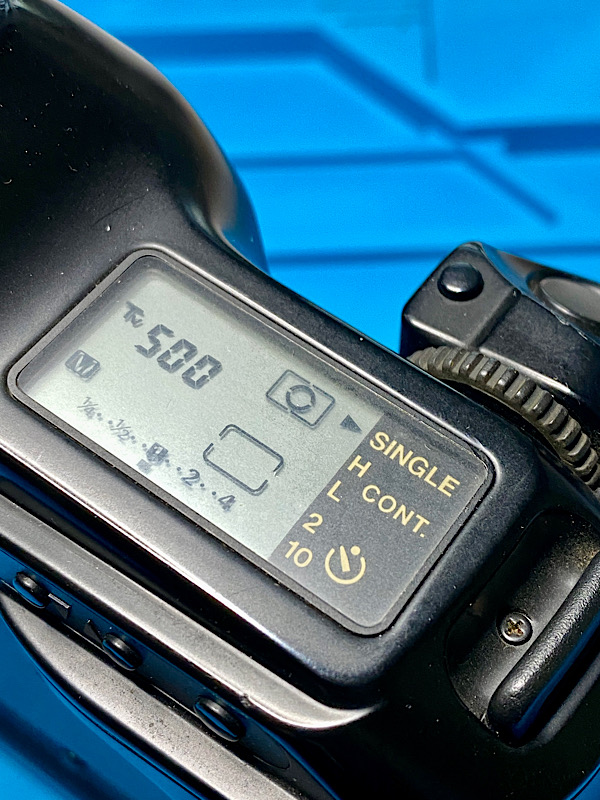

After inserting the batteries and turning the main switch to ON, the usual displays appear on the LCD.
When the shutter button is pressed, the mirror does not react, the arrow for the motor mode and self timer flashes. This means that the mirror magnet is stuck, which I remove and clean.

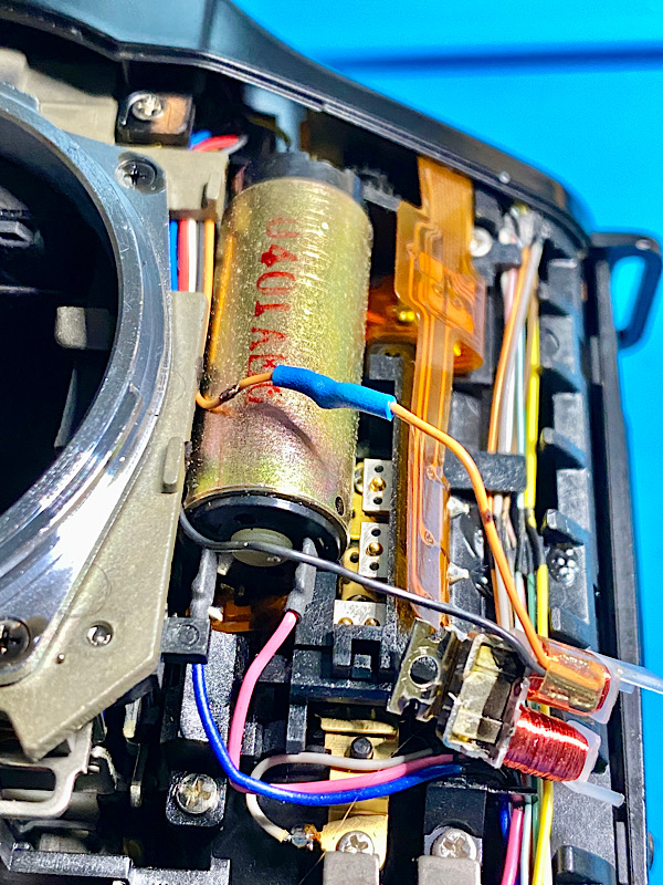

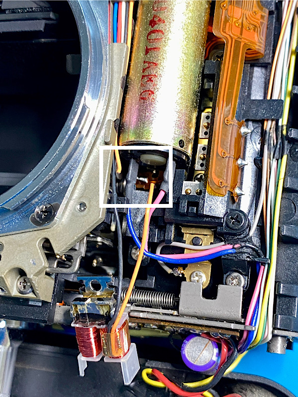

The orange wire to the magnet is cut, I did that myself on a previous project.
I should have checked my repair log.
So I stripped the two cable ends and soldered the parts together, which wasn't easy but worked. The blue shrink tubing fixes and insulates the connection point.
Now the mirror and the shutter release when you take the picture, but the latter not completely. One of the three motors makes a howling noise and „EEE“ appears on the display.
The T90 no longer responds to any inputs.
When you press the battery check button, the error message is deleted and the normal LCD display appears again. The camera can be triggered and the previous sequence will run again.
I remove the sticky damper residue from the rear bottom of the shutter unit.
I have described how to do this here:
The camera shutter sequence in time-lapse recording

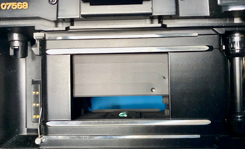

Since I had already seen that the vertical focal plane shutter was only partially closed, I filmed the process using the slow motion function on my iPhone.

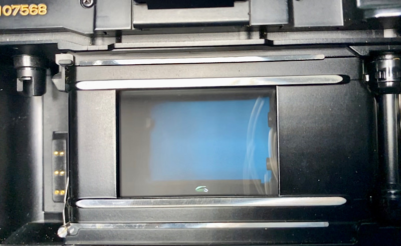

Here are screenshots from it, looking from the shutter to the lens:
The rear shutter curtain before the shutter is released. It fully covers the film window.
Release - the rear shutter curtain opens downwards.
The front shutter curtain follows, but stops after about 2/3 of its way down. It should close the film window completely.
The rear shutter curtain moves up.
The front shutter curtain also moves upwards.
The rear shutter curtain covers the film window.
The sequence is over.
Conclusion
  • This EEE problem is caused by the camera shutter not working properly. The front shutter curtain does not complete its travel.
  • The rear shutter curtain functions normally.
  • The problem obviously has nothing to do with sticking of the damper residue in the shutter. There are no damper residues visible on either shutter curtain.
  • It looks more like the front shutter curtain is blocked on its travel or is not being moved completely by the shutter's spring system.
  • The two shutter magnets cannot be the cause because they trigger, otherwise the shutter curtains would not move.
  • For further examination, the shutter unit would have to be removed, which is not possible for me at the moment.
  • Therefore, I see no way of solving the problem here. A T90 with this fault can therefore only be used by me as a spare parts store.

Not an electrical problem, but a mechanical one?
I continued working on the T90 with EEE/HELP today.
I had previously observed that the second shutter curtain did not close completely after the shutter was released.
To investigate this further, I tricked the camera by releasing the shutter in BULB mode.
The first shutter curtain ran completely from top to bottom.
When I took my finger off the shutter button, the second followed - and at that moment I pulled the battery holder out of the camera a little.
Now only the second shutter curtain was visible before it was wound up by the motor together with the first.
The second shutter curtain could be freely pushed back upwards against spring pressure.
But it didn't let itself be dragged down any further.
Even using two fingers to pull it more easily didn't work.
The shutter curtain was locked and should have been able to move downwards freely.
Conclusion
  • The two shutter magnets are not the problem, as they release both shutter curtains.
  • I also rule out resin build-up/contamination, as that would not create such a resistance.
  • That just leaves a mechanical problem in the shutter unit.

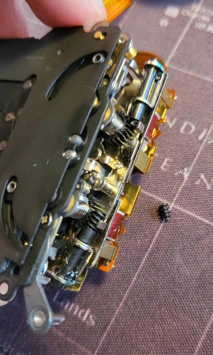

The spring tension for the shutter curtains is set with 2 little plastic screws. These can break and will release all the spring tension in either shutter.
I managed to print a replacement on a resin printer and got the shutter block working again, but when i reassembled it the flashing cursor error appeared. It appears to be a faulty mirror coil, but it's strange that it just started happening after repairing a different fault.
Attempts to remagnetise the coil worked to some extent but it always reverts to locked shutter and flashing cursor
I just set the camera to bulb release and I will leave it overnight in the hopes that the coil will re-magnetise, (on reccomendation from a different forum post), but i suspect that the coil is pulsed for the release rather than set permanently high. If this doesn't work i could de-solder and energise the coil with 3v for a period of time for the desired effect.
I also seem to get 14.8v for VDD on the DC/DC converter rather than the expected 15.2V so maybe the pulse just isn't strong enough to release it. Energising the coil directly results in release without fail.
Maybe the smart thing to do is swap the DC/DC converter and test it again

Thanks for posting the information w.r.t. the plastic cogs. As a fellow T90 owner, that photo is kind of disconcerting...

The shutter curtains are also replaceable, and it's easier to remove the melted shutter damper with the block removed

Once you have removed the battery tray and the wires on the upper rewind side of the main flex there's not that much more to do. The main flex is attatched to the motor flex and SP flex with a pressure bar, so that's no soldering. But there are some tricky solder pads that are easy to damage on the DX flex and the shutter flex connections. There are also some pins that need to be desoldered with copper wick before the flex can come away from the body but it's not that tricky.
I organised my screws in the lid for one of my screwdriver sets and took lots of pictures, but the journal i have goes through it step by step so it's easy to backtrack for reassembly.
I have made a repair guide before for canon AF35ML, I could put something together for the t90 now that i've fixed so this many issues on one camera, but the guide does exist in this journal already so it's a little less pressing. When i have more time i might put one together.
Yeah the plastic screws set the tension and adjust the curtain travel time. It should be 2.7ms +/- 0.2ms, but I haven't checked the travel time on this camera. Any more tension and it weakens my 3d printed replacement. Once i improve my printing technique and refine the 3D model i might be able to get it to withstand higher tension. Especially if i start using specialty resins but they are much more expensive.
As far as i'm aware yes the shutter screws and the contaminated or weakened coils are the only EEE problems with the T90, along with the loose mirror box screws that cause strain on the aperture setting lever and lead to flashing cursor.
Flashing bc error appears to be caused by incomplete winding cycle, and can be fixed by manually applying 3V to the charge motor or sometimes by just pressing the shutter release. (Maybe other failure modes)
No LCD can be caused by poor contact between the FD and main flex at the rewind end (where the film door switch pin extends through both) or short to ground on reset pin
I also had locked shutter that was due to contamination in the rear button panel. Instead of the regular display on LCD it showed iso, so obviously the iso switch was earthed. Cleaning the contact pad resolved it.
So far i don't think i've ever encountered a t90 with a dead PCB backup battery surprisingly
Plenty more problems to find with these cameras i'm sure but overall it's not too difficult to work on. Many people blame faulty IC chips on electronic cameras, but i have never conclusively encountered any camera with a dead chip. The nikon L35 AF has this reputation, and people say it's unrepairable, but it's nearly always a mechanical issue or battery leakage.
