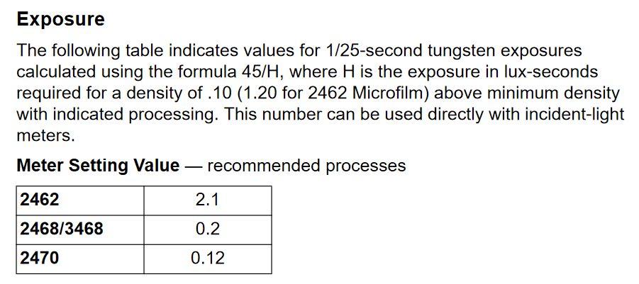

From the data sheet for the film:
svetoklik
Feb 5, 2023
48
Bg
There is also info there that is fantastic ISO 00.6 if I have understand.
