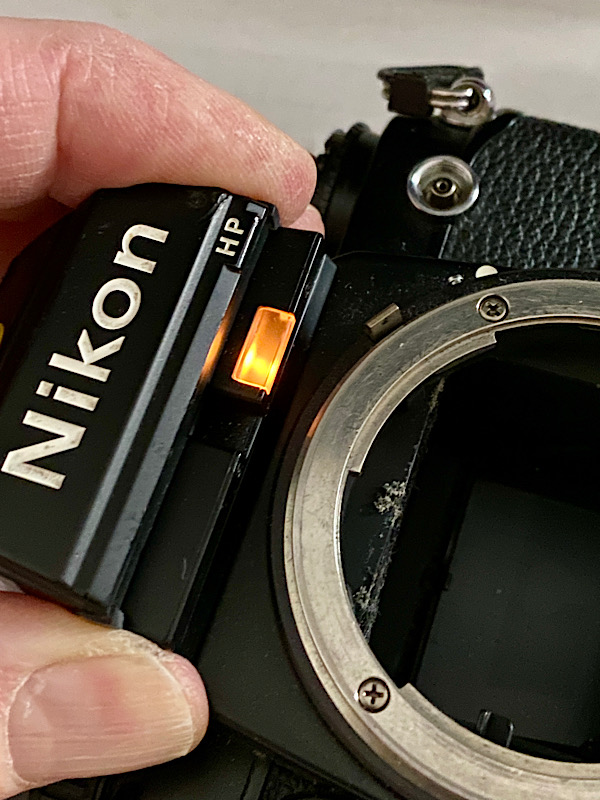

Of course a tutorial of a simple fix for the %&#! button that turns on the lamp on an F3 is always a welcome sight.
Andreas Thaler
Andreas Thaler
Nov 19, 2017
4,209
Vienna/Austria
A dash of electronic cleaner should help.
Otherwise, the long way to clean:
