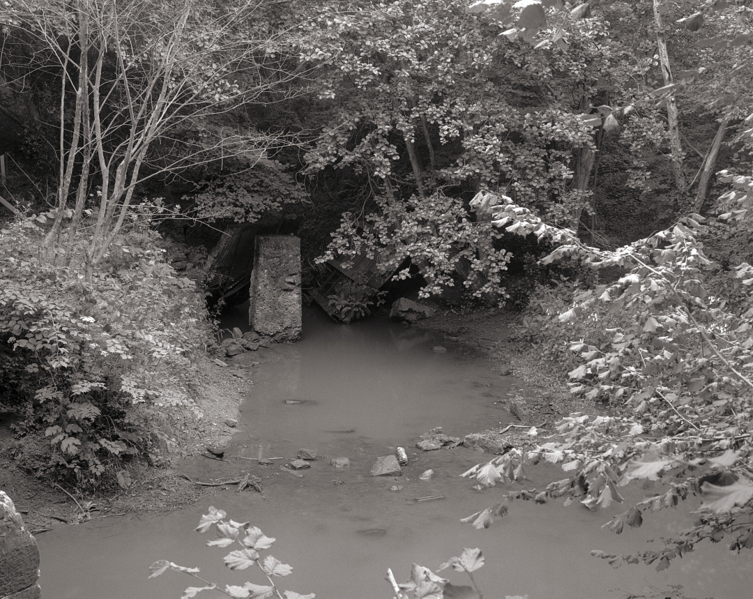

Same day, top image EFKE PL25 @ 50 EI, 2nd either Tmax-100 @ 50EI or Agfa AP100 @ 100 EI.
Ian
