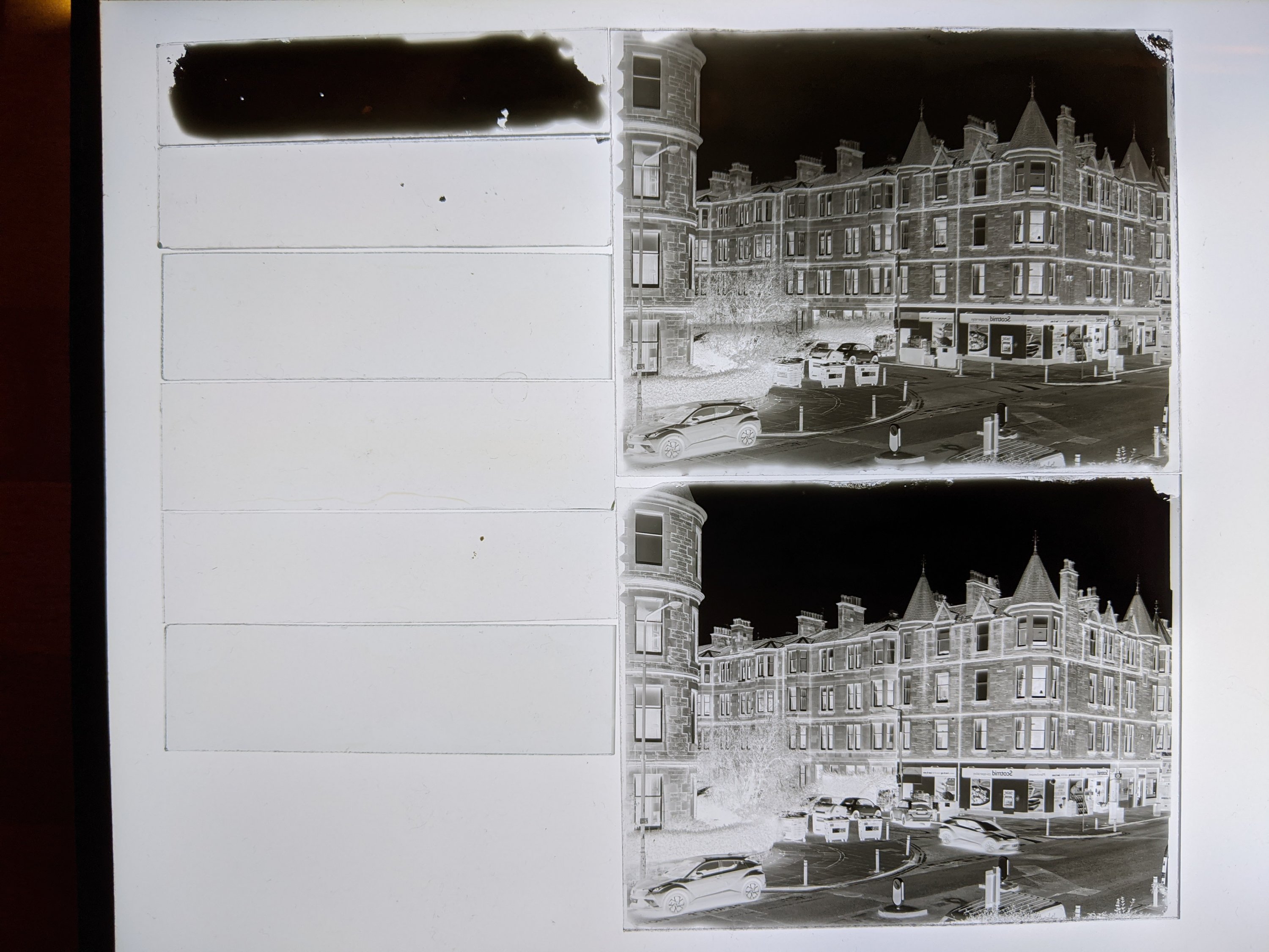

The Zone System (with N+ and N- dev) is predicated on the use of thicker emulsions from earlier in the 20th century and doesn't work as well with more modern thin emulsions. Personally I don't feel I can alter the contrast of HP5+ very much by push/pulling but Fomapan 100 (which I presume is an older, thicker emulsion) responds quite well - but is probably not such a good general purpose film.
Contrast control is really noticeable doing dev by inspection on my own emulsion which I presume are as thick as 19th Century emulsions i.e. about 1/2 inch.
These are the fog and ISO tests from my last batch. The top neg was over exposed and under developed the other was under exposed over developed (about 2 stops). You wouldn't get such a contrast change from a modern thin emulsion.
So if you want contrast control, perhaps to produce negatives suitable for historic print techniques, then thicker emulsions may be "ideal".
I expect someone more knowledgeable will say this has nothing to do with physical emulsion thickness now! There are obviously other factors involved as well as physical thickness.
It's not necessarily emulsion thickness, but number of emulsions - many older materials were a single, relatively polydisperse emulsion, while most modern materials use multiple much more monodisperse/ high aspect ratio/ epitaxial emulsions to get a better speed/ grain/ sharpness balance. As soon as you get multiple emulsions, they can begin to diverge in development rate, especially if severely underdeveloped, creating problems in the straight line etc. There are huge numbers of problems (internal reflection, turbidity etc - and that's before considering the sensitometric/ potentially lumpy curve shape issues) with the older polydisperse emulsion designs - which is why they were got rid of. That said, many sub 100 speed single emulsion films were not dramatically different in dried thickness to today's films, and the fastest single layer ones were probably not dramatically different in total thickness to today's 2-layer 400 speed BW films. And the very old wet plate methods produced a very thin sensitised layer - which is why they're so sharp - turbidity is a major problem that afflicts gelatin emulsions as they get thicker.
HP5+ is very amenable to contrast control, though a lot depends on what developer you are using - too often people don't realise that some developers either run out of steam very fast at some dilutions, or that you can switch to something much more aggressive (PQ Universal) to stretch things further. With multigrade papers, you shouldn't need to excessively reduce development time - and indeed, too much N- can flatten midtones badly - in those cases, unsharp masking/ over threshold fogging to deal with getting highlights into range can deliver better results, precisely because you can keep a better midtone gradient. Kodak make pretty strong hints that you really shouldn't take T-Max films below a contrast index of 0.5-0.6 - so that you don't mess up the multiple emulsion relationships - and/ or make the films painful to print - they have such a long straight line into the highlights at that CI anyway, that you can just burn them in & keep good gradation - as opposed to films that shoulder the highlights, which gives you muddier tonal separation if you go to burn in.
