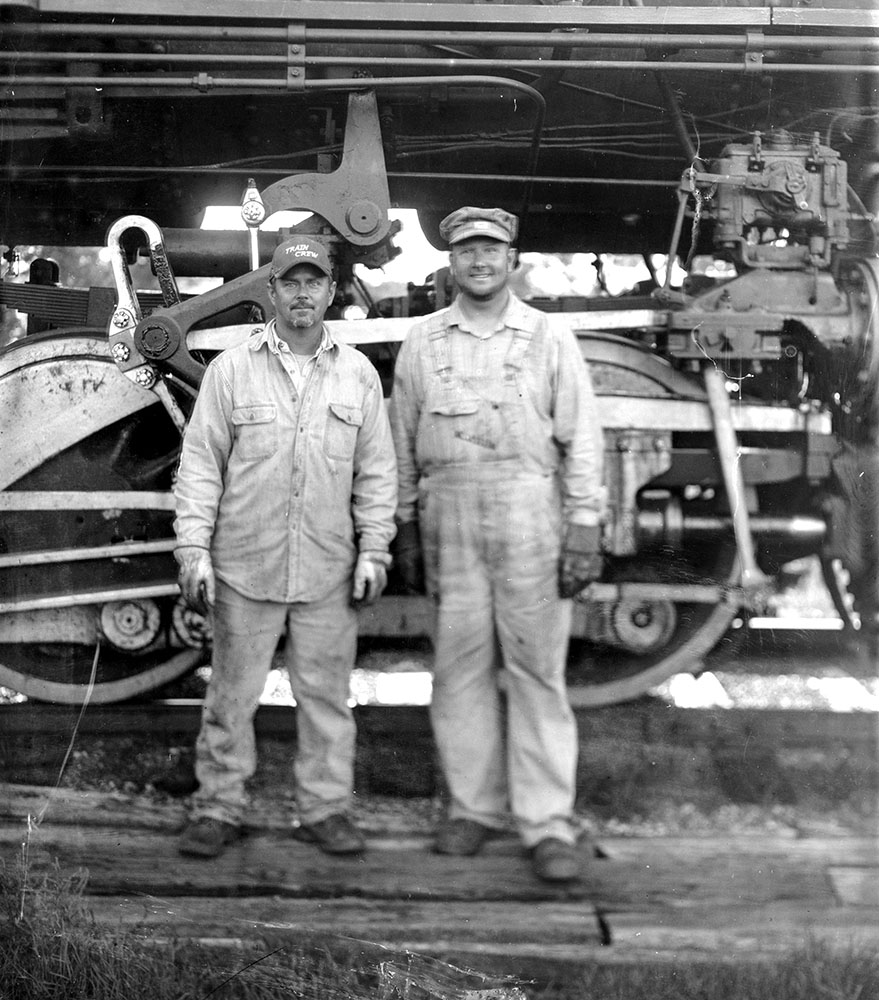

I have been taking some portraits with the goal of achieving a 19th C. look. Here's what I've found. Most 19th C. photographers were using the light from a north facing window. These were special windows that were actually a window/sky light combined (floor into roof window.) Flash seemed to be a last resort, partly because it was dangerous. A lot of photography studios burned down before the invention of bulbs! I would be hesitant to use flash powder for portraits because of the danger of someone being injured. If I remember right from my chemistry days, those flying sparks are something like 3,000 degrees! What I use are actual lenses from the time period I want to replicate. For 1880s and earlier I use a Petzval lens. For the time period between 1865 and 1900 a rapid rectilinear lens could also be used. The key to these lenses is they are uncoated. That greatly softens the contrast and creates an overall softer look. Second thing is I'm shooting glass plates (dry plates) now that they are available. I shoot both 4x5 and 5x7. These are sensitive to blue and UV light only, where modern film is sensitive to all the visible color specturm. Another factor of the plates is about 10% of the light that goes through the emulsion reflects and goes back through it a second time. This creates a slight halo (halonation.) All modern film has an antihalonation coating. My advice is to shoot glass plates on your 4x5 using a good Petzval lens, using soft light such as north facing window or an overcast day.
Kent in SD

I have been taking some portraits with the goal of achieving a 19th C. look. Here's what I've found...
Nice image. Is that Union Pacific 844 that made a tour not too long ago by chance?
Thanks for all the information on old portait technique.
faberryman
Jun 4, 2016
6,048
Wherever
I also suggest you ask your subject to take off his baseball cap so the image looks more authentic. As shown in the photo above, no amount of dry plates, Petzval lenses and north facing light can overcome modern dress.

I also suggest you ask your subject to take off his baseball cap so there photo looks more authentic. As shown in the photo above, no amount of dry plates, Petzval lenses and north facing light can overcome modern dress.
Isn't the image supposed to look fake?
Wasn't my goal to take a completely period correct photo here. I got to ride around in the cab and in return I took a few photos of the guys. Glass plates and a c.1900 rapid rectilinear lens were all I had with me., I have done that many times with Civil War re-enactors though. As for the locomotive, the UP 844 has drivers much larger than this little 0-6-0 at a local tourist railroad.
