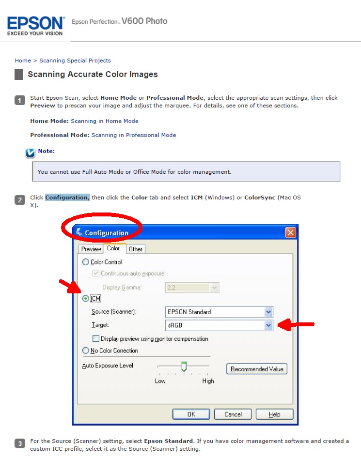

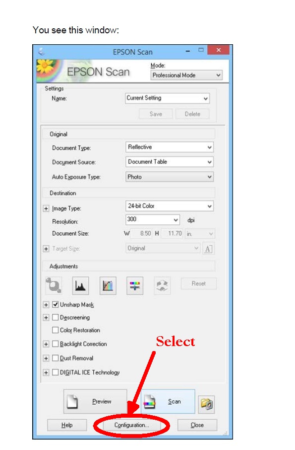

I’ll definitely use Epson Scan for most of what I will scan (6x7 and 4x5 B&W negatives).
The argument that I used to justify the purchase of this scanner with my wife, however, was that I’d use it to scan about a decade’s worth of 35mm negatives in our family collection. These are a mix of Kodacolor, Kodak Gold, Ektar, and Fujifilm color negatives. Does Epson Scan allow you to choose which film when scanning to optimize the scans for that film type? I know that SilverFast does, but I didn’t see an option in my limited usage of Epson Scan so far.
Aug 29, 2017
9,250
New Jersey formerly NYC
I don't shoot negative color film because it is harder to scan. Others have used ICC profiles with Silverfast but I never have and don't know how to do it. Epsonscan does have some selection process if you Click on Configuration at the bottom and then go to that page. Notice the ICM section in the Color tab. There's a way of scanning in target colors and then select to match but I don't know how to do it.
By the way, the V600 manual is more complete. I got the second page from it. The V850 pdf manual does not have all the same instructions. Download the V600 manual for editing and selecting scan settings and use the V850 manual for using the V850 film holders and settings unique to it.
V600 manual https://files.support.epson.com/pdf/prv6ph/prv6phug.pdf
V850 manual https://files.support.epson.com/docid/cpd4/cpd41530.pdf
