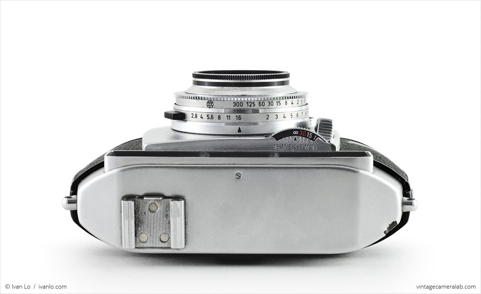

Maybe this:
https://vintagecameralab.com/balda-baldessa-ia/
I am considering buying a similar camera, which prompted my question, that is, will the EV readings on my light meter phone app correspond the ones on the camera?
I am not familiar with that camera but I see that one of the photos shows a top view and it appears that the shutter has ordinary f/stops and shutter speeds marked on it too...so, it would be a trivial matter to discover if the EV scale on the shutter conforms to the ANSI/ISO standard and even if the EV scale is different (which I doubt) it would be easy to set shutter speed and aperture in the usual way.
