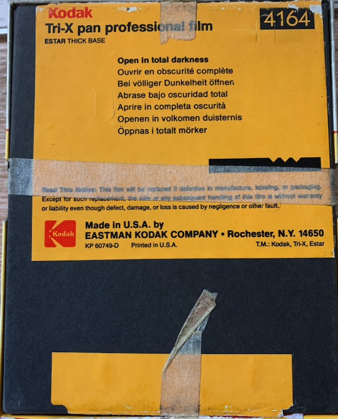

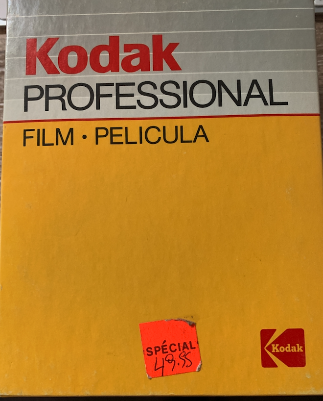

I have an open box of 4x5 Kodak Tri-x pan 4164.
Expiry date unknown. Likely 20 years old or more.
It came with my recent purchase of a Calumet 4x5 camera.
I would like to expose a couple of sheets.
Does anyone know the ISO rating of this film.
Surprised that it is not printed on the box.

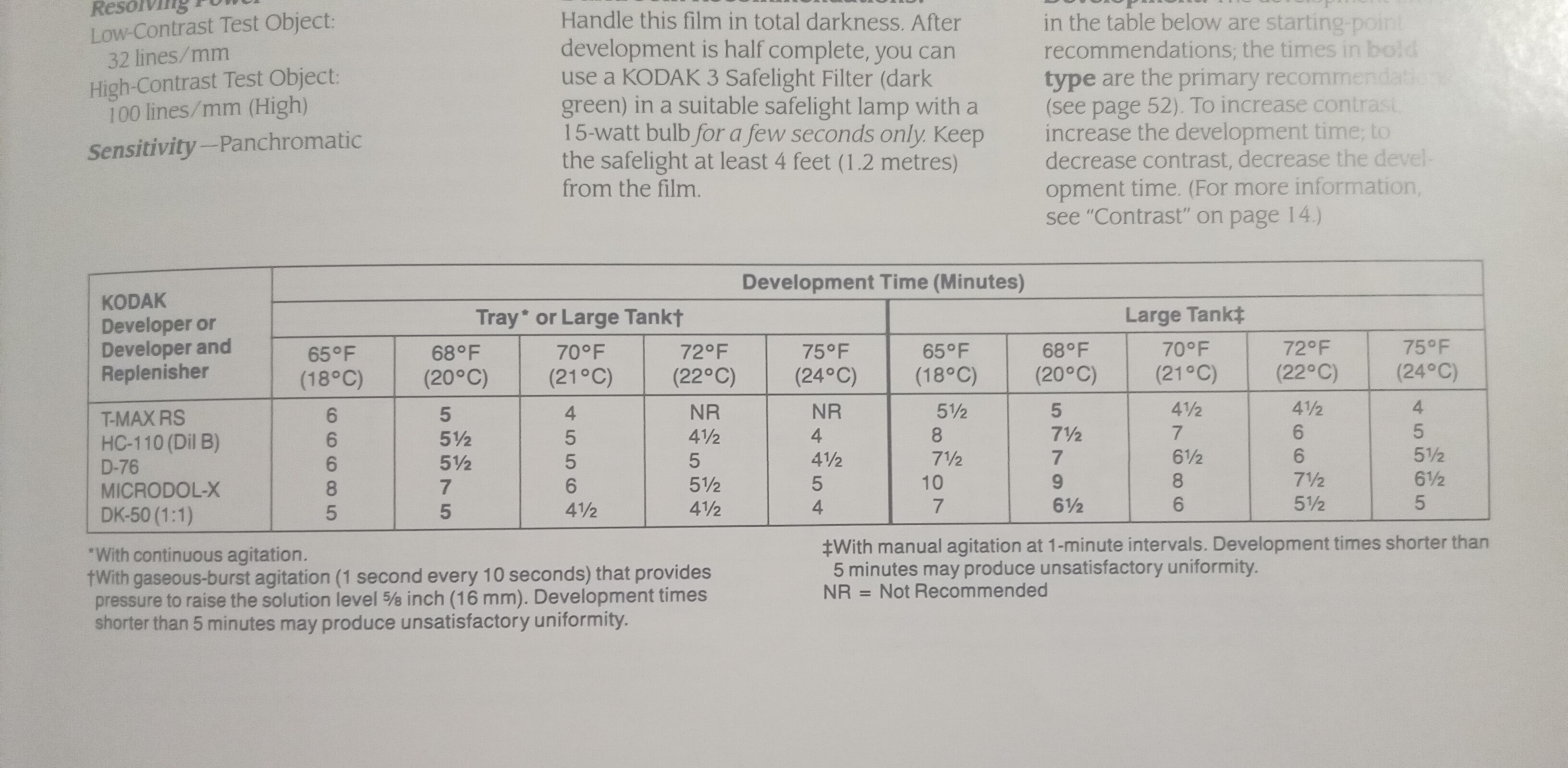

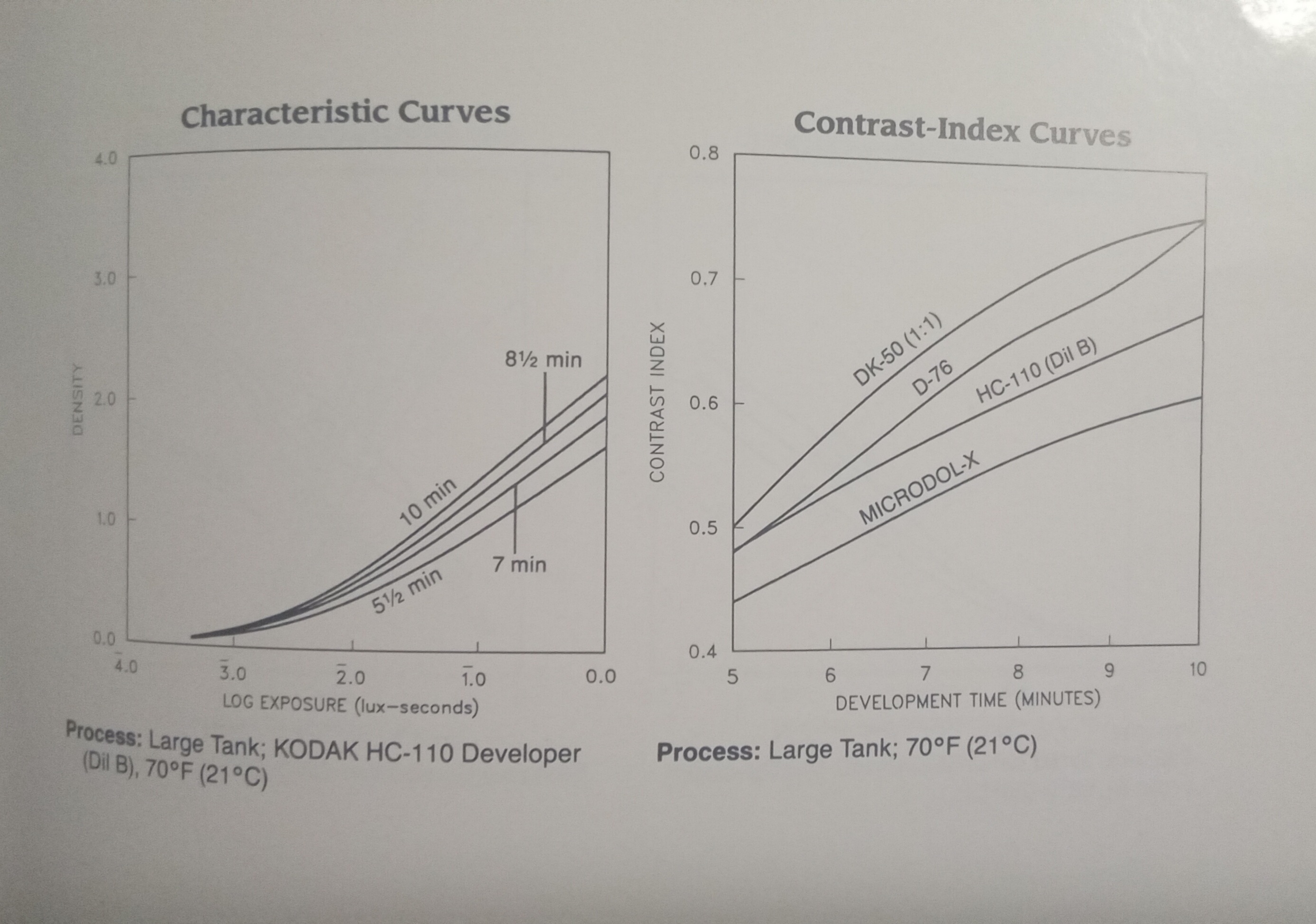

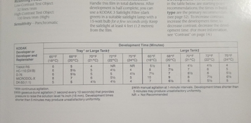

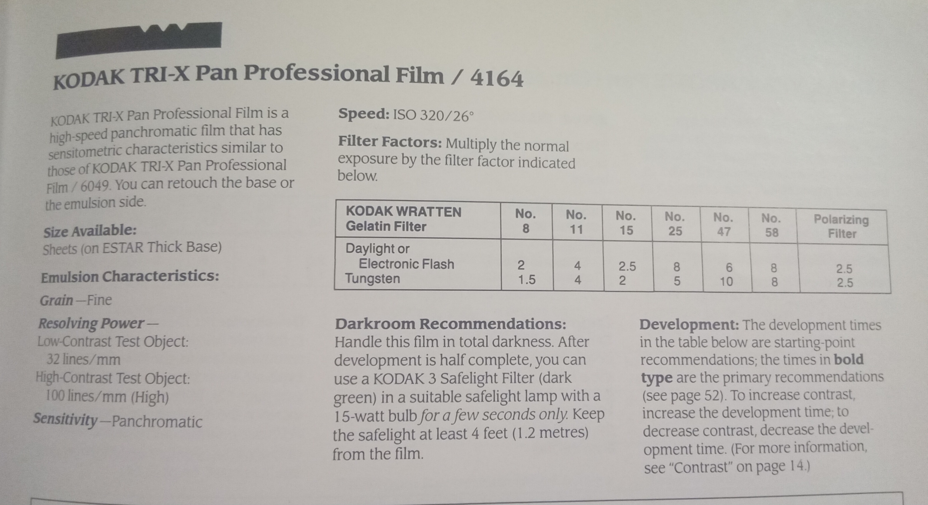

I have a Kodak Professional B&W Films book from 1990, it shows that its Kodak Tri-X Pan Professional 320. Here's some photos of the datasheet (some dev times for Tmax RS, hc110, D76 (stock) microdol-x, dk-50 (1:1), characteristic curves, contrast index cur es)
