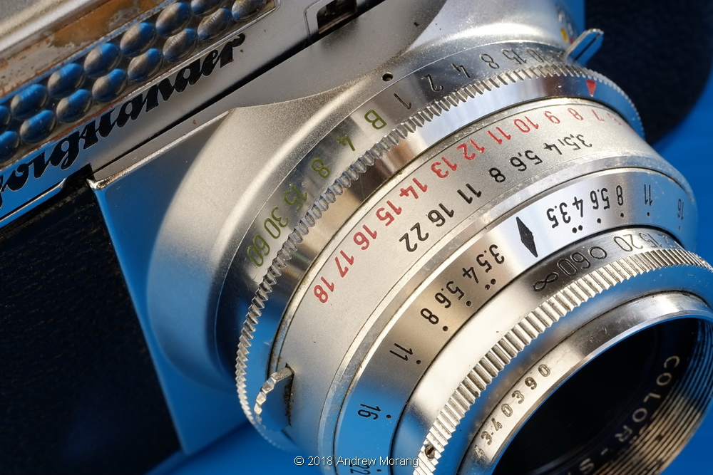

Some of the late-1950s Voigtlander cameras, such as the Vito BL and the Vitomatics, have the EV scale on their lenses. The aperture and shutter speed are locked, and you need to depress a tab to unlink them. This the same as the C Hasselblad lenses. On my Gossen Luna Pro Digital and Sekonic 318B light meters, you can set the display to show EV - very handy.

I remember a paragraph in a book teaching photpgraphy by Alexander Spoerl, which was very common in the last '60s - early '70s, in which the author introduced the matter of these cameras with EV scales and concluded that yet another confusing scale has been added, which will further confuse customers already quite puzzled by the shutter and aperture scales.
Which, of course, EV was trying to eliminate the complexity of aperature/speed. That even some pretty expensive cameras utilized it shows that even traditionalist companies thought it worth the effort.

I think however that the picture above clearly illustrates that the end result was just a further scale added to all others, which is exactly what mr. Spoerl complained about.
I have a real love-hate relationship with it on 'blad lenses. On one hand, it's nice that once you've set the exposure, you can pick the aperture or shutter speed that makes the most sense for the situation(it's sort of an early variation of the "select shift" program on a lot of AF-era SLRs, which admittedly I never use). On the other hand, actually changing exposure is almost always a two hand operation and even though you CAN set it by looking at the shutter speed and aperture scales, it's honestly easiest to go straight to the EV scale on the side of the lens. It works great when you're using strobes or some other situation where you're not really changing exposure from shot to shot, but it's a bit different in the "real world" where you may be changing from shot to shot.
