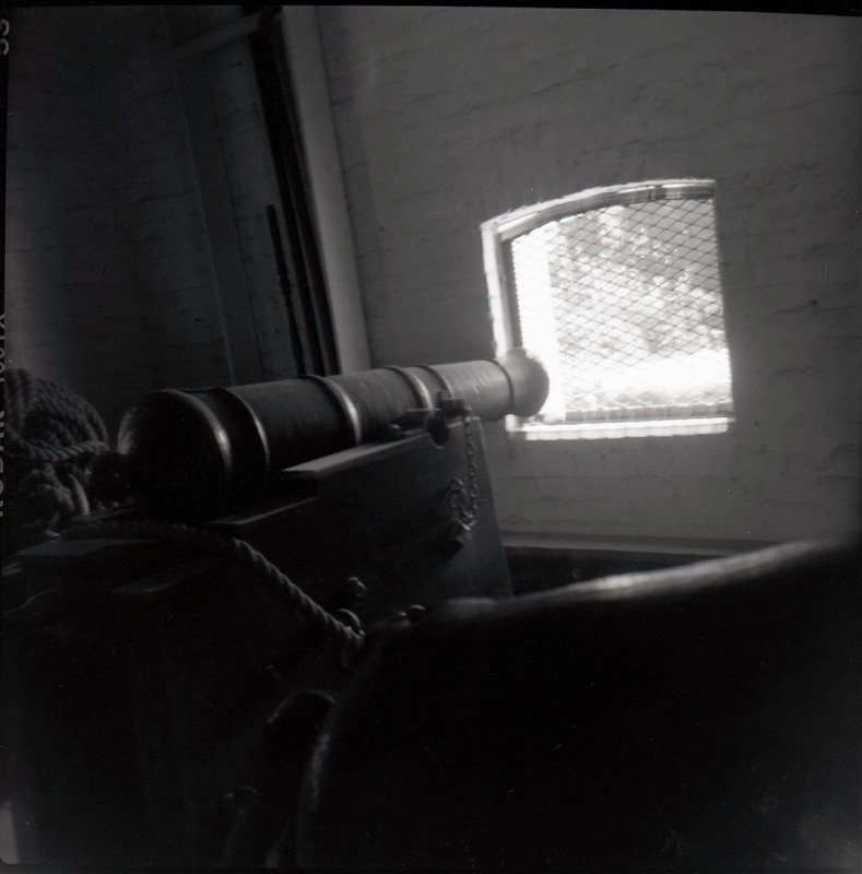

Several years ago, I shot a roll of tri-x with a Kodak Duaflex. There are two shutter modes, one for "instantaneous" and one that keeps the shutter open as long as you hold the shutter button down. I later realized that I'd had it in this "bulb" mode, so my exposures were all over the place -- holding my breath and pressing the shutter release carefully and gently probably made for some long exposures :blink:
I developed it in HC-110 about 1:250 ( 2ml syrup in the tank which holds about 480ml ). Agitated for 30 seconds and then set it on a shelf for an hour. The negatives were all perfectly printable and many of them were surprisingly sharp. There were also no "bromide drag" marks or other problems. I was surprised and thought that was pretty neat, but I never tried it again.
Here's a print from that roll:
At Fort Ross, a former Russian colony on the Sonoma Coast in California

Nice compression with the light from the window.
