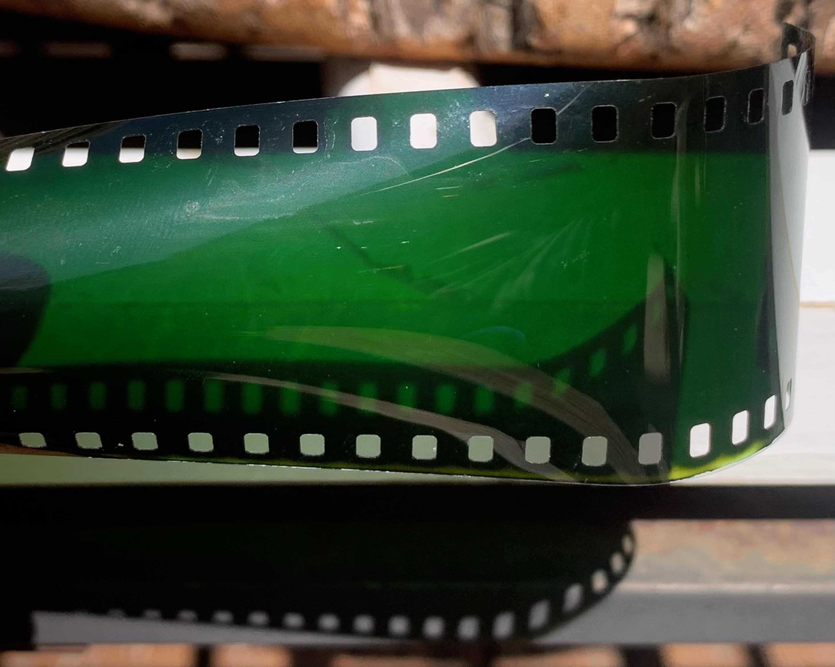

Attached is an image of one of the strips against a white wall with sun behind it. They are almost entirely green with some ugly splotches across the image areas - I didn't take too much care in drying them properly or washing after my permawash bath. If you look closely at them in direct light, you can still faintly see edge markings of FUJI RVP and numbering.

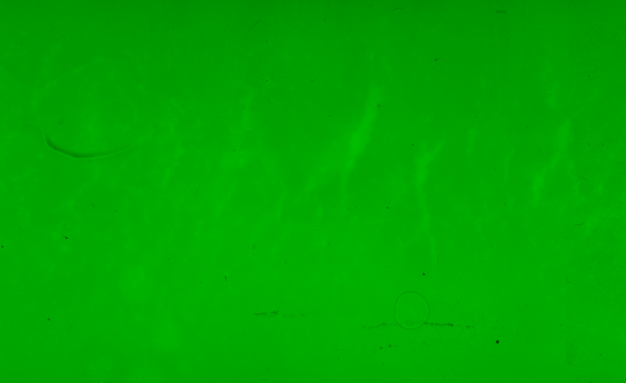

Also attached is a scan of part of the image area - EPSON V600 used on transparency settings. No color alterations.
