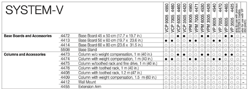

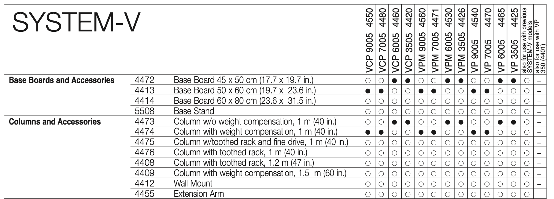

I just checked—my column is 1 meter, and they sell 1.2 and 1.5 meter versions.
I can easily fit the 1.2-meter one, but I don’t have enough height for the 1.5-meter.
So now I have two simpler options: a new column or a new lens. I’d prefer the lens—it’s smaller, easier to store, easier to sell, and more versatile.

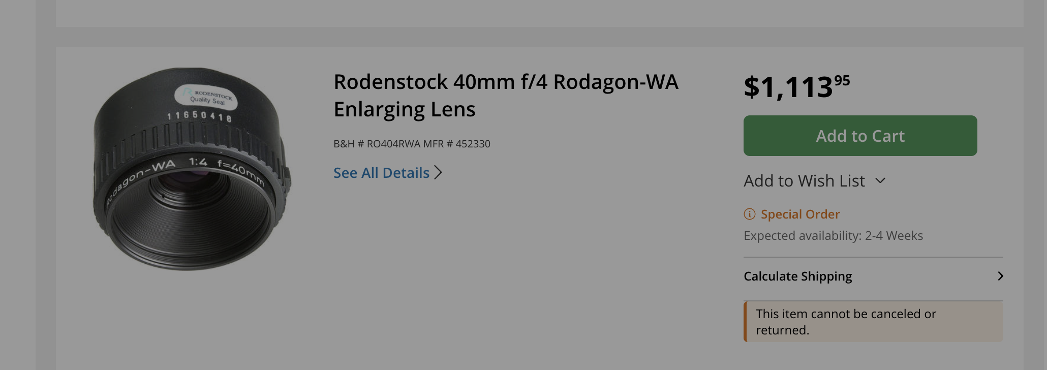

hiroh.... a new 40mm is around $1100 USD ....Ebay shows used ones at $400-500+.....

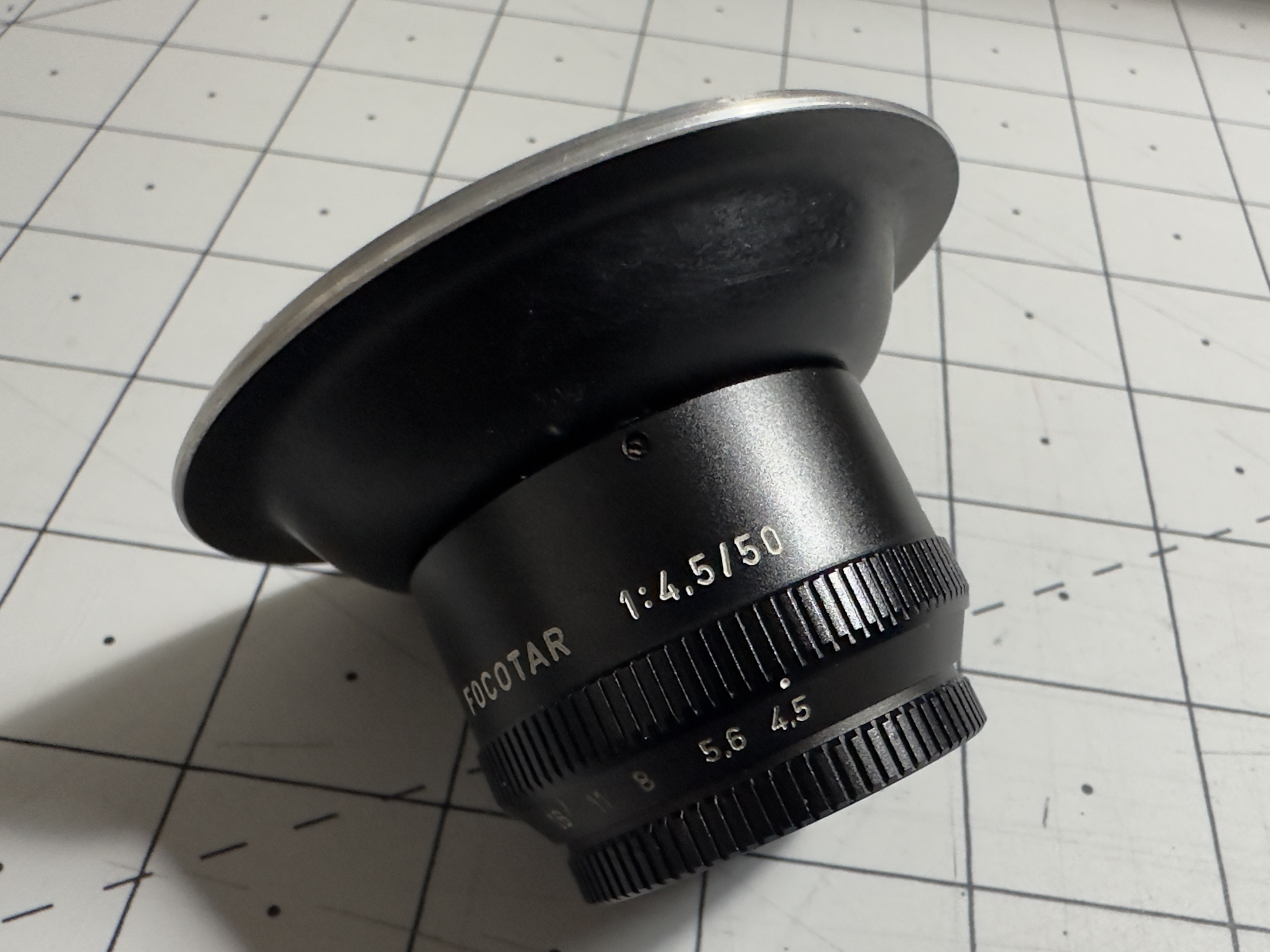

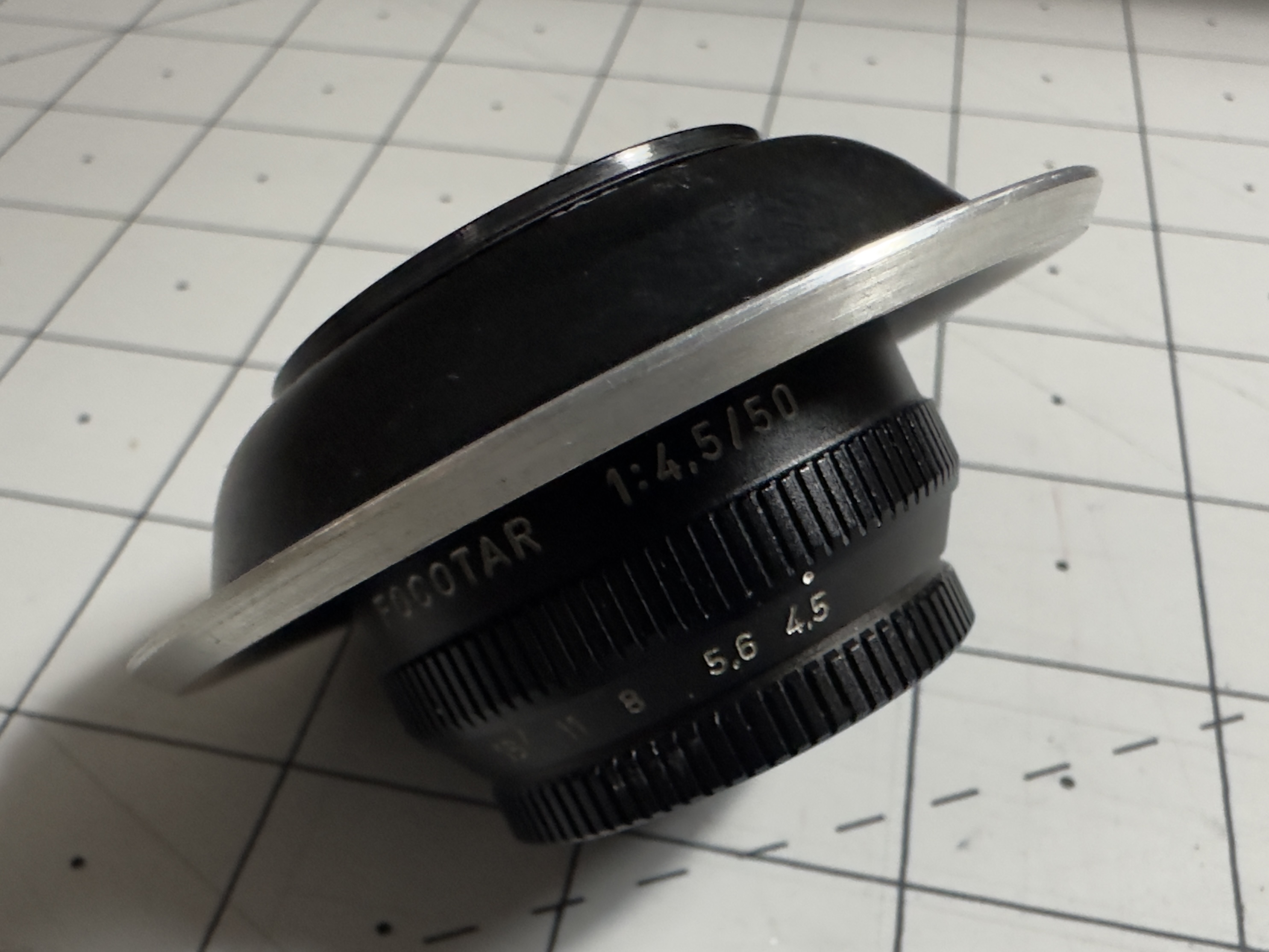

Ha! I flipped the lens mount, so now it sits closer to the film negative and projects a larger image. It’s much better now, but there’s still about a 3 cm border. I think if my easel were thinner, the image would almost reach the edge of the paper. My Kienzle 16x20 easel is more than twice as thick as my old Saunders, which I sold.

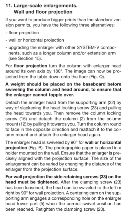

From the manual for the enlarger:

Something doesn't seem right with your setup. The distance from the lens to the neg should be the same for any given print size no matter which way you have the lens mounted, though having the lens too far away would limit how large a print you could make and be in focus. Was your limitation only being able to get the neg in focus at a smaller size? Do you have the head all the way up on the column?
I think that’s the point of the mount being this shape. When mounted one way, it projects a larger image than when mounted the other way. Both orientations provide a sharp image in all corners, the only difference is the projection size. I hadn’t even considered this before, I just discovered it today by accident while looking for a way to make a larger print.
So I don’t know if this is right or wrong but it works :smile:

The reversing mount is designed to accommodate shorter focal length lenses (like a 50mm lens) when mounted one way, and longer focal length lenses when mounted the other way.
