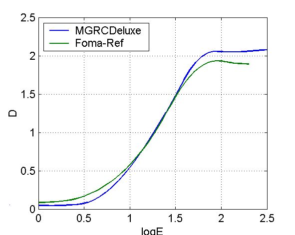

Summary view of the measurements:
Clearly the global contrast of the Ilfospeed is larger than that of the Fomabrom; so much for manufacturer datasheets. Restrainers may cause a speed loss, but that is not the current topic. How can we be sure that the "sparkling highlights" attributed to the Multigrade RC Deluxe are not a delusion? To address these issues, the next graph shows Ilfospeed versus Fomabrom, with the horizontal scale of the former stretched to make both slopes match in the mid-tones.
Multigrade RC Deluxe (stretched exposure range) versus Fomabrom Variant
Hopefully, the readers see that after matching the mid-tones contrast, the Ilfospeed goes to low densities in a quasi-linear way, while the Fomabrom makes a "soft landing". We have an objective confirmation of the impression encountered in the course of enlarging with these two papers.
