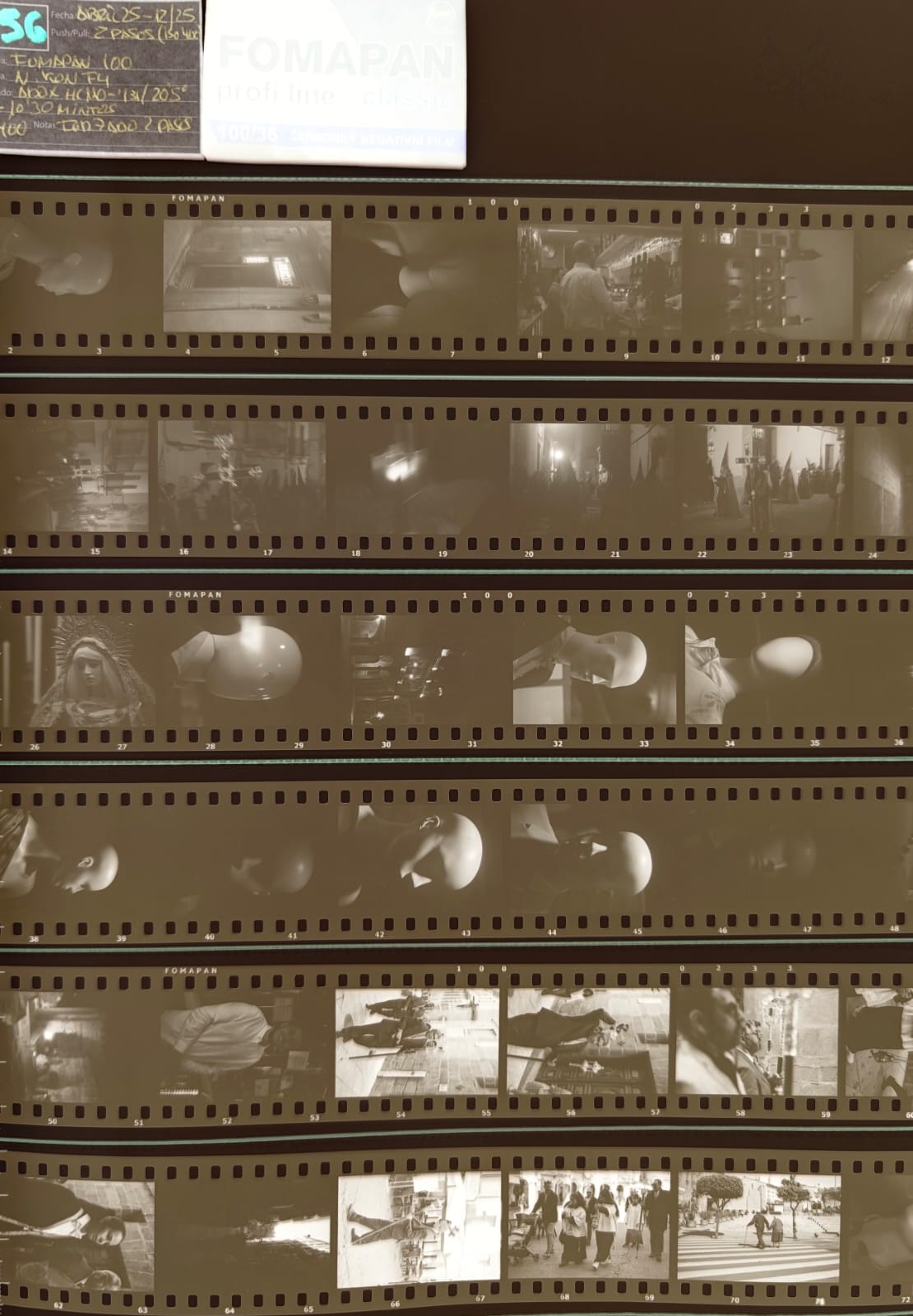

A promise is a promise. The negatives are as they are; I've just modified the curve to show them as positive:

I'm quite happy with the result, keeping in mind that most of the photos were taken at night... the noise is negligible. I developed with HC-110, 1/31, 20.5ºC for 10:30 minutes (not the 11:30 that massivedev indicated, because the developer was at a temperature of 20.5ºC instead of 20ºC, and I didn't have the patience to wait for it to cool down...)

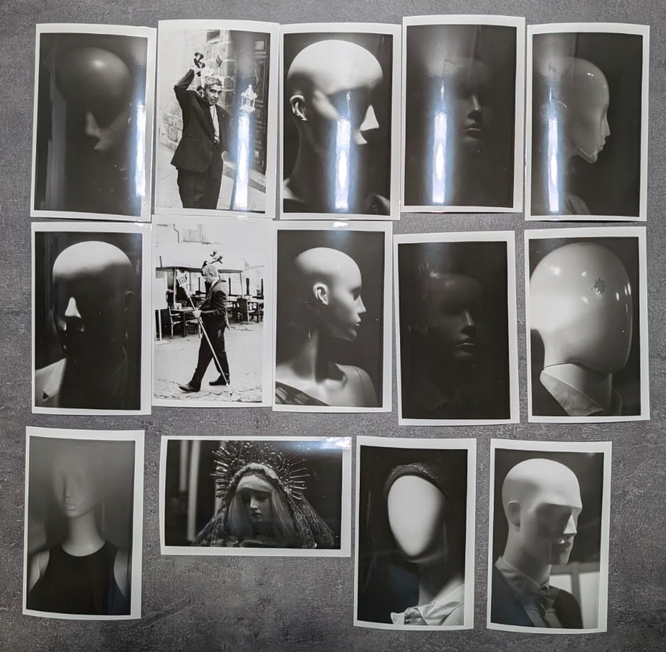

And since I was busy, I processed some on expired Ilford paper.
As expected, most of them are severely underexposed. No amount of additional development will compensate for this. The outdoor shots are better exposed, which may be due to how you metered the scenes.
That's not a difference you have to compensate for in practice in B&W development.
