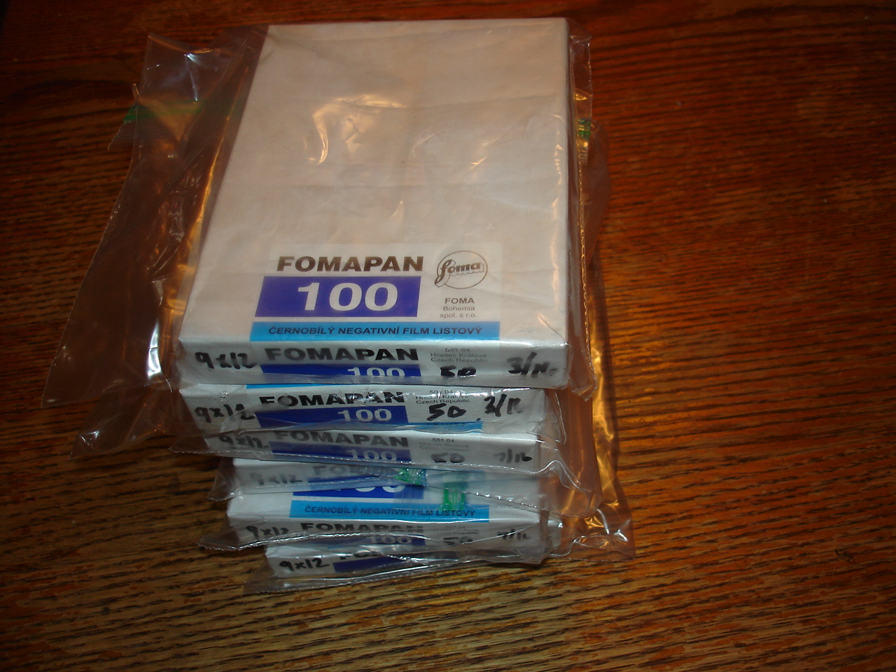

Good to know, I am just starting with FOMAPAN 100 & 200 in 9x12. Bought 300 sheets of each, to use in my three Plaubel Makiflexes. Yes the prices are low, about 80 cents a sheet delivered to me. Less than half the price of Ilford HP-5+

Helpful information here!
Wow... That should keep you busy next year. Looking forward to your pic posts.
