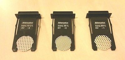

You can also use a piece of metal with holes in it, or some screen.

As for metal discs with holes, screens, etc. These work well, but need to be installed at the light source. The Omega Chromega heads have exactly this feature to adjust light intensity; a disc with holes that moves into the light path very close to the bulb and before the light gets to the dichro filters. You could install a screen or disc with holes directly in front of your enlarger bulb and see if that works.
