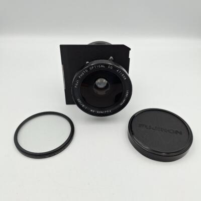

Wanted some advice. I’ve been searching for a 120 mm F8 wide angle for the 4 x 5 I have on order. I have been looking at Schneider, Nikkor, and Fuji. Mainly at the Fuji because the Nikkors seem to be the most expensive by quite a bit, followed by the Schneiders, with the Fujis being the best value (assuming they are good lenses, which I hear they are)
So here’s my question. I have already a 180 mm Nikkor W. It’s multi coated. I have the opportunity to get a Fuji 120 mm F8. SW at a very favorable price. I also have an opportunity to wait and find one of the multi coded versions, which cost about $100 more as far as I can tell so I’m trying to decide whether to hold out until I find one of the multi coated ones which would simplify processing because of its greater contrast compatibility, or buy this lens which will help me with my goal of keeping the budget down? Would I really be giving up that much by choosing this lens? What would you do? I have a seller offer for 269 which includes shipping and the Linhof Lynn board, which has the bonus of fitting the camera I have on order. Here is the link from the listing.
TIA
ps, I have heard of Seiko shutters, but don’t have any idea what a LS 29 is or whether it matters

I have one of those and it works fine. It even covers 5x7 well, so you will have plenty of movements at your disposal. I have found that all of the Fuji lenses are about the best value out there.

Seiko shutters are fine and pretty common on the earlier Fujinon lenses, but I don't know if there are as many people out there that can work on them if you need CLAs. The main issue with the older lenses is single coating vs. multi coating. I don't know how much single coating will be an issue to you. It isn't much of an issue to me (a compendium hood is nice to have!)
Fuji made an EBC Multi-coated 120mm lens????? Perhaps you are confusing it with the 125mm f8 which WAS multi-coated.

One could read that listing and easily conclude that there was a later 120mm that was multi-coated. What it means is that it is an SW lens -- which was an earlier lens series -- and all of the SW lenses were single coated. The later NSW lenses (there were only three of them) -- were EBC coated, but the SW 120mm was replaced by an NSW 125mm.
