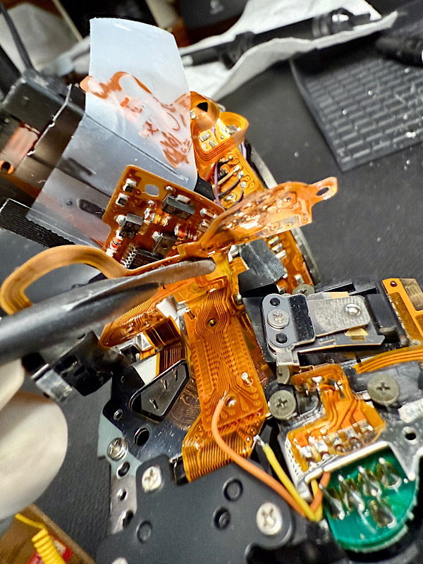

The electronics of an AF SLR - here a Minolta Dynax 7000i from 1988 - are concentrated in integrated circuits, which are connected to the camera's functional units via flexible printed circuit boards. How the circuit works isn't important for a DIY repair. Faults are usually found in the contacts and their connections as well as the mechanics where it's (not always) easy to work.

This all looks complicated, and it is. But DIY repairs aren't about understanding the designers' and engineers’ work in detail. Incidentally, such flexible circuit boards have the helpful property of almost self-assembling, shown here in a Minolta Dynax 7000i under the main LCD.
