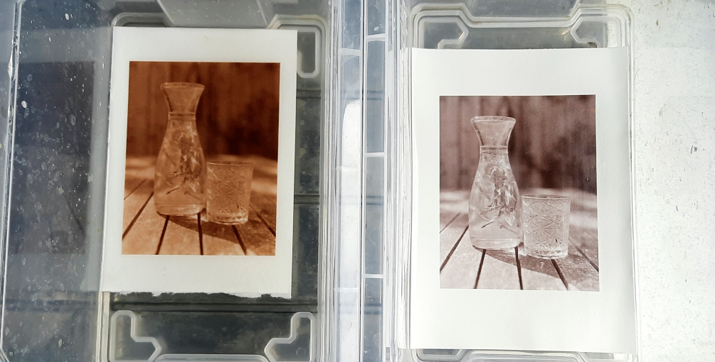

my gold thiourea-toned vandykes are pinkish, and that's what I have been calling warm. It's certainly warmer than the brown of untoned vandyke.
That's quite odd. My thiourea-gold toned VdB's gain density and turn more neutral.
I don't understand why humidity during exposure should make a difference
I can see how it will make a difference in the silver particle size you end up with. Humidity in the paper will act as a carrier for ions to complete a print-out reaction (VdB is partly POP, partly 'DOP' although there's no actual developer) and I can imagine that higher humidity will result in larger clumps of silver being formed during exposure. This will shift the tone to more neutral to begin with, and this may also affect how it tones.
Also, pinkish hues in gold-toned VdB's remind me of incomplete toning. Do you tone to completion? Mine go through a reddish stage early on in the toning process, but then start to gain density and turn neutral again. If I take out the prints during that first stage, I end up with something that resembles what you describe.

I find a VDB exposed very dry will tone to a pink-brown colour, and a VDB exposed with more moisture will tone to a much more neutral black. I've seen this a number of times. Generally the paper has to be pretty dry for it to happen.
@jisner said that his darkroom is at about 24%RH. That's very dry, and way drier than anything I see here in Sydney, so I'm not surprised that his prints tone the way they do.
My advice for a more neutral tone: don't dry the paper so much before exposure. I use a small fan for about 3 minutes at 60% RH. I'd use a lot less time at 24%. My test is that the paper is just starting to feel dry, but is still a little soft, and still feels cool.

I do not seem to be able to attach a jpg (even one much less than the 2mb limit), so here is a link to one of my toned VDBs.
