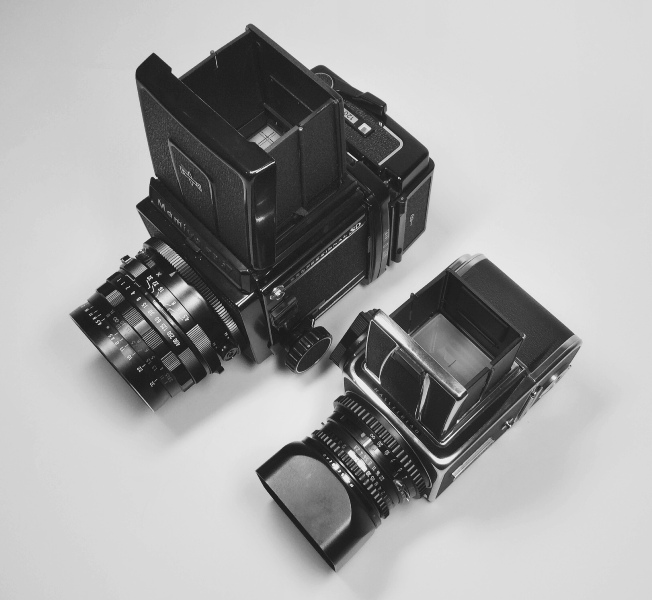

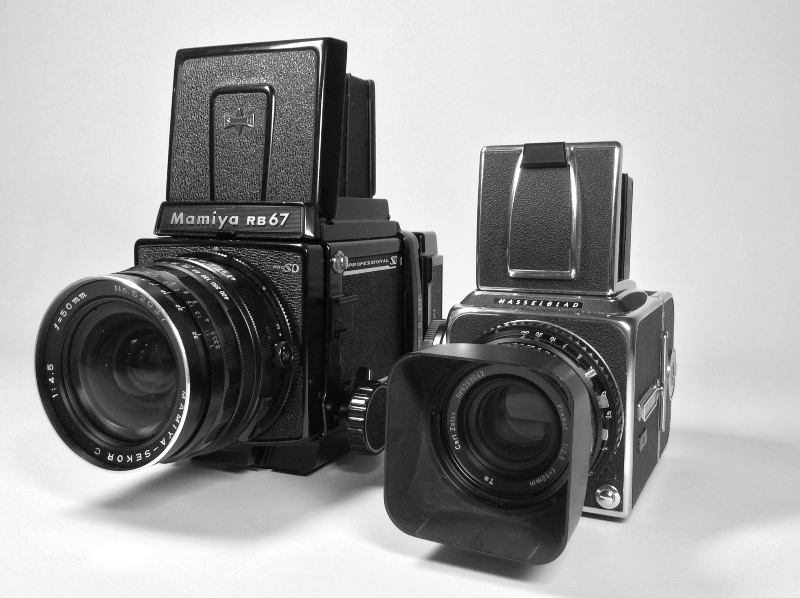

A quick size comparison of the two cameras:
