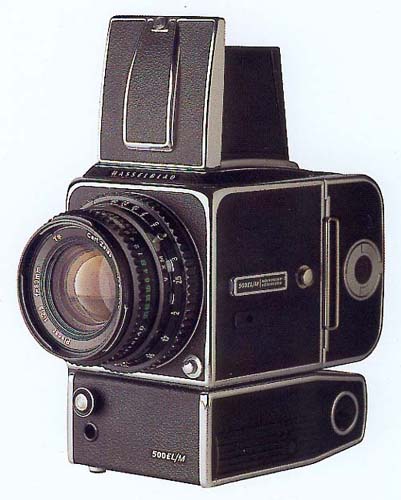

I looking for a camera repair shop that services the motorized bodes such as a Hasselblad EL/M? All it needs is
a CLA nothing is really wrong with it but it needs to be serviced and brought up to working specs. Your recommendations will
be most helpful.
Thanks in advance!
