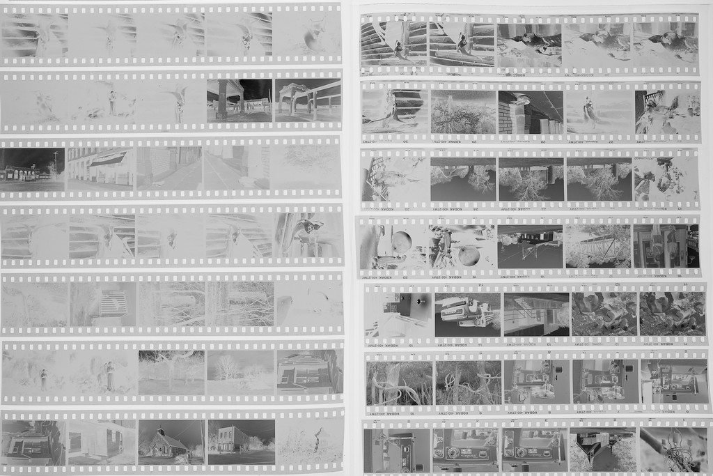

Short version: Fuji 100 Acros II negatives developed in Kodak XTOL are too thin, with faint edge markings.
1. Kodak XTOL, 5 liter kit mixed with distilled water. Mfg. date is 2019/10/07, exp. 2022-10, which is NOT the recalled lot, right? Powders and mixing seemed normal to me, but this was the first time I've prepared XTOL. All of Part A was completely dissolved in slightly warm water before adding Part B, at which point the solution turned from cloudy tan to clear. Aliquoted into 5 black one-liter plastic containers.
2. The next day, I processed a roll of Kodak T-Max 400, in XTOL at 1+1 with distilled water. Results appear to be normal. That one-liter container of XTOL remained 3/4ths full until ...
3. Twelve days later I mixed a 1+1 dilution of XTOL from the 3/4ths full container, using distilled water - and processed a roll of Fuji 100 Acros II - which is the roll that came out too thin. I use a stainless steel spiral reel in a metal tank. Kodak's <data sheet> says XTOL in "Partially Filled, Tightly Closed Containers" should be good for "At least 2 months"
When I was making the 1+1 dilution, I noticed a few small white floating specs which looked something like tiny fibers. I put a couple of layers of Kimtech Lab Wipes in the bottom of a funnel and filtered the solution to remove the specs. The total volume of these white specs was very small. A mono-layer would not fill the hole left by a paper punch.
Using numbers from the <Massive Dev Chart> I intended to develop for ISO 100, 9:30 at 20*C (68*F), but all my solutions were stable at 70*F (21*C), so I used numbers from the time and temperature correction chart <here> which shows 8:30 at 70*F should be equivalent to 9:30 at 68*F. Initial agitation was 30 seconds, then 3 inversions per minute.
The solution from my pre-soak poured off clear, as did the used XTOL after development. However, the fixer poured off as a bright pinkish-purple, and the hypo clearing agent was moderately pink as well. I was still seeing some faint traces of pink in the early stages of the final wash. This was my first roll of Acros, so I don't know if this is normal? I have seen colored solutions with other films, but as I recall, mostly from the pre-soak/developer?
In the first photo below, the Acros negatives are on the left and the T-Max 400 photos are on the right. I metered the Acros at box speed of ISO 100, and for the T-Max 400, I used an EI of 320. Most settings were taken from incident readings, using hand held Gossen and Sekonic light meters. What makes me think this is a developing problem and not an exposure problem is the faint edge markings (second photo); is that a reasonable assumption?
I suspect my problem may have something to do with my filtering step (?) - either I removed some precipitated ingredient that should have been left in, or the <Kimtech Wipes> may have affected the pH, or ...?
Going forward, I have 4 full liter containers of stock XTOL left. If the remaining bottles have precipitate, should I trash it? Do I need to run a test roll, of throwaway-shots, .... or ... ?

Can we agree that the sheet of negatives on the right side of my first photo look about right? And therefore, this batch of XTOL worked as expected at least once?
Seems so to me.
I wonder about your storage bottles - could thy have been contaminated?
Try another roll of T-Max, or at least a clip of one.

Possibly. The last thing that was in that particular bottle was D-76. I did rinse all the one-liter bottles several times with hot water (can't remember for sure, but I may have used a small amount of Dawn dish soap, followed by numerous hot water rinses). BUT, both rolls were from that same bottle, so if the T-Max 400 is good ...

On the Acros roll, some appear to be exposed and developed fine... There are several that are thin (some on the TMY roll are underexposed as well... to my eye). Since some look normal, and some aren't, I don't think it's a development issue, but an exposure issue. The thin ones needed more exposure. I use Acros (pre II stuff), and I expose it at EI 64 (in pyrocat-hd).

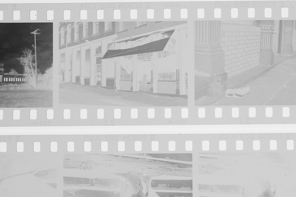

No one has commented on the very faint edge markings on the Acros. Does that have any significance?
Maybe.
It can be an indicator of underdevelopment, but edge printing (which is exposed at the factory) can vary over time.

Thanks so much to everyone who replied! The faint edge markings distracted me from the bigger picture, but now I hope I am back on track.
