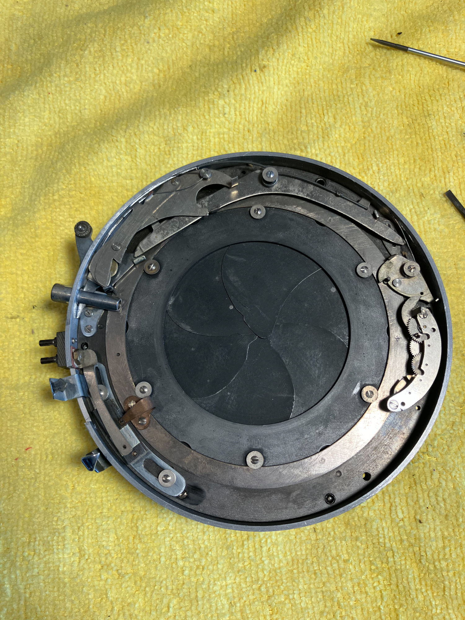

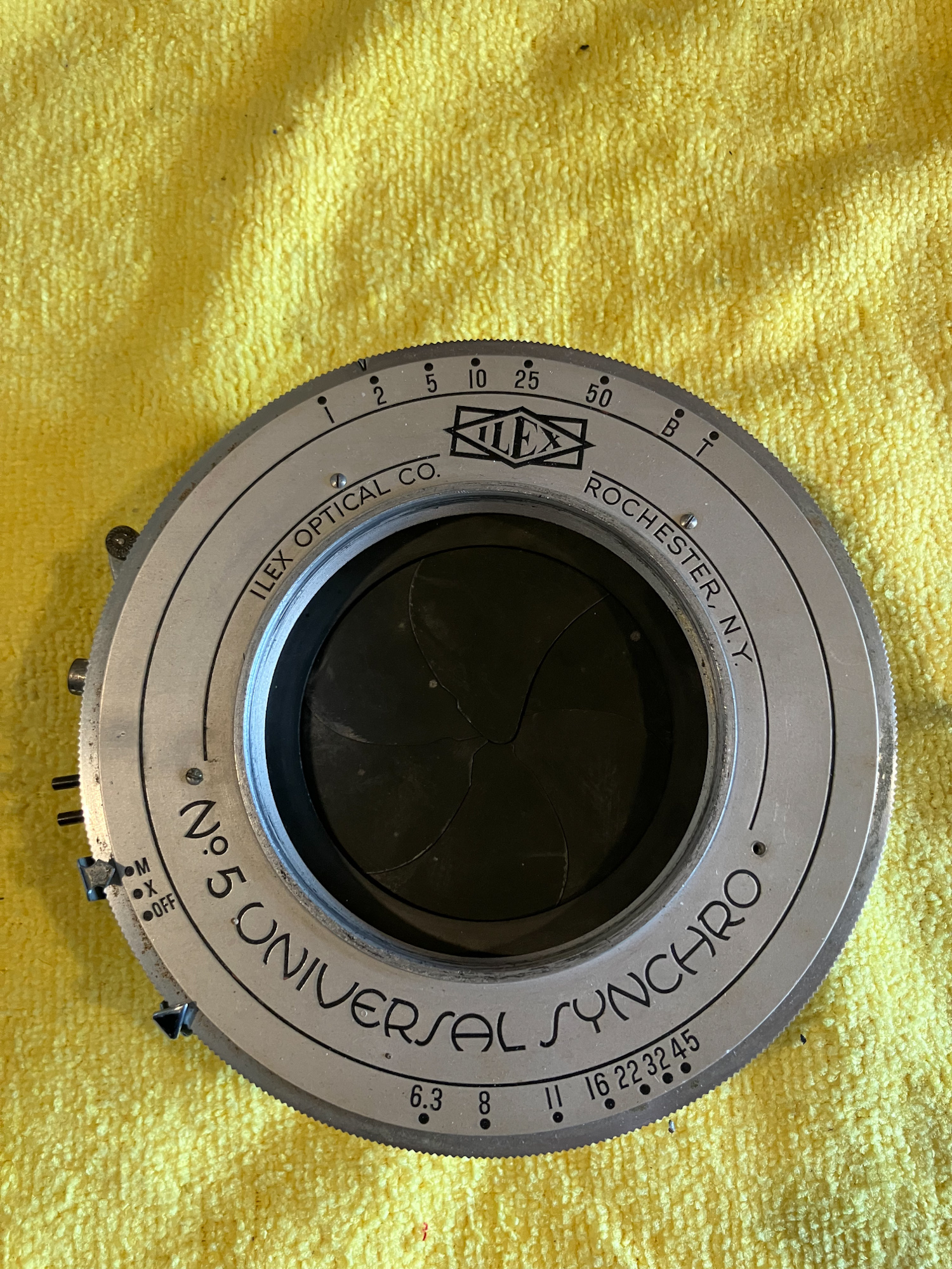

Hi all,
My friend sent me a couple Ilex No. 5 universal synchro shutters that weren’t running to see if I could bring them back to life.
I’ve found a paucity of service documentation online and so with the full knowledge of making a bad decision i plowed forward.
So far so good. These are not complicated shutters, very similar in design to the old compurs. But I’ve found myself a little stumped.
I’ve gotten down to the base plate, lifted out some screws that seemed like they probably held it to the case and expected it to lift out… and it didn’t. It’s not clear to
me if at this point I am doing it wrong or if I should be disassembling the back?
Any and all advice welcome!

Can you post a pic of the back of the shutter? There may be more screws to remove. Then the cocking handle could present a problem, how to remove the plate with the handle still attached.

There’s a lot that can be disassembled from the back. But whether that’s the appropriate strategy depends on how it’s assembled! Some shutters if you open them from the back you end up with a mess of parts and springs that fall out of place.
Agreed about the shutter trigger! The base of the retard gear train appears to be screwed from underneath the main plate. I’m hoping there are hints underneath, which presupposes disassembling from the back … which is why I’m here.

Am I seeing a screwdriver slot at the rear of the knurled knob on the cocking lever? It might screw out, leaving the lever to pull out of the slot in the casing, by lifting the plate up on the opposite side and removing the plate out of the casing.
Yeah the knob should unscrew (haven’t tried but there’s a screw). There’s not enough room to lift it off the post until something else is done though. Possibly like you said lifting the case away.

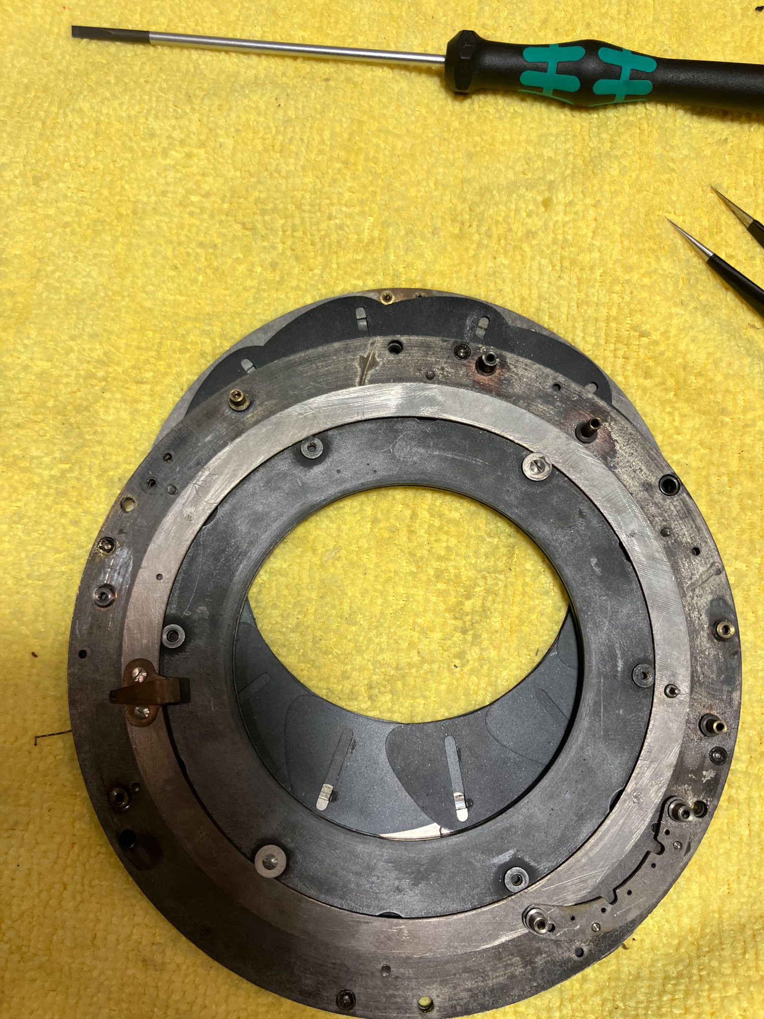

So the trick was from the back. The aperture adjustment ring had a screw to the base plate.
Removing the screw allowed enough play to remove the shutter trigger and the whole plate came out cleanly.
Unfortunately the next set of screws are damaged and I can’t safely remove them without completely stripping them. So that’s as far as this cleaning will go.

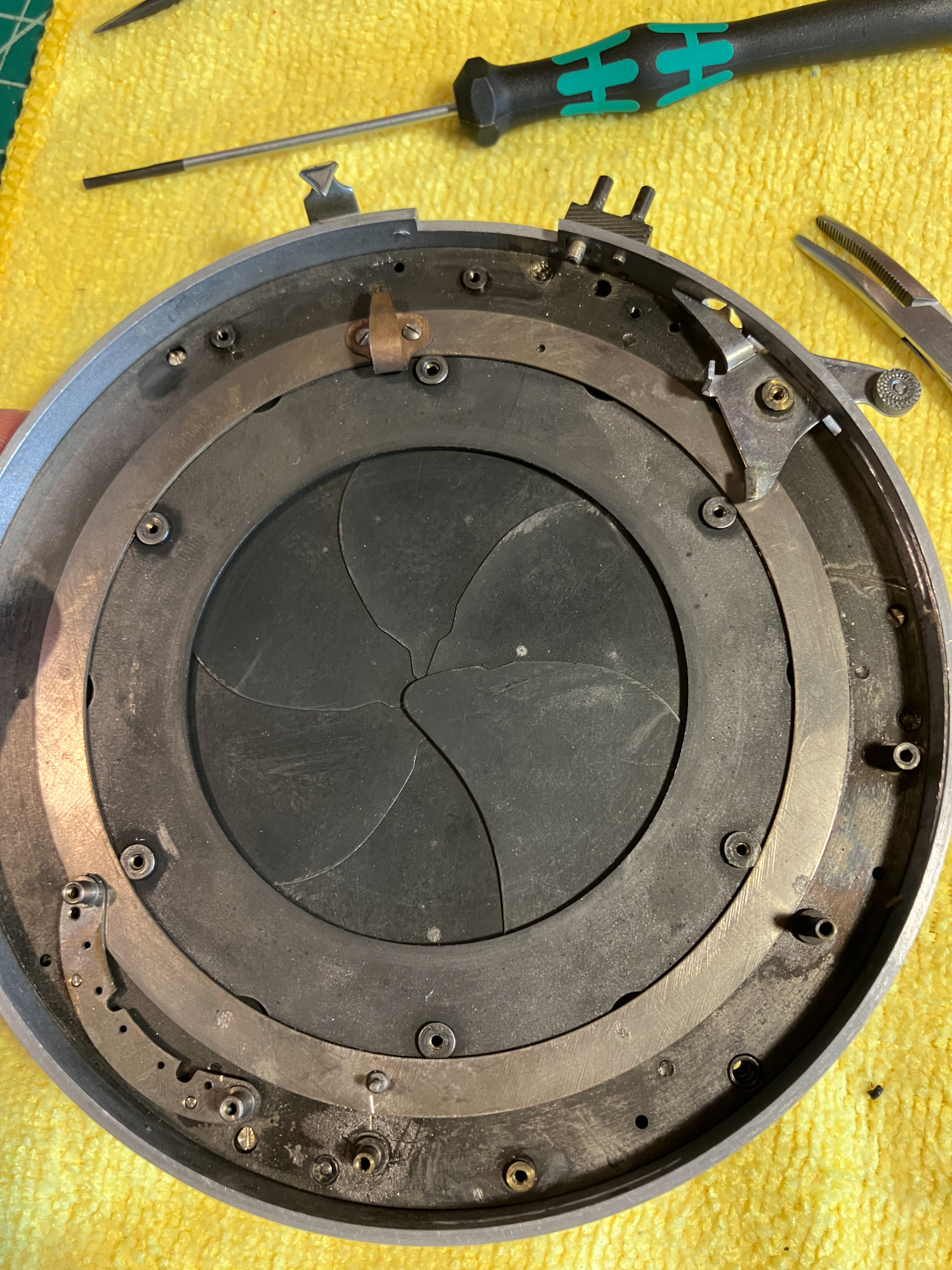

Everything besides the leafs went into the ultrasonic and were reassembled. Really a lovely shutter to work on, very simple but effective.
In the end I agree with @F4U and don’t believe that these were intended to be run dry (other than the aperture and shutter blades). Nothing is hard chrome on chrome, many bushings are brass on brass, etc. I gave all the bushings a touch of light machine oil, and a touch of grease on rubbing parts.
I haven’t measured the speeds yet but the shutter operates smoothly now and is certainly within a stop.
