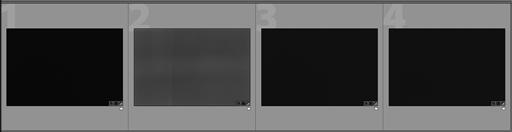

I've recently been experimenting with an experimental black and white film developer that is based off of Patrick Gainer's Rodinal/Ascorbate experiments and have seen a fair amount of postings around the internet about how the developer PH affects how much film base plus fog you'll get with some developer combinations, but not really a visual demonstration posted anywhere. So.... While I was working out an ideal working solution PH for my developer, I thought I'd share what the PH does to the film base plus fog visually speaking. Many old timers probably already know this, but it's useful for the newer/younger guys, or hobbyist home brewers.

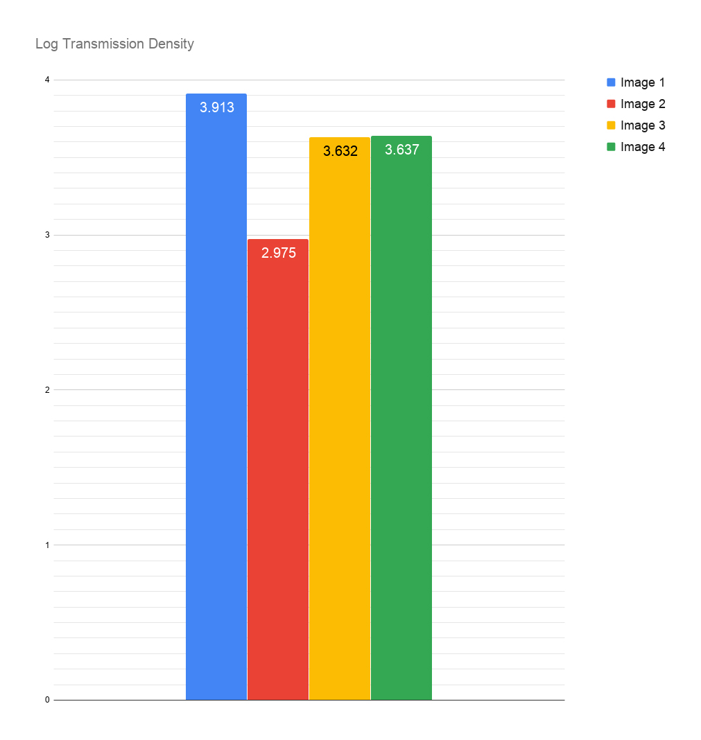

Image 1 is the open film scanner gate with no film. It's black. It should be, and is the black reference for the following frames.
Image 2 is Fomapan 100 processed for 5 minutes at 24C and rotary agitation using the Rodinal/Ascorbate based developer with the working solution PH at ~11.5. The total working solution was 612ml (12ml concentrate, 600ml water). The scanner settings were kept exactly the same, so this is where the film base plus fog is relative to the open gate with no film in it at all.
Image 3 is the same film and processing parameters as Image 2 except: The working solution PH was pulled down to ~10.5. The film base plus fog is higher than the open gate, but it's close enough that I still get a nice strong black. The grain is also reduced quite a lot compared to Image 2.
Image 4 is the same film and processing parameters as Image 3 except: I added 4 grams of iodized salt. The iodized salt contains 67mcg per serving size and each serving size is 1.5 grams, so it has a total of ~178mcg of iodide in the 612ml of solution, plus the salt and sodium bicarbonate filler taking up the rest of the 4 grams. I added the salt before adjusting the PH, so the sodium bicarbonate in the salt didn't effect the final PH of the working solution. The film base plus fog level didn't really change from Image 3, but, the grain is dramatically smaller and tighter than Image 3. This isn't really PH related, but I thought I'd include it because it's interesting. The salt and/or iodide results in much finer grain.
I also did a run where the working solution PH was 9 and ended up with barely there images. I didn't bother including that here as the film base fog didn't appreciably change from image 3 and 4.
So there you have it. This will vary with what developer you're using/mixing up, but for those of us that are mixing our own, it pays to pay attention to the PH of our working solution, and get the PH so that it's just high enough to get things going, but not so high that we get more fog and grain that we want/need.

Especially for newcomers I consider a reversed tonality better to understand, open gate depicted as max. transmission, thus max . brightness.
Adrian Bacon
Adrian Bacon
Oct 18, 2016
2,086
Petaluma, CA.
Possibly, however, in Adobe Lightroom (this is what you’re seeing here), the highlights are completely smashed, meaning 3+ stops of exposure are jammed into the top 10% of the luminance range, so if I show it as a positive scan, it’s actually relatively hard to see the difference unless I introduce a tone curve to pull things down or pull the exposure way down so max transmission is closer to middle grey. At that point, since this is negative film, you might as well show it as it would look in a print.

Image 1 was the open scanner gate with no film in it, so there's no pH, it just represents maximum transmission density to provide some density context to the other images. Image 2 was ~11.5, Images 3 and 4 were both ~10.5 pH.
I've not yet checked for speed differences or worked out a development time to get roughly zone system contrast. Those are next on the list.

If you scan an open frame, density should be very close to 0.00, not some number > 3 .... also frames with some b+f should have higher densities, not lower ones.
Adrian Bacon
Adrian Bacon
Oct 18, 2016
2,086
Petaluma, CA.
It's positive transmission density before you invert it. If you want to invert it, then, relative to Log 4.0 (which once inverted would be Log 0.0), Image 1 would be Log 0.087, Image 2 would be Log 1.025, Image 3 would be Log 0.368, and Image 4 would be 0.363.

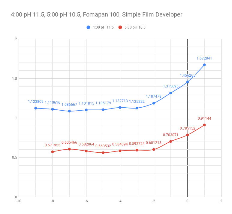

Yesterday I exposed two rolls with my standard setup for testing contrast and speed, and processed one at pH 11.5 for 4 minutes, and one at pH 10.5 for 5 minutes. I haven’t measured them yet, so don’t know what the contrast is, but both descend into film base plus fog by the time you hit 5 stops down from middle Gray. I can see 4 stops down, but not 5 stops down, so if there’s a speed difference, it’s probably less than a stop. I think I might have to do another run with a shorter time for the pH 11.5 as the normal middle gray still looks a little heavy, but that just might be the heavy fog messing with me. The 10.5 pH looks like 5-6 minutes is about right. We’ll see once I measure it and make a chart.
Adrian Bacon
Adrian Bacon
Oct 18, 2016
2,086
Petaluma, CA.
Here's the raw density readings. The scale on the left is log density, the scale on the bottom is relative exposure values. The 0 mark is a correctly exposed gray card at EI 100. The film used is Fomapan 100. I did not normalize the readings so that the film base plus fog is log 0.0 in order to show the fog level differences. The data labels at each point are the raw density readings for each point.
As I suspected, the pH 10.5 needs another ~30 seconds, the pH 11.5 needs to be pulled in, I'll probably try 3:15, as that's the shortest I'm willing to go. Fomapan films tend to be very sensitive to Ascorbate, so 30 second changes usually result in pretty big differences.
The pH 11.5 has a +1 to 0 EV gamma of 0.72, the pH 10.5 +1 to 0 EV gamma is 0.42

Adrian, I am confused by densities near 1 and 0.5, have you also not subtracted the open gate reading?
Adrian Bacon
Adrian Bacon
Oct 18, 2016
2,086
Petaluma, CA.
The open gate reading has not been subtracted. 0.0 on the chart is log 4.2 inverted, the open gate reading once inverted is ~0.3 log.
