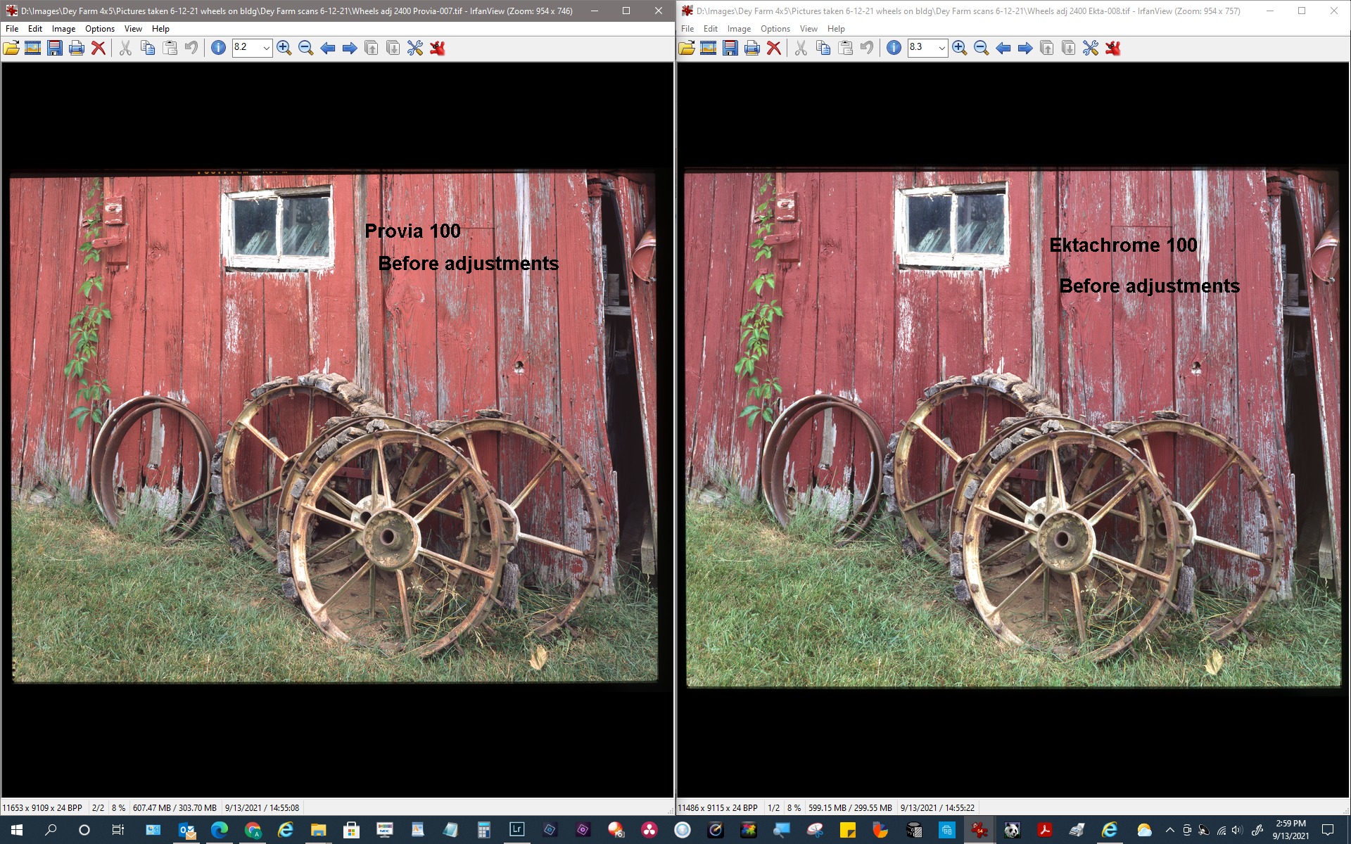

Provia has more orangey reds compared to Ektachrome' s redder reds and greener greens.
