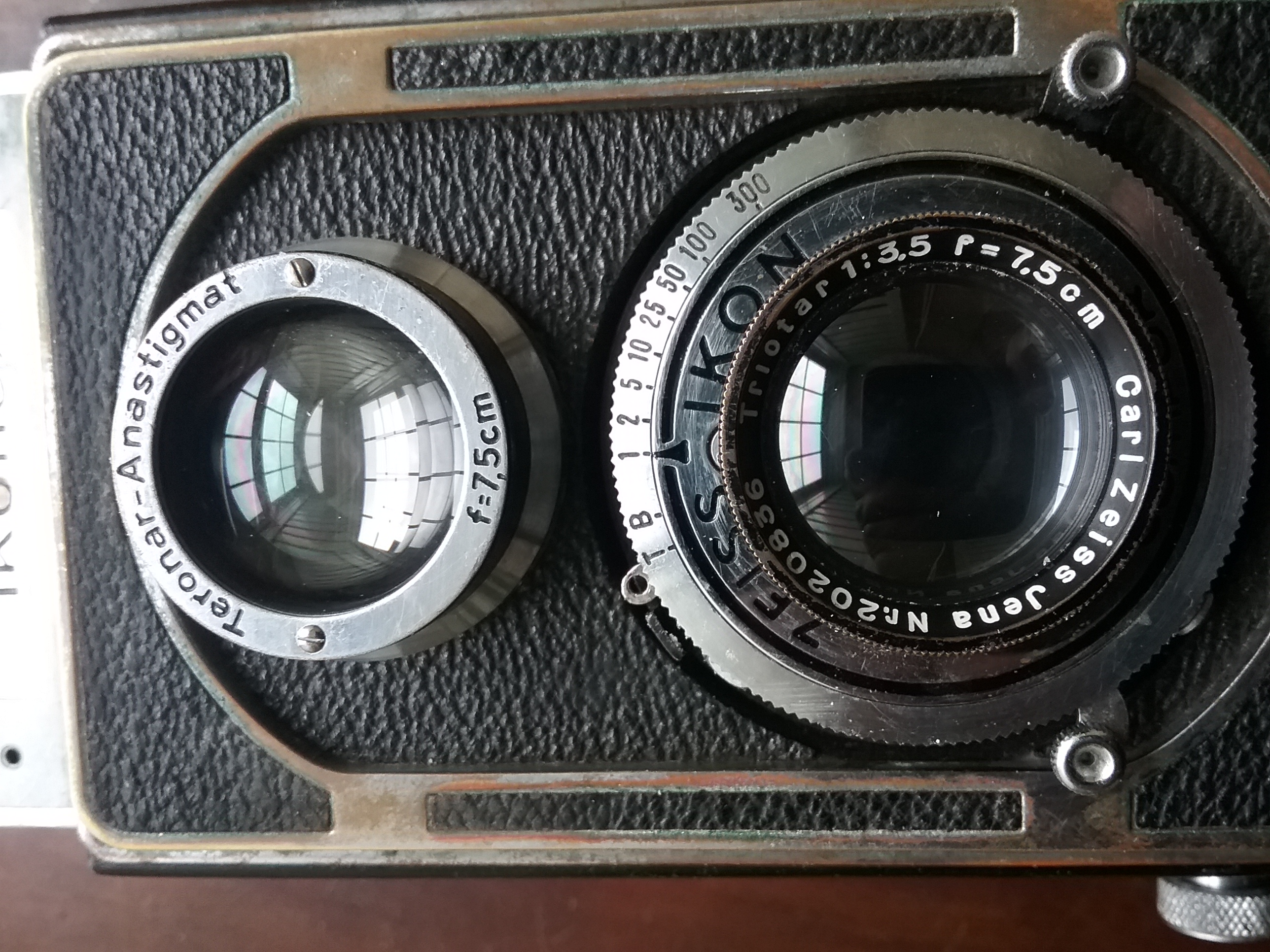

I have an IKOFLEX that serial numbers indicate a 1929 manufacture date. Lens serial number 2020836 TRIOTAR 75mm f 1:3.5 ,shutter 1252028.It has a lever focus. In googling information it is described as an IKOFLEX ll however the date given is 1936 onward.What do I have?

Sorry guys I misread the numbers,however I have another question. Both lenses appear coated,did ZEISS coat lenses back then?
No, they weren't coated back then. But after the war it was possible to have old lenses coated. I had a 1938 Rolleicord that had its Triotar lens coated after the war and the camera also had a flash contact installed.
It might also be that the lens has "bloom", caused by oxidation. Can you post pictures of the camera and lenses?

That's bloom, that sort of purplish rainbow oil slick look. Not sure what difference it makes, but I love the look of it. I have a couple of Tessars with that and they are great shooters. I'm not saying the bloom does anything.... well, I have another without any bloom and it shoots fine, also.

It doesn't appear to me that either of the lenses are "coated" though both seem to have the "natural" coating mentioned above. It was this "natural" coating and its advantages, that gave the lens manufacturers the idea of coating, later. Don't try to remove it.........Regards!

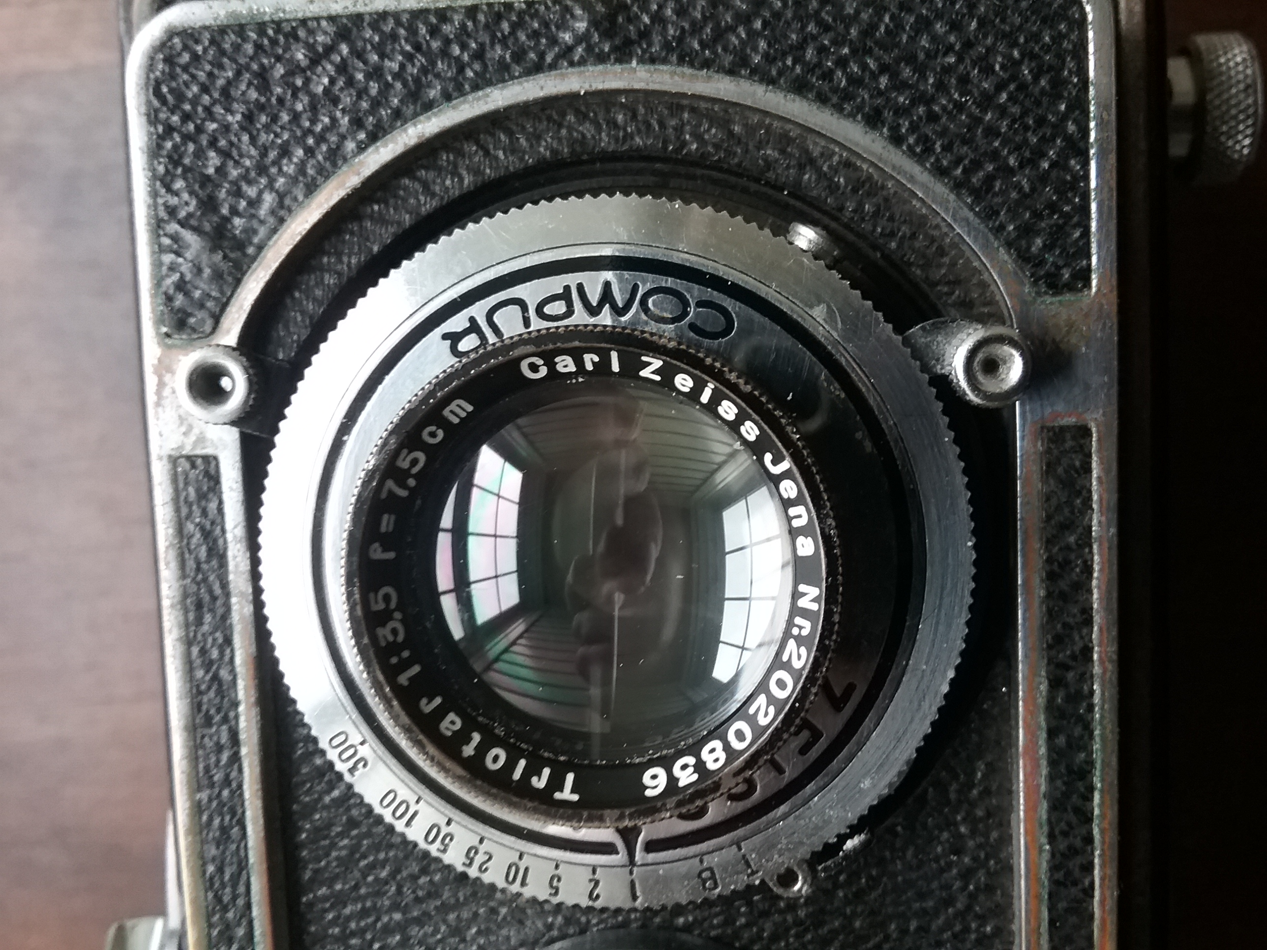

Yes, that's a very nice bloom. Natural oxidation on the surface of the glass that works like a mild antireflection coating. The Triotar is one of the best three element lenses.
The shutter is a Compur instead of Compur-Rapid, so the camera model is Ikoflex II, 851/16 Ik.

Thanks to all. I had never heard of bloom.The iridescence had me baffled,it appeared to be some sort of coating.Is bloom the result of metals in the glass?

It's one of the mysteries that have been discussed, but I have yet to hear the exact chemistry behind the bloom. It must have something to do with the composition of the glass and the atmosphere. I have seen Triotars with bloom but I can't remember seeing a Tessar with it. The Triotars I have with bloom all have very good contrast.
