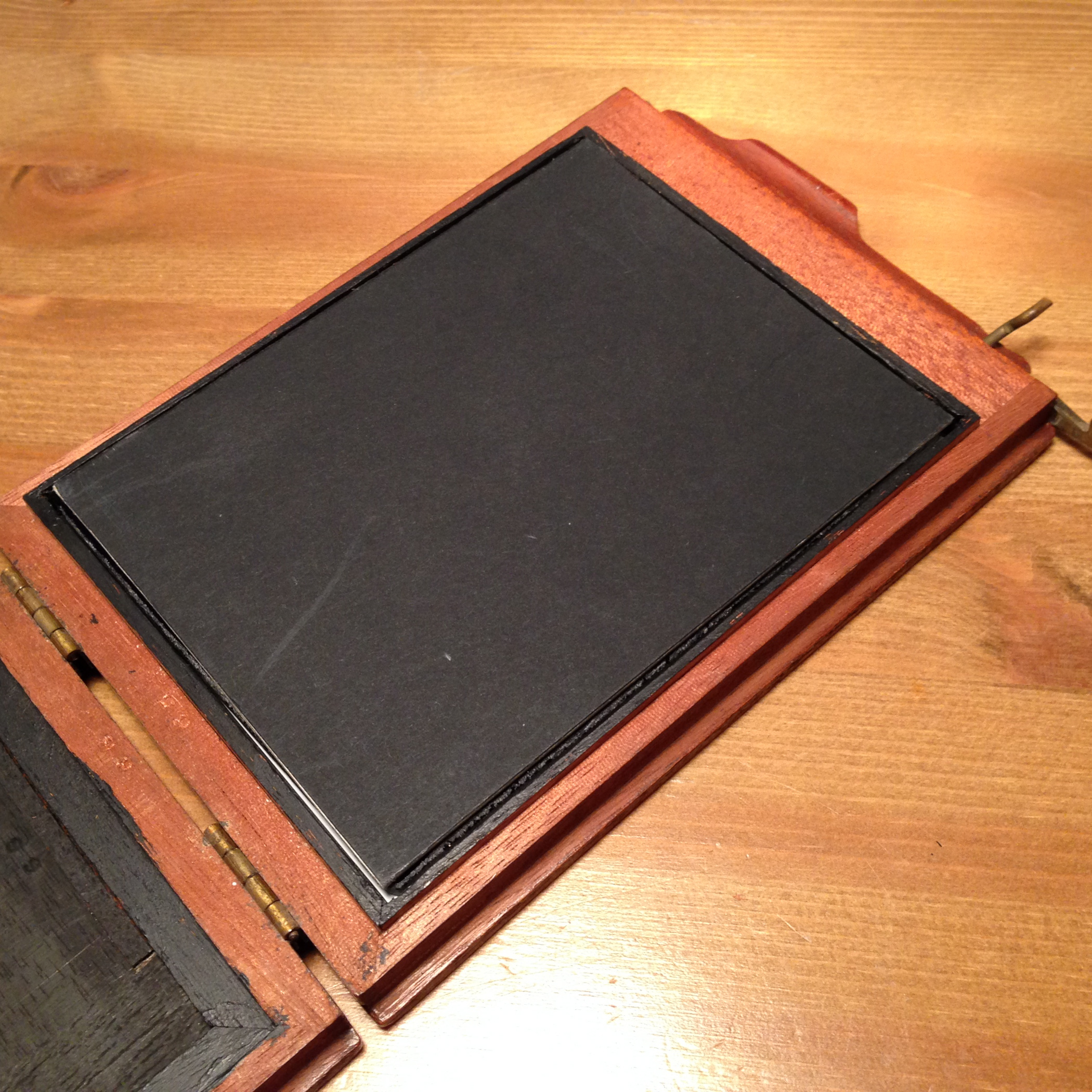

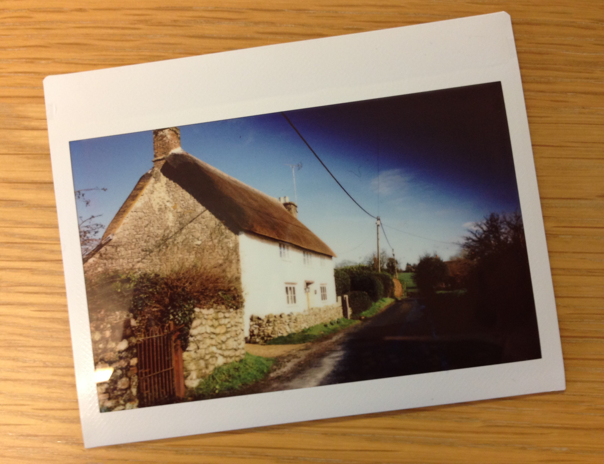

I threw down the Instax Wide photo of a cottage on to the desk and it landed next to a paper negative cut for my 1/4-plate camera. The sizes were almost identical.
So, it occurred to me that I could use my 1896 Underwood 1/4-plate camera with it's DDS with Instax Wide film... it works well on one side, but the other side is just a little too small to fit the Instax into. Still, I think it might try it out this weekend :smile:

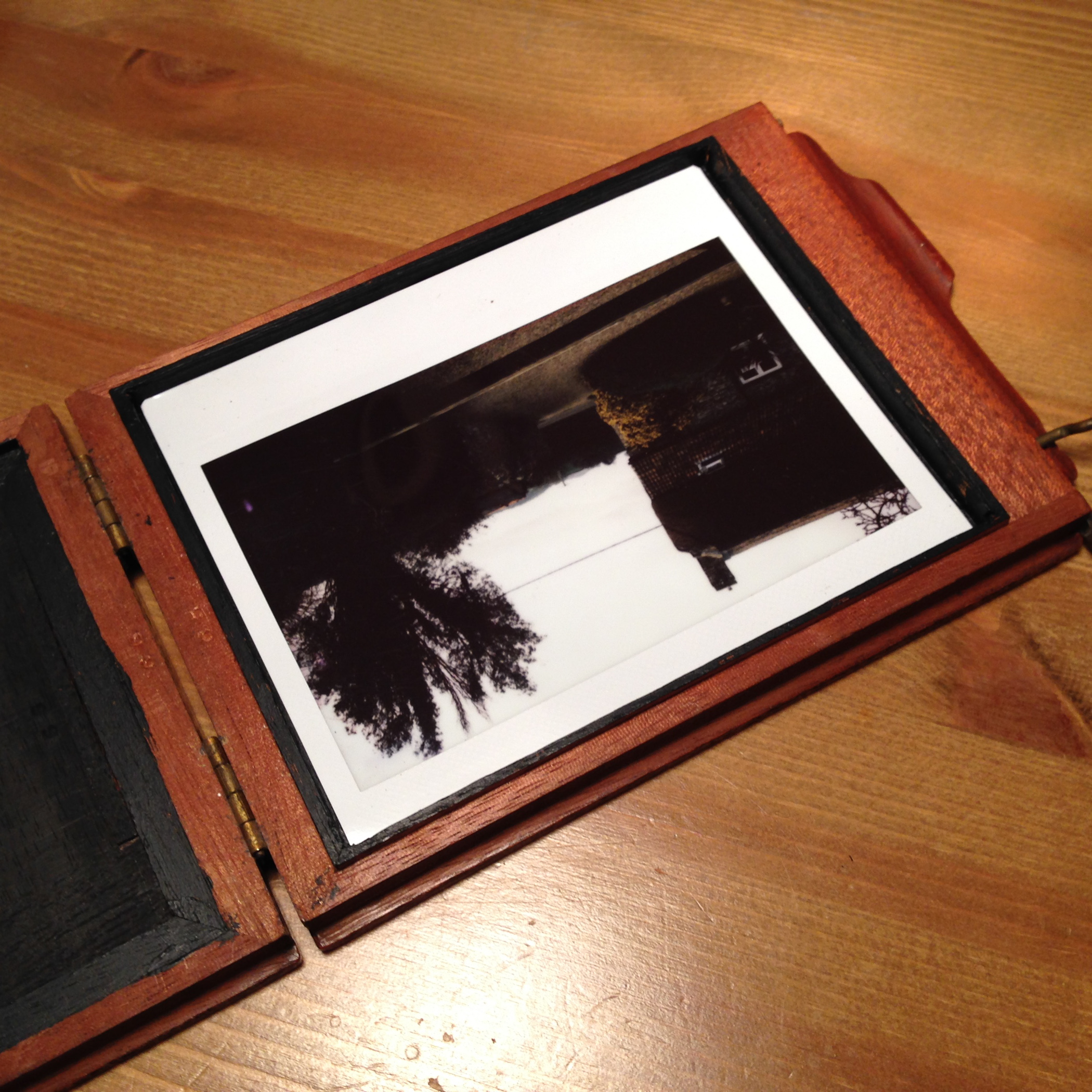

Here's an Instax wide photo in the 1/4-plate DDS...

I put Instax wide in a Polaroid 100 holder and used that in an RB67 with the Polaroid back. I think you have to expose at iso600. Unlike Polaroid integrated film, you expose Instax through the back - so you would have it in the holder pictured above black-side facing out. Not that you'd notice that loading a sheet in the dark.

@Don Heisz - agree with you on wishing Fuji would make a better camera for their Instax wide film - even just a decent lens would be good. But then again, with Instax resolving 10lp/mm does it matter the lens is plastic?
As for exposing through the back - that's how I've shown in it the picture :smile:
Ah - that's a reflection. I thought it was a moody low-light photo...

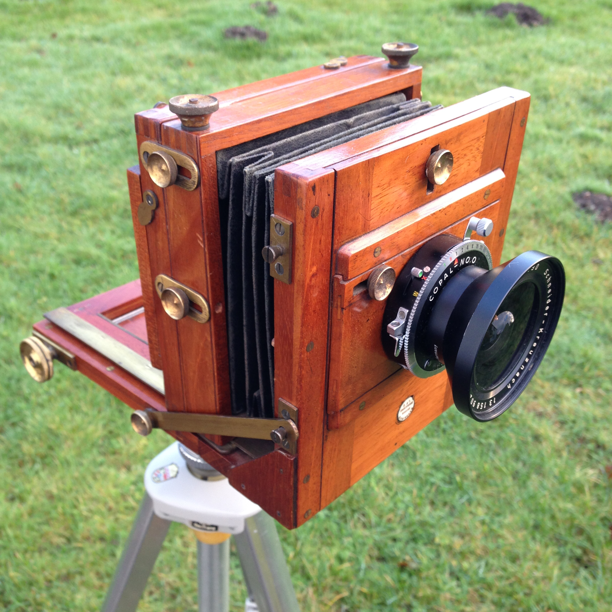

Last night I changed the lens on the 1/4-plate camera (it was the original and had no shutter) with my 90mm Super Angulon. The Copal 0 shutter fits a treat and I can still remount the original one. I've also loaded up the two DDS with an Instax sheet each and hope to try it out tomorrow morning (weather depending).
Anyway, here's my 'new' Instax camera...

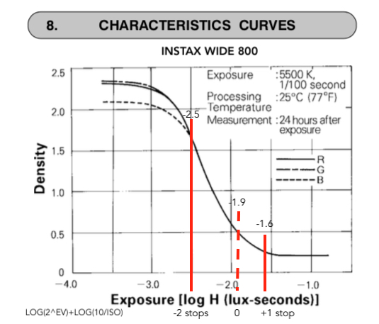

I found the characteristic curve for Instax film - I'd put the latitude at about +1 stop, -2 stops (maybe -2.4 stops if you're lucky). Anyway, here's the curve and my reckoning...

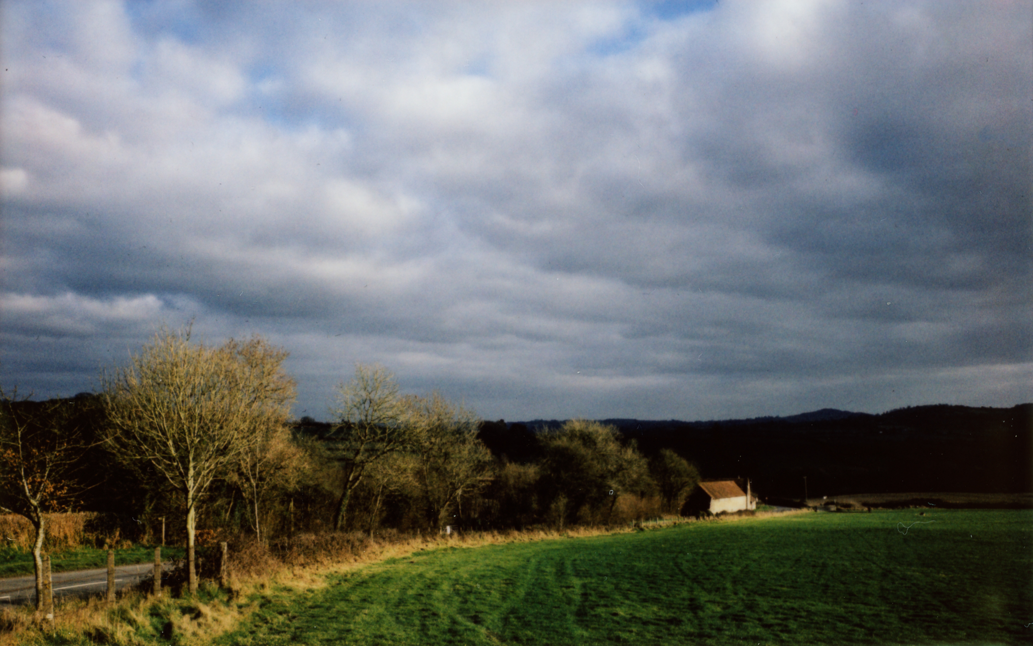

I took the camera + Instax out again this afternoon and using the information from the characteristic curve, set about to retain as much detail as possible. With sunny clouds, I had to wait until the right moment to take a couple of measurements (sky at 1/60 @ f45) and then set the shutter speed to 1/30th (at a fraction over f45). Happy that the shadow areas would be okay in this instance, this was the result...
I was very happy with the result, the actual Instax print looks sharp and the colours are great (better than this web version!). It definitely seems that limiting the dynamic range to around 3 stops is going to be key, as is choosing the right light to make the images pop.

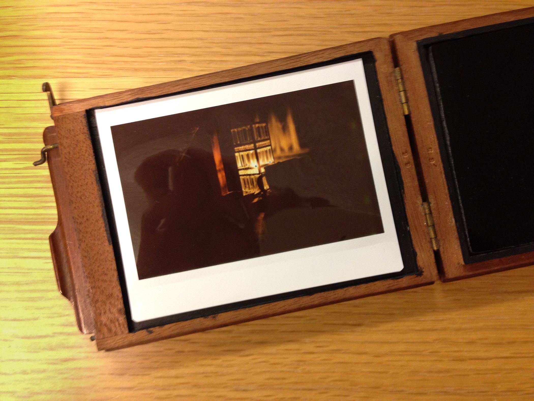

I figured I would try a portraiture test shot using the Instax Wide in the 1/4-plate camera to see how it reacted to my flash (Profoto Acute B600 with beauty dish). Not only that but I had lightly modified the bookform DDS so that it could hold two sheets of Instax and I wanted to make sure that was okay too.
For me, it shows that Instax film is capable of some great looking images and I might just have to try taking some proper portrait images!

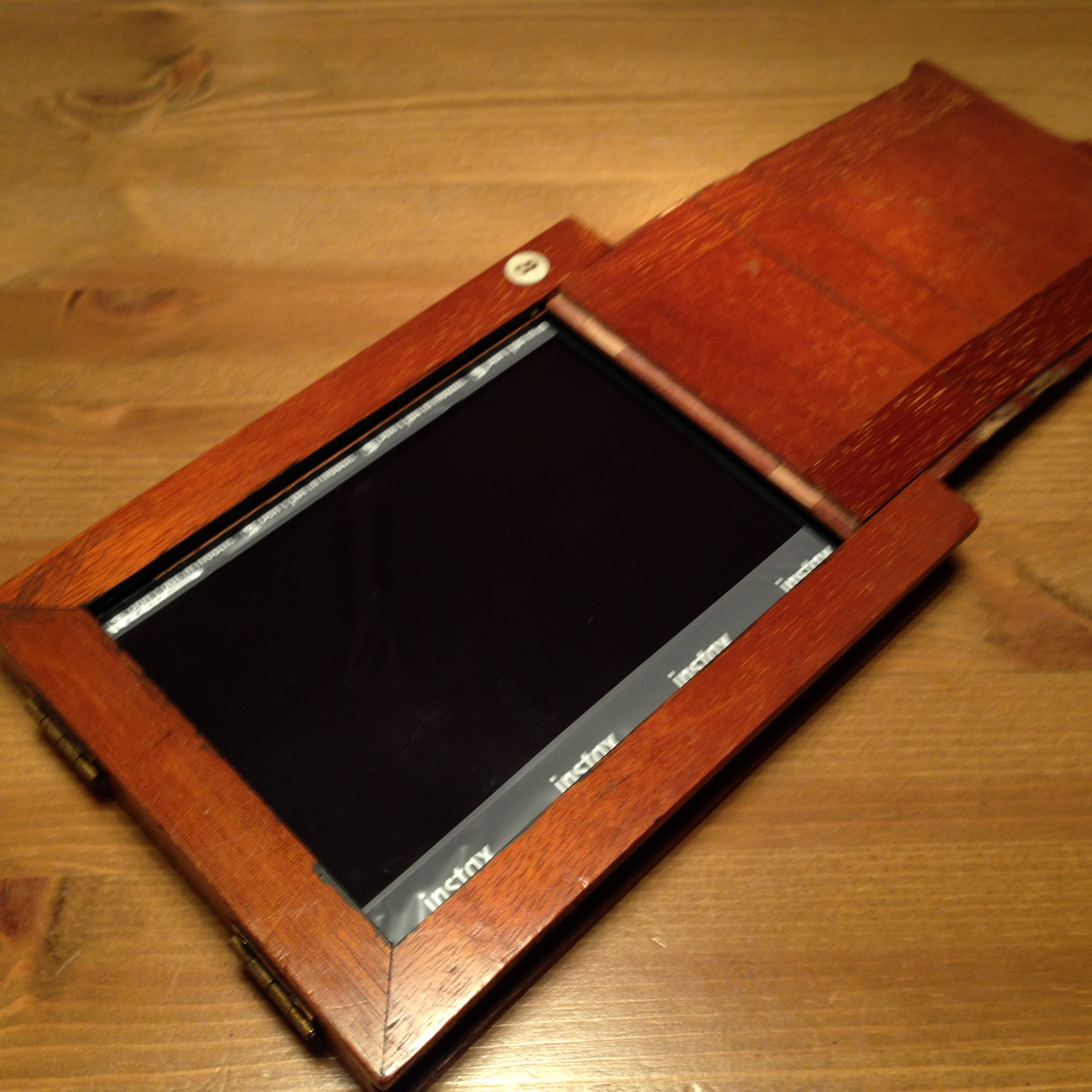

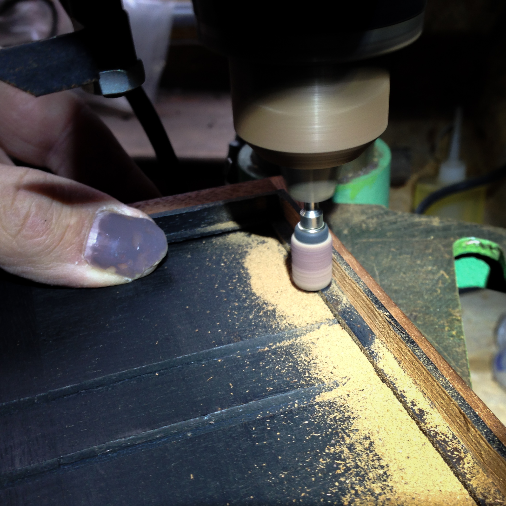

Quick update: in order to fit two sheets of Instax Wide film into the bookform holder, I did have to very carefully widen the space to fit in the sheet. There really wan't a lot of room for errors here as the wood that I was reducing thickness was barely a couple of mm anyway.

Which brings us on to how to use it... the following is done in a changing bag.
Step 1: remove a sheet of Instax from its original holder. Make a note of which way round it is (although you can't see it at this stage, the dark side is the lens side and the thicker piece that holds the chemicals needs to be uppermost).
Step 2: open the bookform holder and (thinking about how it slides into the camera) insert the sheet...
vickersdc
vickersdc
Jan 8, 2007
454
Somerset, UK.
Step 4: place the second sheet on top of the spacers (dark side uppermost) and chemical pod towards you this time (i.e. opposite way to last time)...
vickersdc
vickersdc
Jan 8, 2007
454
Somerset, UK.
Step 5: final step... close the bookform holder. I've opened the darkslide here so that you can see how the Instax film is showing...
