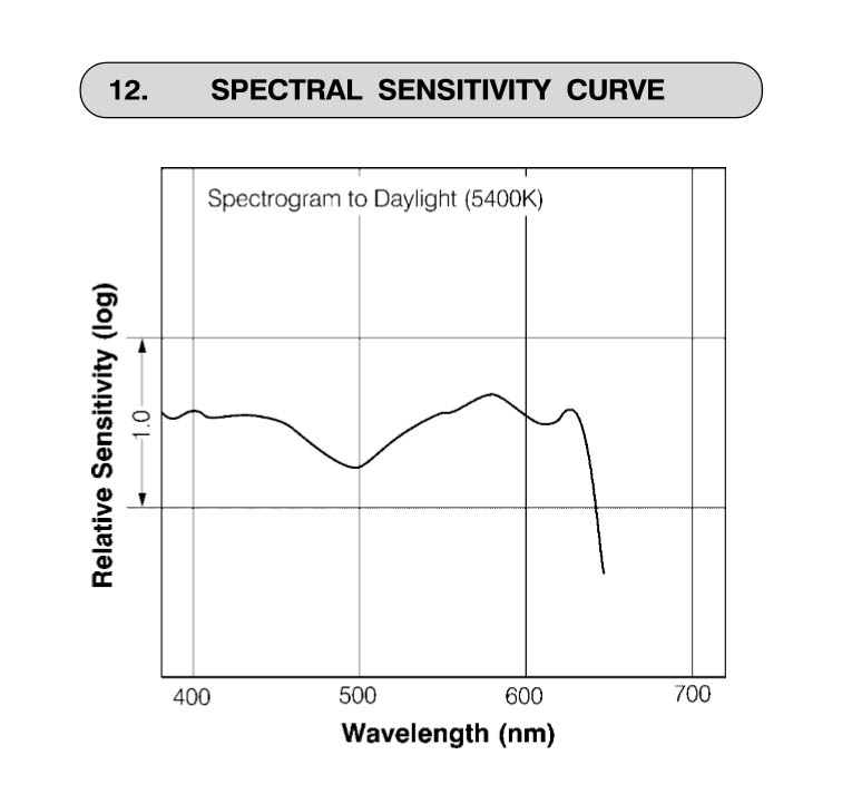

Is their a spectral graph for the film of either version? How far into the red does it go? Efke 25 was orthopanchromatic, but its sensitivity only went to 610. Wondering where Acros sits there?

Found it. Its a bit higher then Efke 25.

Im trying to find a good replacement for Efke 25. Adox CHS II 100 is a beautiful film, but is grainier. I love the scans I've seen from Acros 100 so far. It might be my go to medium speed film, which is also replacing Plus X. Though Plus X is closer to Adox 100 in grain size then Acros 100.
