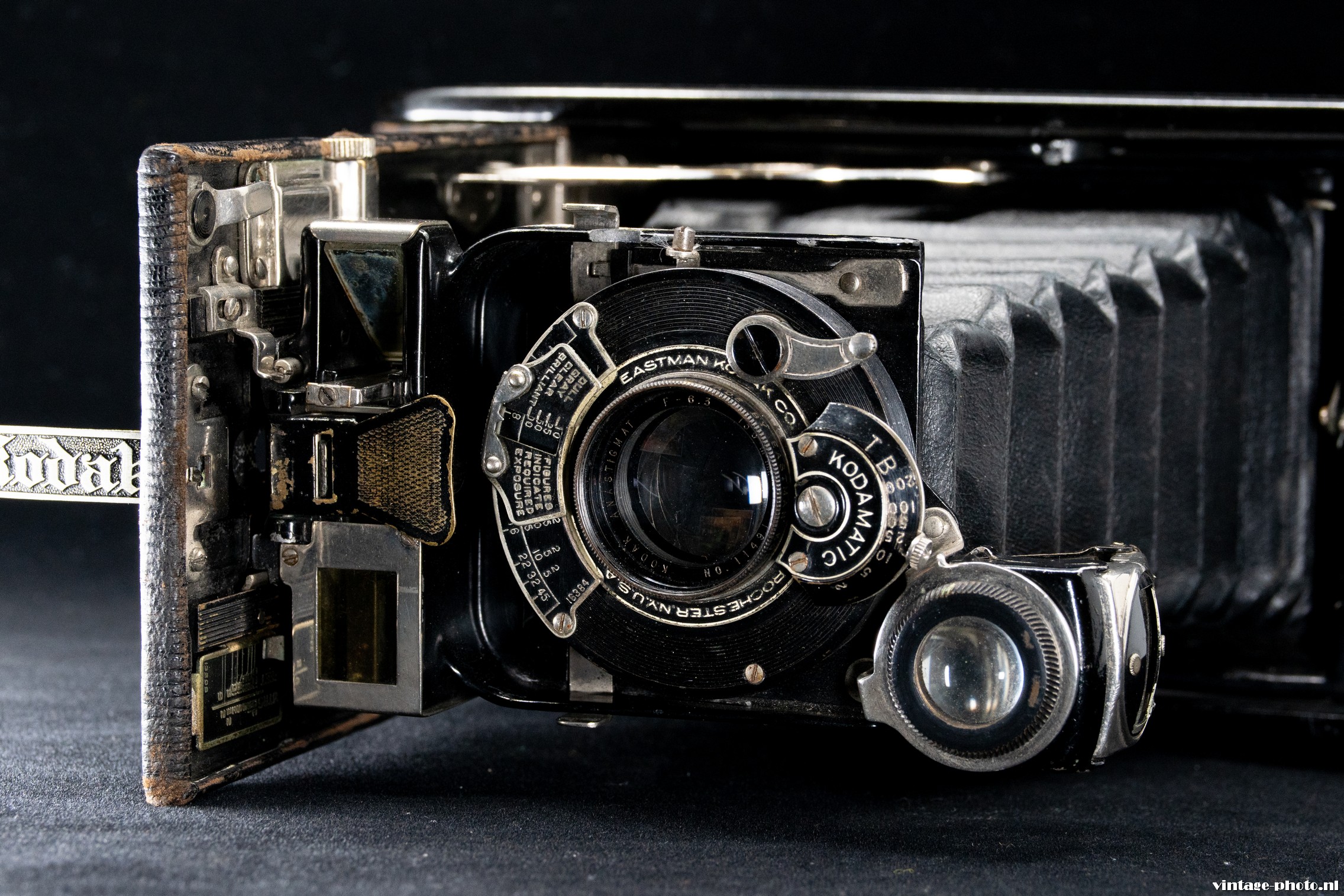

I just had the good fortune to find an Autographic 3A Special, with the B&L Tessar lens (and the rangefinder!).
There is a slight amount of fugus on the very front element, and I want to clean it.
By the way, proper cleaning solution?
Any special caution I need to observe in removing the front element, like finding a spacer, or having to watch the thread start to reassemble properly?
Other: Am I crazy in thinking a dry plate could fit in the (regular back) film chamber..?

I’d love to see a picture of your camera. I was totally unaware that 3A has a rangefinder. Sure wish mine did. Please teach me something I didn’t know!

@BrianShaw it almost looks identical to this one:
I must say, it is fun to play with a 100-year old rangefinder!

Hydrogen peroxide at 3 - 4 % from the haircare section of the supermarket. At this concentration it is safe to use without PPE precautions. You can use it as an antiseptic on cuts if needed. Some people like to use this in combination with ammonia as well. Try the peroxide on its own at first.
For lens cleaning I place a piece of soft cloth in a shallow saucer and then place the lens element on the cloth. Pour enough peroxide to cover the lens and leave it for a couple of minutes. Remove lens element and dry off with a microfibre cloth. If necessary use your regular lens cleaning regime at this point although I have found that the peroxide leaves the lens pretty clean.

Nice camera. That's unit focusing, so no worries about unscrewing the front element and cleaning it. Ammonia or hydrogen will peroxide do the job.
