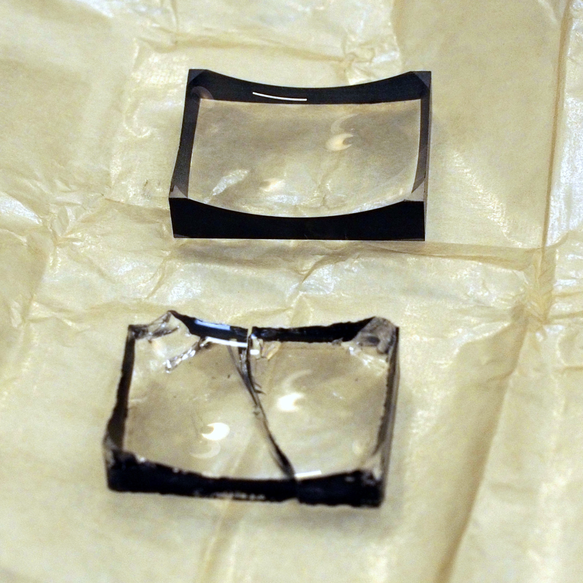

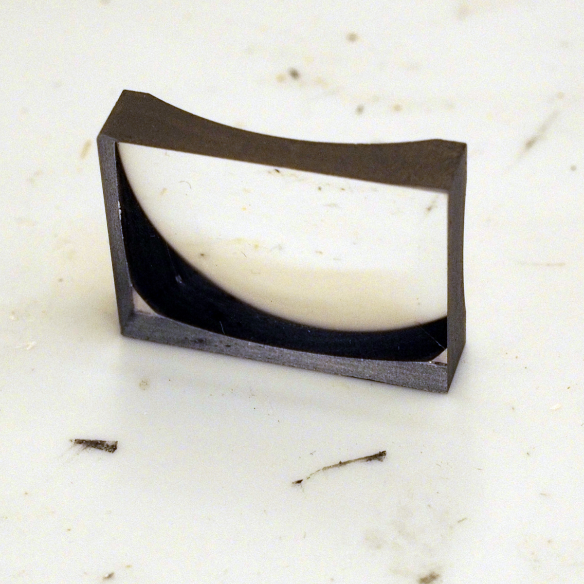

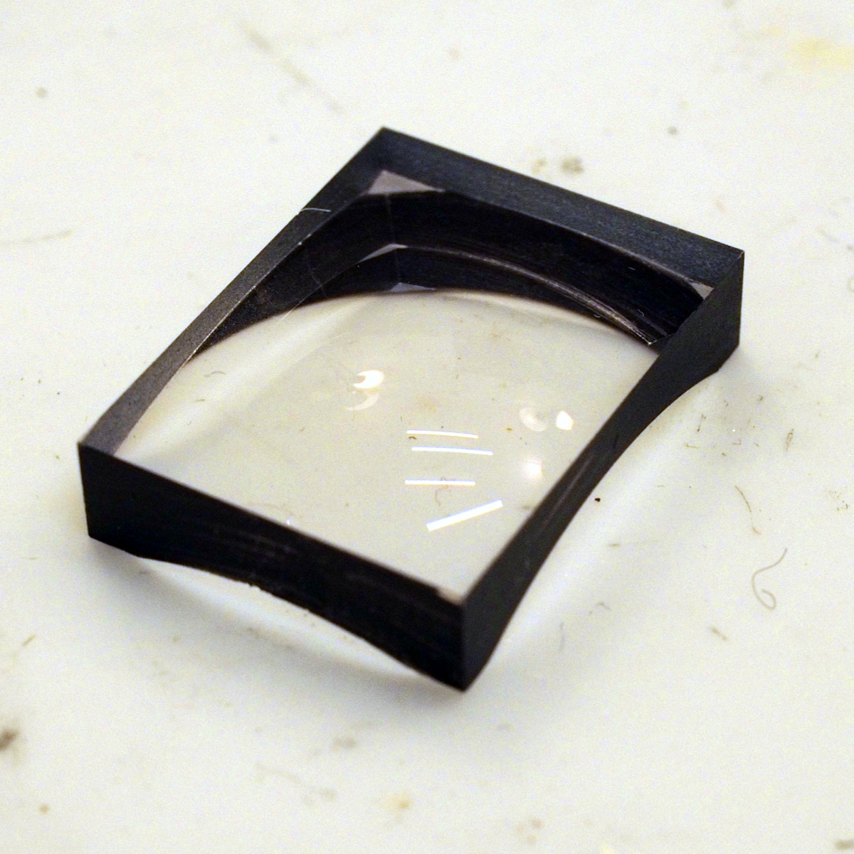

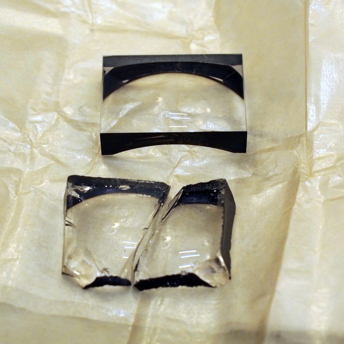

This is a recently manufactured replacement for the large center front viewfinder glass on a Kodak Medalist camera (same for 'I' and II versions of the Medalist).
This viewfinder is very prone to cracking, chipping, shattering. Because I work on a lot of Medalists, I've had some spares from parts cameras, etc. But they have become very rare, and I often can only cement cleanly broken parts to get something usable.
This part was developed by Jason Lane, who many here know from his work with dry plates and other photographic things https://www.pictoriographica.com/ He's an optical engineer. He derived the formula and such and arranged for manufacturing in China. We added anti-reflective coating, not part of the original viewfinder.
If you have a cracked viewfinder, or worry about yours cracking, well, here you go.
If you wonder about this as an upgrade for an uncracked viewfinder... I was curious if the new part was visibly better than the original in use. All in all I would say, 'Yeah, maybe, but not a real significant difference.' A little internal reflection reduction, a little more contrast which might mean a little sharper. Maybe... maybe I just want to see it as better, maybe my eyes aren't the best and someone else would find real differences. All in all I wouldn't recommend this as an 'upgrade' item, Maybe wait for more people to use them?
Installing: remove top cover. Walk the viewfinder frame out pushing from the back on the top and bottom tabs alternately. No need to bend tabs. Go slow, just wiggle it forward. When out, on the inside top of the frame is a small piece of metal. Pull this out, note orientation. Remove glass. Drop in new glass. Replace metal piece on top. Replace frame- put one tab slightly in, tilt second tab in, a little pressure to bend the tabs to let the second one slide in, Push home.
$50, including US shipping.
