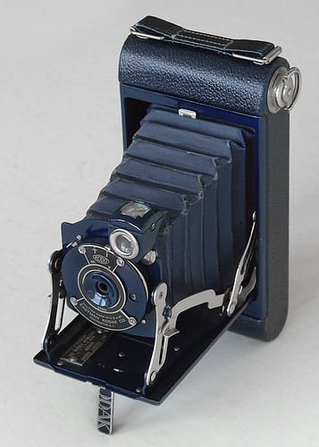

I might have to give it a go, just for the sake of curiosity. 😁
I'm curious too. It'd be fun to do a complete "olden days" shoot using a 120 folding camera from that era, some Foma ortho film and this 88 year old (or, older!) developer formula. I wonder if the 'look' of that era would be re-created. Hmm.

Thanks, Donald.
Curious, did you ever run Foma Ortho through that Kodak folder? It's funny this thread popped back up since I just went through a job of setting infinity focus on my old Kodak Special No.1 Autographic. I have a roll of Foma Ortho 400 ready for a walk if the weather permits tomorrow.
I haven't, yet.
