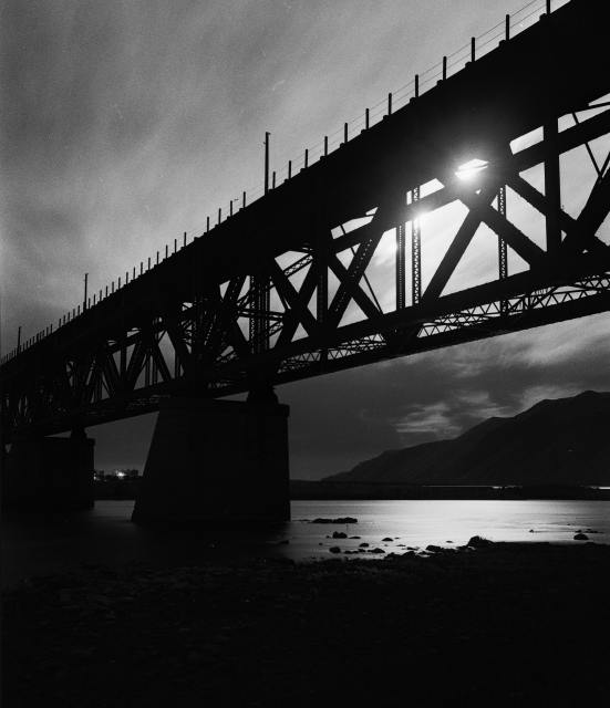

I used it with no success a few times, then finally learned how to use it to get what I wanted, and no sooner had I done so, it disappeared.
I wish they'd still make something like that. The new "3200" films are great, but those old ones were very juicy.

Bowz -- that is SO cool

I had a brick of it here in the freezer that I gave away last year. I was not happy with the results. I like your result very much. I used D-76 and HC110B on mine.

Thanks, guys.
The film was processed in pyro-acetone (I also processed it in Windisch pyrocatechin, sometimes with a sodium carbonate standing bath following the developer when the brightness range was astronomical)... Of course, the pyro-acetone reduced the filmspeed to something like 400, but since I rarely use tri x at anything like 400, a 400 film is still high speed for me. It is very tough to get decent shadow detail in the moonlight anyway, and - I may be wrong - but it seems to me that the peculiar characteristics of this film worked exceptionally well to preserve much more than I really deserved to get. In this instance the reciprocity failure compensation was beastly; it allowed for the transit of the moon, which fortuitously followed the structure of the old trestle.
