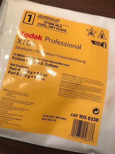

There have been other threads with people (like me) reporting quite obvious Xtol problems so it's good to see Kodak acknowledging it. I had one of the bad batches from last year (the new packaging problem). Kodak replaced my defective product with... well you can see for yourself. I've already switched developers but hate to see this happening.
